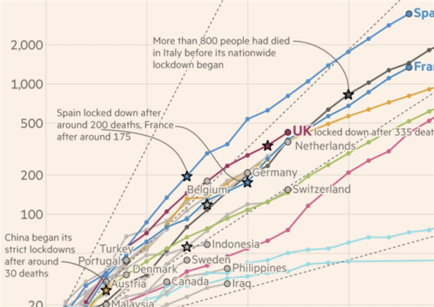

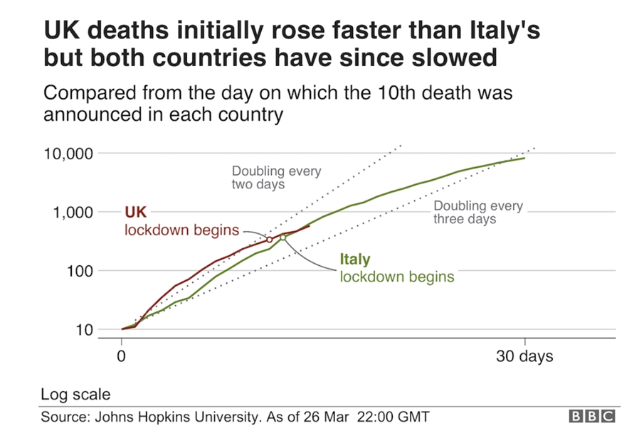

Looking at (say) charts in the Financial Times, it is easy to further fool oneself that the trend for your country is pretty much the same as any other country.
Image snippet: ft.com, fair use to explain the problem with their chart..image
Looking closer, it becomes clear that the chart vertical axis is actually logarithmic. Mathematically it may be understandable, but log charts are not understood by everyone. Is the chart deliberately intended to confuse? I think it is – it’s just a personal opinion of course. But what I do know, is when a non-log chart was shown to a sample of friends, they were astonished at what they saw.

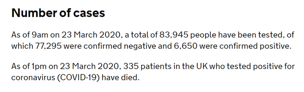

You’d think that perhaps the official government websites could be helpful here, but that’s not true. The UK government website merely displays a few numbers presenting a static view. That’s extremely useless for anyone who wishes to see what trajectory the country is on. The 'number of cases' in no way represents the real situation either, since the quantity of testing is low.

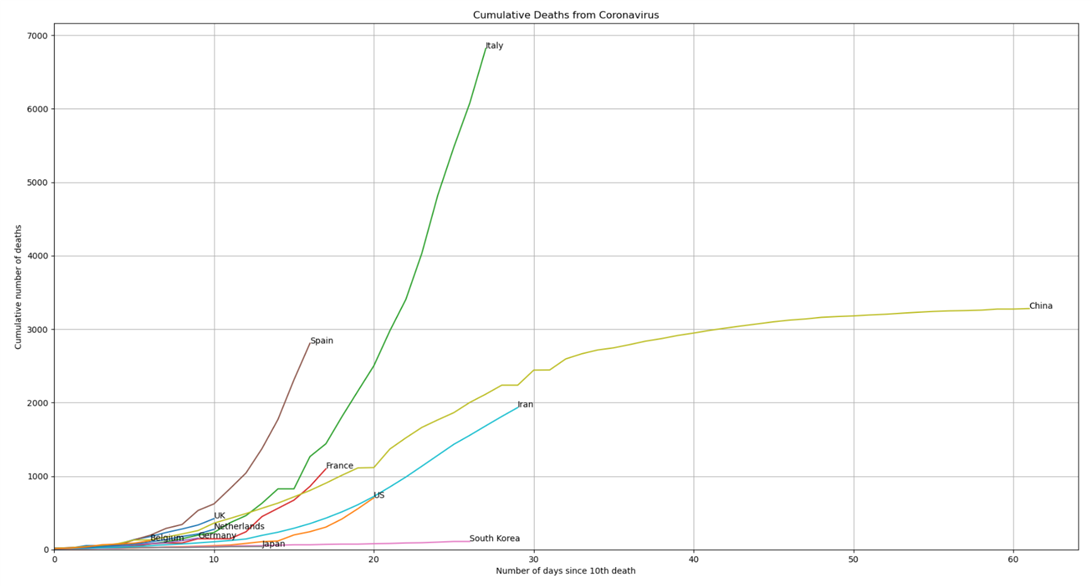

Here’s what the situation really looks like, as of 24th March 2020, for a few countries. This is actual deaths over time, it is not some prediction based on a low volume of testing, and it is on an clear unambiguous scale. On the chart, the starting point per country, and precisely what countries are plotted, is down to us.
The result is frightening.

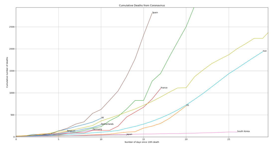

Zooming in closer, we can now see the exceptionally mediocre state certain countries are in, and the direct consequences of poor and deliberate government decisions and the squandered time. No wonder the newspapers and the government didn’t want it to be easily visible.

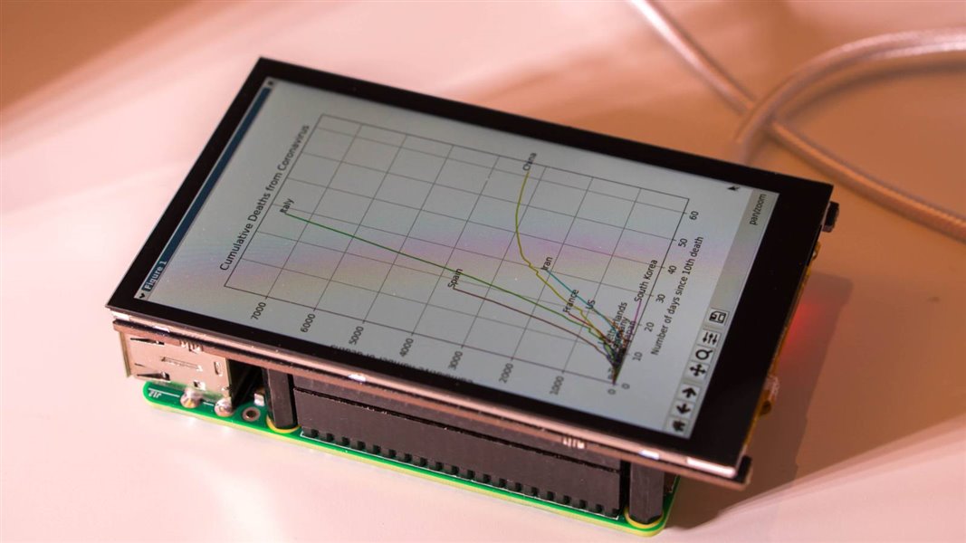

This project aims to chart the deaths from coronavirus independently from the newspaper charts, and allow navigation through pan and zoom. This project has been tested on a laptop running Linux, and on a Raspberry Pi. The reason to use the Pi is to convert it into a standard ‘kiosk-like’ device with a permanently attached touchscreen for all interactivity. At power-on the Pi will automatically fetch the latest data and chart it onto the screen, ready for navigation. No physical keyboard or mouse is used.

Kiosk Mode
If you have a screen to attach to a Pi (either via the HDMI connector, or a plug-on display such as the Pi Capacitive Display or any of the various plug-on displays, then the Pi can be set up so that it automatically does just one task – display the chart. This is ideal if you wish to permanently dedicate a Pi and display for this purpose – perhaps as an information board with future enhancements.
To convert the Pi to work as a standalone kiosk-type appliance, follow the steps here: Home Automation in the UK Simplified, Part 2: Raspberry Pi and Touch Display
in the section titled Building a ‘kiosk mode’ for the Pi and Display. Ignore the initial steps related to Node-RED.
Incidentally, in the file called midori_start.sh, you can replace the text http://127.0.0.1:1880/ui with a news URL such as (say) http://www.bbc.co.uk/news if you wanted your kiosk mode device to permanently display the news. For this project, the Pi will display a chart instead.

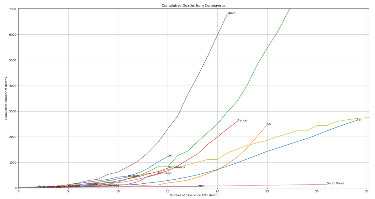

    Today's chart (the data source is refreshed at midnight, so this is as of 15 hours ago): Italy is still a straight line off the chart at about 11,000 deaths. It is the dark green line at the top. Light…
