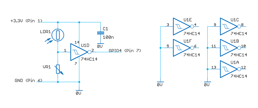

Further below in this blog post, the hardware design is extended slightly to provide auto-dimming capabilities to suit varying home lighting conditions.

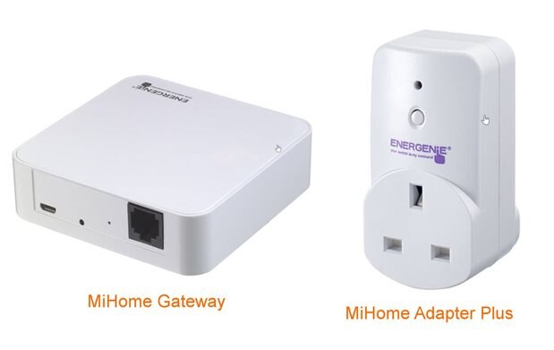

To build the solution described here, the mandatory Energenie MiHome bits you need are the MiHome Gateway, and at least one MiHome control element such as a MiHome mains adapter.

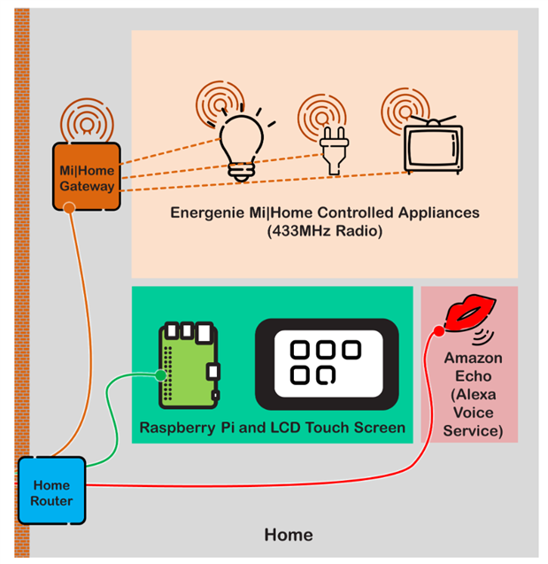

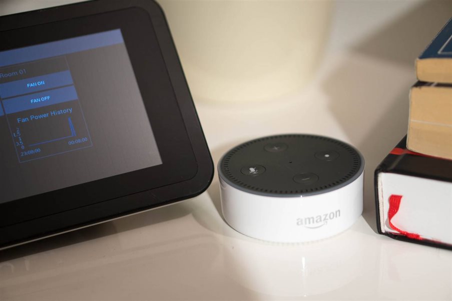

The diagram here shows the approximate topology inside the home. It is really straightforward, difficult to go wrong!
Just to recap, the home devices such as lights and sockets are controlled via radio. These are shown at the top of the diagram. The hub that communicates over radio to them is the MiHome (also referred to as Mi|Home) Gateway. It connects to the Internet (for example using DSL) by plugging into your existing home Internet router. The user sets up an account at the Energenie MiHome website and downloads an app if desired. From here the user can control any device from anywhere with an Internet connection.
Voice commands are possible due to integration between Amazon’s Alexa service and the MiHome cloud service. All it requires is for the user to obtain an Amazon Echo or Echo Dot device as mentioned earlier, and run a small bit of configuration; all this was covered in Home Automation in the UK Simplified, Part 1: Energenie MiHome
This part 2 now covers the green portion in the diagram above. Basically it connects a Raspberry Pi to the solution. The Pi communicates to the MiHome service using an application programming interface (API). A user interface also runs on the Pi, so that a connected touchscreen can be used for controlling and monitoring the home. The typical flow of information is therefore:
  1. The user presses a selection on the touchscreen
  2. The Pi sends the command in a specific format (using the API) to the MiHome web service in the cloud
  3. The MiHome service looks up the pre-registered user, and sends commands to the MiHome Gateway
  4. The MiHome Gateway unwraps the command and converts it into a radio signal
  5. The radio signal is picked up by the appliance intelligent mains socket and switches on or off the connected appliance
In the event of network failure, the local controls on each mains socket will continue to function. The touchscreen controls can also continue to function since the Pi can switch to radio mode, sending commands directly to the IoT devices, using a radio module plugged on top of the Pi. This last capability is outside the scope of this blog post and may be covered in a later article if there is interest.

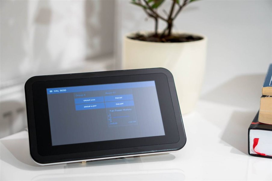

In summary, the Energenie + Raspberry Pi + Capacitive Display + Amazon Echo forms a fairly comprehensive solution, little effort is required to build it, and all code for this project is published and is easy to customise.

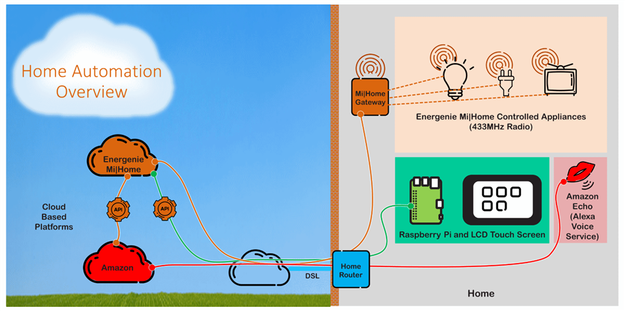

The diagram below shows the complete path of information between the home and the cloud services. This is not necessary to know, it is just background information for those that are curious.

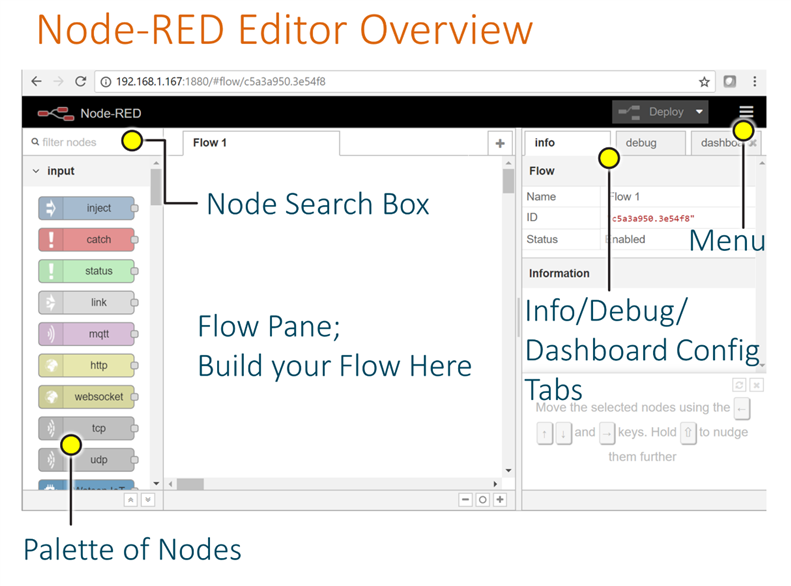

Using Node-RED
The CLI command node-red-start will have resulted in a web server running on the Pi at port 1880. Code is written (actually, mainly drawn graphically with a bit of configuration) in a web browser. The editor view is shown when any web browser (e.g. Chrome or Internet Explorer) is used to see the page at http://xx.xx.xx.xx:1880 where xx.xx.xx.xx is the IP address of the Pi.
Here is what it looks like:

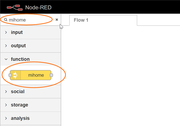

In the left pane, (known as the palette), scroll down and confirm that you can see a node called mihome in the group under the title 'function' and a whole set of nodes suitable for user interfaces under the title ‘dashboard’. To save time finding a node in the palette, you could just type the name, e.g. mihome in the search bar as shown here.
What does this mean? Basically, it means that ‘mihome’ functionality is available for you to use in your graphically designed programs which are known as ‘flows’ in Node-RED. The flows will be created in the centre pane, known as the Flow Pane. It is tabbed and by default the blank canvass for the first flow (Flow 1) is presented. When creating programs, nodes would be dragged from the palette onto the flow pane. Then, connections would be made between nodes. Each node would be configured by clicking on it; a node configuration parameter window then appears, and help on the node appears in the tab marked Info. The program is run (or ‘deployed’) by clicking on a button marked Deploy shown in red on the top-right of the web page when a flow is created (by default it is grayed out).

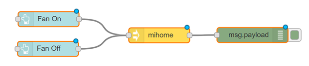

To help get started, I’ve created an example program sufficient to control home appliances with the MiHome solution. To obtain it, click to access the example code on github and then copy the program (press ctrl-A and then ctrl-C to copy the entire code into the clipboard). Next, go to the Node-Red web page and click on the menu on the top-right, and select Import->Clipboard. Click in the window and press ctrl-V to past it in there, and click Import. The code will appear graphically, attached to the mouse pointer! Click anywhere inside the web page to place it.

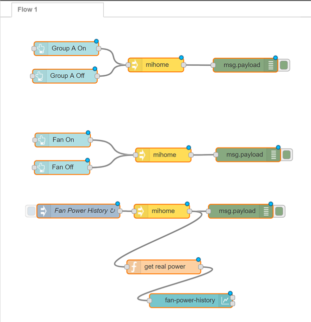

This is what the demo program looks like:
As you can see, it is split into three main parts; the top, the middle one and the bottom one. The middle part is used to control a fan.
The light-blue nodes on the left represent buttons (the actual buttons will look nicer; this is just a view of the graphical code). When a ‘Fan On’ or ‘Fan Off’ button is pressed, some signal or message is sent into the yellow mihome node. The mihome node is responsible for communicating to the Energenie MiHome cloud (which in turn will send a message to your MiHome Gateway box, which will then send a radio signal to the end appliance mains socket). The green node on the right doesn’t do much; it is used for debugging and will dump text into the ‘Debug’ tab in the editor.
The top flow looks near-identical, except that the buttons do not control a fan, but rather control a group of appliances. For example, you may have several lamps in a room and you may wish to define a group to control them all simultaneously.
In summary, the mihome node will recognize various commands and will make the appropriate API call to the cloud, to invoke the appropriate real-world action like switching on appliances.

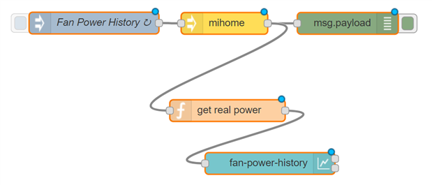

The bottom flow is a bit different:
It doesn’t have a light-blue button node on the left. Instead it has a darker blue node which is known as an Inject node. It has the characteristic that it can repeatedly do something at regular intervals. It has been configured (by double-clicking on it) to send a message to the yellow mihome node every minute. Every minute it instructs the mihome node to query the Energenie MiHome cloud and find out how much power is being consumed by the fan appliance. When the cloud receives the request, it will send the request to the Energenie MiHome Gateway box which will transmit a radio signal to the fan mains socket, which will respond back with the result.
The pink/orange get real power node is a function node. By double-clicking on it within Node-RED, you’ll see that all it does is extract the ‘real power’ value out of all the information that is returned and discards the rest. The final node in the chain, the fan-power-history node is a chart node. It is responsible for graphing all the information it receives. The end result would be a chart that updates every minute.

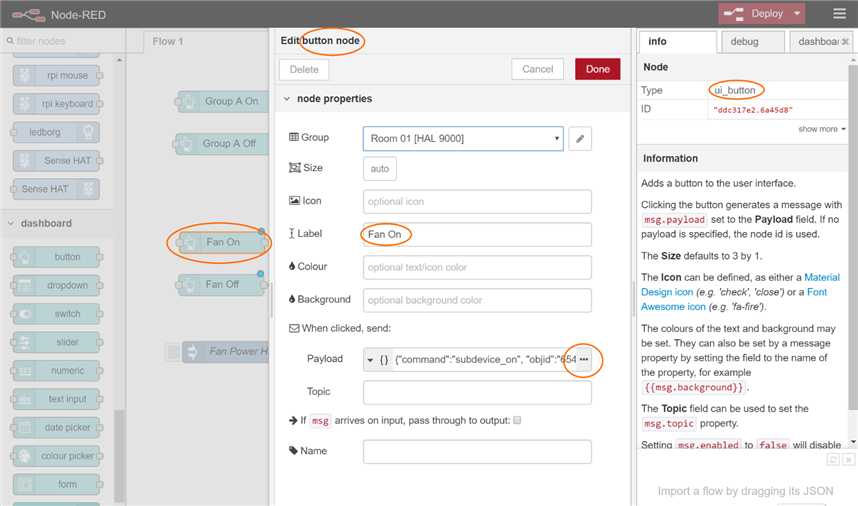

To explore the yellow mihome node in a bit more detail, double-click on any preceeding node, to see what information is sent to the mihome node. For example, if you double-click on ‘Fan On’, you’ll see this information appear:
You can see that this is a button node (or more specifically ui_button), which is part of the dashboard collection of nodes in the palette. It basically will display a button on the screen. The button will be labelled “Fan On” and if the user clicks it, then a message or payload will be sent into the mihome node. The payload is partially shown on the screen, but click on the button marked ‘…’ to see it fully. When you do that, you’ll see this text:
    "command": "subdevice_on",
    "objid": "65479"
The command indicates that this is something to be powered up, and the objid identifies what device should be powered up. That objid value 65479 happens to be an Energenie mains socket that I own, connected to a fan. In your home, every Energenie device will have its own unique ID, and they are very likely to be different to mine, although there could be overlap. So how does the mihome node know which device should be controlled, yours or mine?

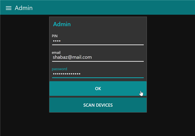

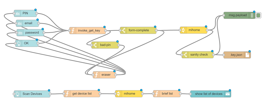

Building an Admin View
The Admin view is used to initially configure the Pi so that it has the API key to control your home. I created it as a separate program (flow) that happens to appear in the same user interface. You can obtain the code by clicking on the Menu button (top right) and selecting Flows->Add. You’ll see a Flow 2 tab appear with a blank canvass for your new flow. Then, click here to access the admin view code on github and select all (ctrl-A) and copy (ctrl-C)  the entire program there. Import it into the Node-RED editor as before (click on the Menu icon and then Import->Clipboard and paste it there using ctrl-V) and then click on Deploy.
Here is how it works; the top-left shows four user interface objects; the PIN, email and password nodes will be text boxes where the user can type in these parameters, and then click the OK box. All the information will have been collected up by the next node in the chain, called invoke_get_key which checks that all the text fields have been populated and that the PIN number is correct (the PIN is not used for security; it is just used to prevent young children in the home from accidentally wiping the API key, since the code will not perform a request to obtain an API key until the PIN is correctly entered; it needs the correct username and password to get the API key, but if the incorrect username and password was used then the API key would be wiped out, so the PIN prevents that from accidentally occurring if babies/young children start playing with the touchscreen). Since the PIN doesn’t play a security role, it is just hard-coded; you can edit it by double-clicking on the ‘invoke_get_key’ node. I won’t explain the rest of the flow, but it is simple and straightforward to explore by double-clicking on nodes.
The end result is that the flow will allow the API key to be retrieved and stored permanently on the Pi in a file in plain text format. The password is not stored as mentioned earlier. Since the API key is stored, if the Pi reboots, the user will not have to add the API key again.

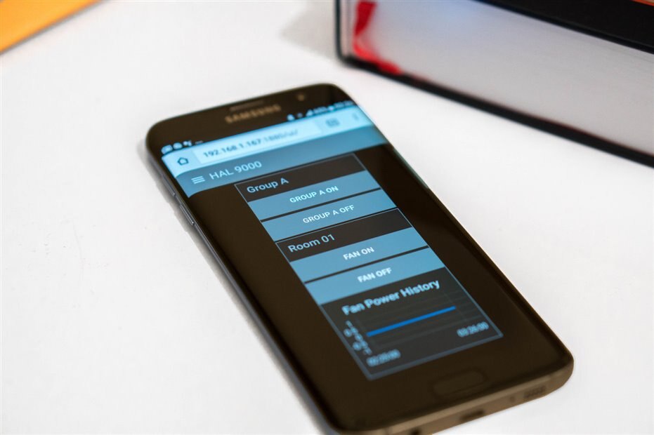

So far, we have examined the flows for the example home automation system, and the Admin view. Once you’ve clicked Deploy, the code will be running. The user interface can be accessed by opening up a browser to

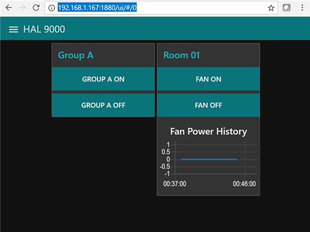

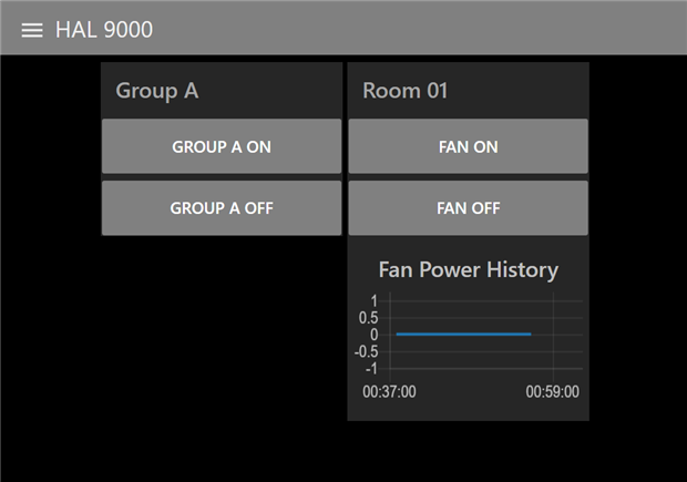

http://xx.xx.xx.xx:1880/ui and you’ll see this:
The buttons can be tapped to switch things on and off, and the chart shows the power consumption of the fan over time, allowing you to see when the fan was used (it was not used; it is cold here!).
The menu is the result of the code in Flow 1. But the system won’t work until it has been configured as in Flow 2. To do that, click on the menu icon (the three bars on the top-left, next to where it says “HAL 9000” and in the drop-down, select ‘Admin’, and you’ll see the code from Flow 2 executed:
Once you’ve entered the PIN (it is 1234 unless you edited the code as mentioned earlier) and e-mail address and password as used on the Energenie MiHome cloud service, click on OK and the system will retrieve the API key from the cloud service and store it locally.
You can’t control the fan, because it is set up for my fan mains socket identifier; you’d need to change it to suit your own device. To do that, click on Scan Devices and the system will show in a pop-up window a list of all Energenie devices you own, and their associated identifiers. Take a screen print of that, and you can use it for editing the flow to add buttons and groups for those devices. Once you’ve done that, click on Deploy again.

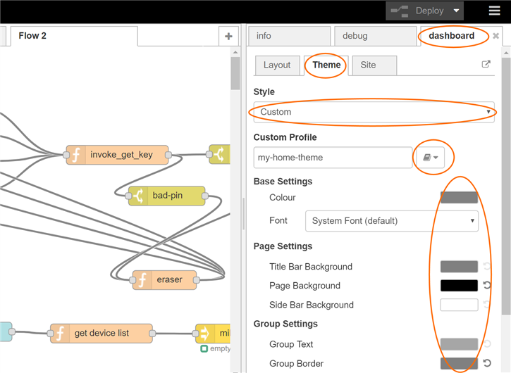

Theme Customizations
I didn’t like the color scheme, but thankfully it is possible to choose your own. To do that, go back into the editor view at http://xx.xx.xx.xx:1880 and then click on the Dashboard tab on the right as shown here:
You’ll see lots of options to adjust the ordering of buttons in the Layout sub-tab. Click on the Theme sub-tab and then set Style to custom and you’ll see all the elements that can have different colors. Once they have been adjusted to suit preferences, they can be saved under a custom name. I didn’t want the touchscreen to be entirely lit up brightly at night-time, so I chose a dark background for example.

Preventing Display Blanking
After some minutes of inactivity, the display will blank by default. Depending on requirements this may be undesirable. To prevent the screen from blanking, issue the following commands.

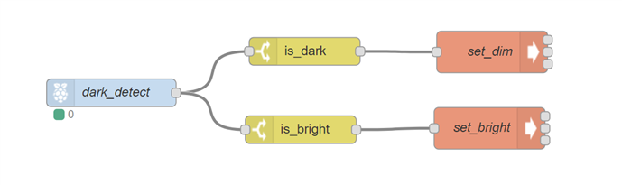

In order to invoke these scripts, a new flow is created in Node-RED. Click here to access the auto brightness source code on github.
Once it has been added to Node-RED, click on Deploy to activate it.
The flow looks like this:

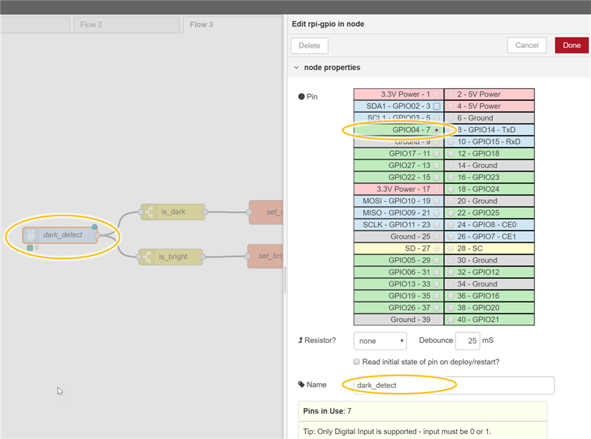

The left node, called dark_detect, is configured as shown below (double-click on it within Node-RED to see this):
The dark_detect node will generate a message of value 1 whenever the Raspberry Pi’s 40-way header pin 7 (GPIO 4) goes high.
A small circuit was constructed to generate a logic level ‘1’ whenever it goes dark:
The circuit consists of a Schmitt trigger inverter integrated circuitSchmitt trigger inverter integrated circuit, a light dependent resistorlight dependent resistor, a 50k trimmer variable resistor50k trimmer variable resistor and a 100nF capacitor100nF capacitor. The trimmer resistor can be adjusted to suit the home lighting level.
It worked well. When the room lighting is reduced, the display automatically dims to a very comfortable level.

    shabaz over 6 years ago in reply to ojsimmonds
    Hi Oliver,
    I've updated the github content with that information as before, and tested it, and it works for me now.
    I tested with a Pi 4 just now, and I've also updated the information in the blog post (a few installation steps changed, but if everything is functioning for you then there's no need to reinstall it all).
    Using the steps, it was possible to install from scratch on a Pi 4, enter the PIN+username+password to get an API key, and then scan for devices, and enter the device number into the first flow, to be able to control a remote mains socket.
