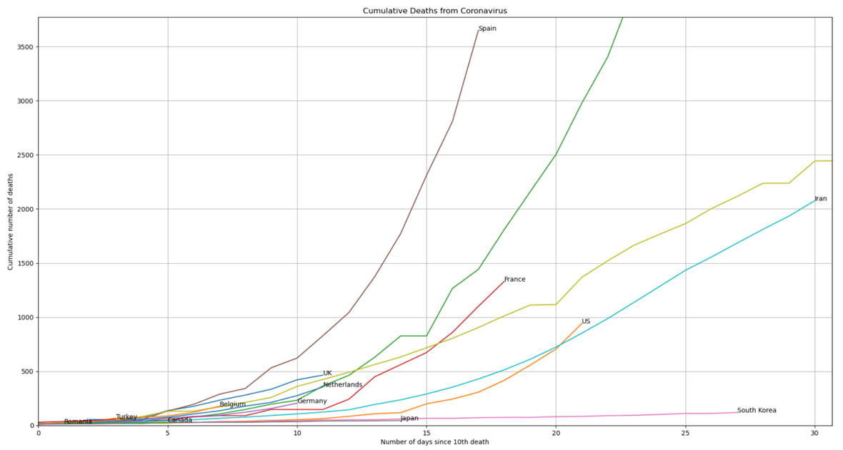

Here’s what the situation really looks like, as of 24th March 2020, for a few countries. This is actual deaths over time, it is not some prediction based on a low volume of testing, and it is on an clear unambiguous scale. On the chart, the starting point per country, and precisely what countries are plotted, is down to us.
The result is frightening.
Zooming in closer, we can now see the exceptionally mediocre state certain countries are in, and the direct consequences of poor and deliberate government decisions and the squandered time. No wonder the newspapers and the government didn’t want it to be easily visible.

    Today's chart (the data source is refreshed at midnight, so this is as of 15 hours ago): Italy is still a straight line off the chart at about 11,000 deaths. It is the dark green line at the top. Light…

    Chart for today...
    Looks like Spain is at around 800 new deaths per day. France and US are heading for similar rates within a couple of days. UK was on amongst the worst trajectories with perhaps 200 needless deaths so far, compared to had it been on an average path.
