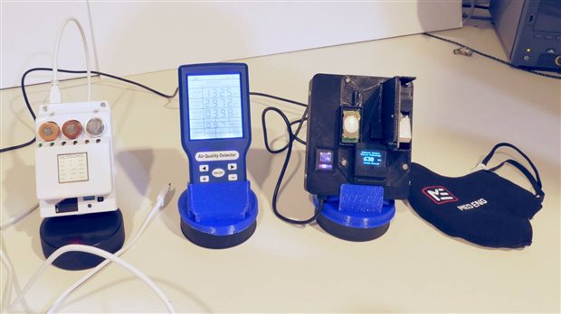

I have 3 CO2 sensors, so I wanted to see if they would tell me anything about my CO2 inhalation levels.
Here is a picture of what they look like with an intruder trying to influence the readings:
The sensor on the left is from my Invisible Hazards project.
The sensor on the right is from my Amphenol Advanced Sensors Road Test.
The instrument in the middle is a commercial air quality sensor.
The mask to the right is a double layer cloth mask made by my company.
It was very challenging to get all 3 displays to be readable in the same camera image because they are such completely different technologies.
The OLED display on the right was particularly difficult because it was refreshing at a rate where the camera was only catching part of the information.
I had to turn off the bright lights and take a long exposure to get all the info on the OLED display.

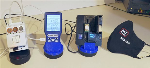

Here is a shot of ambient CO2 levels - you may need to click on the image to see the data more clearly:
Left sensor: 444 ppm, middle sensor 524 ppm, right sensor 644 ppm.
Note the sensors don't exactly match, but they all responded well to increasing CO2 levels. The actual sensors are in different locations - the one on the left is the black area under the display, the meter in the middle has a sensor on the back, and the sensor on the right is the gold rectangle in the middle of the case.
Also note the 3D printed stands with puck bases to at least stabilize all sensors at the same angle. This is important for the middle meter since its sensor wouldn't have good access to air if it were laid on its back.

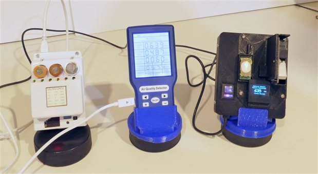

I used the middle meter (only because it is easier to hold) to take readings close to my face - about 3 inches in away from my face, inline with the side of my face at mouth level. With and without the mask on.
Here is a shot of the meter right after about 30 seconds of exposure with no mask on:
Left sensor: 420 ppm, middle sensor 1325 ppm, right sensor 630 ppm.
Note the 2 meters that were not close stayed about the same and the middle meter has doubled from being close to my face.
Sensor positioning during readings.

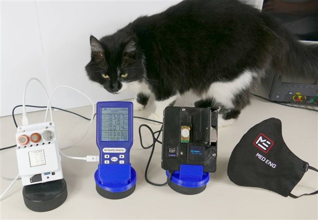

Now here is a shot taken after the same exposure of the middle meter with the mask on:
Left sensor: 427 ppm, middle sensor 639 ppm, right sensor 635 ppm.
Again note the 2 meters that were not close stayed about the same.
But the middle meter is now reading half of what it read with no mask.
I found this surprising, but the result was repeatable.
I do not have a good explanation for this result, but that is what the data showed.
Presumably the mask was causing exhaled air to be channeled  away from where the sensor was.
Perhaps this was due to some of the exhaled air squirting out the sides of the double layer mask - away from the sensor.
Perhaps the mask had a diffusing effect so that exhaled air was more rapidly mixed with ambient air.
My apparatus doesn't definitively show what is going on.
A couple of tentative conclusions might be that:
  1. In either case, the concentration of CO2 near my face was a lot less than the 4% expected in exhaled air, so it wasn't accumulating to dangerous levels (that is good)
  2. CO2 concentrations drop very quickly in exhaled air as it mixes with ambient air (also good)
These sensors are quite sensitive, but they are not instantaneous, and the sensing area is not going to do a great job of measuring swirling air of variable concentration.
They cannot measure total CO2 in an area, they just measure the concentration right at the sensor.
These factors make them not ideal for this type of experiment, but it was fun and surprising to see what they showed.
As sloppy as the testing was, it did provide some insight into CO2 concentrations around masks and faces and it alleviates any concern about dangerous buildups of CO2 with masks.

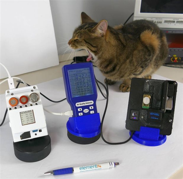

If you found all this boring....you aren't the only one.....
What a yawner project...
Provide your own caption for this picture in the comments below...
  • beacon_dave
    beacon_dave over 6 years ago +6
    The cat appears to be showing symptoms of 'possible drowsiness'... Is this where your exhaled CO2 ended up ?

    Gough Lui over 6 years ago +5
    Caption: Do you see the CO2 yet? (cough cough ... furball) - Gough

    The tube idea is interesting, however it is very hard to figure out exactly how the sensors ingest and purge air, and how very localized concentrations affect readings. There are odd (variable) delays in response and of course invisible gases aren't helping.

    The black and white cat is more serious - her idea of fun is hunting mice or patrolling on the top of the fence - not a poser. The other cat is just a curious playboy.

    A very interesting and timely experiment. I love the input from your lab assistants. They provide an objective assessment on the activities of their owners.

    Have you considered putting a tube or straw inside the mask and using that to dump CO2 inside the mask directly on a sensor?
    The main concern is that CO2 will build up in the lungs because you do not get a good interchange of fresh air in versus CO2 outflow creating a net CO2 gain in the lungs.

    I see you are fortunate enough to have two lab assistants.  The first kitty appears to be wary, the second not so interested.  Not sure whose opinion would be most valuable.
