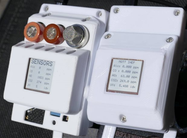

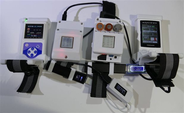

Observations & Surprises
This project has been a very interesting journey researching a wide variety of invisible potential hazards, designing systems to measure invisible hazards, building wearable instrumentation and testing my environment to see what invisible hazards might be present.
It is probably obvious from the content of my blogs that I learned a lot, actually way too much to fit into a few blogs, but the big surprise for me was how much fun it was. I anticipated the usual thrill I get from designing things and making them work, but I did not foresee how much fun it would be to use the instrumentation to examine my environment. It is a bit like the first time you got to play with a magnifying glass – you just run around looking at absolutely everything in a new way. It was also surprising to me how many people around me took an interest and wanted to examine their own environments. Normally talking about my projects is a good way to elicit glazed looks of boredom, but with this project, so many people wanted to borrow instrumentation it was tough to hang onto it long enough to take my own measurements.
The Kit

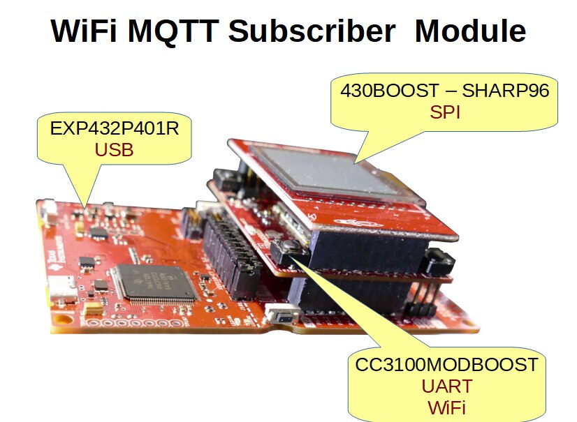

I am very happy the EXP432P401R was the required processor module for this design challenge as I might not have discovered it otherwise. This module is a very powerful, very capable and cost-effective platform for applications like this and will definitely be a favourite choice for future projects. The development environment was very easy to learn and use, especially since there were good examples available for most of the functionality I wanted to implement.
The comprehensive kit of modules supplied with the challenge (thanks Texas Instruments and element14) really allowed a complete wireless instrument with LCD to be implemented without even having to use wires and cables. Normally building such a platform would be an ambitious undertaking on its own, but with these plug-and-play booster packs and existing software examples, it enables projects to start with a complete, highly functional system and go beyond just getting some computer hardware to work.
Highlights

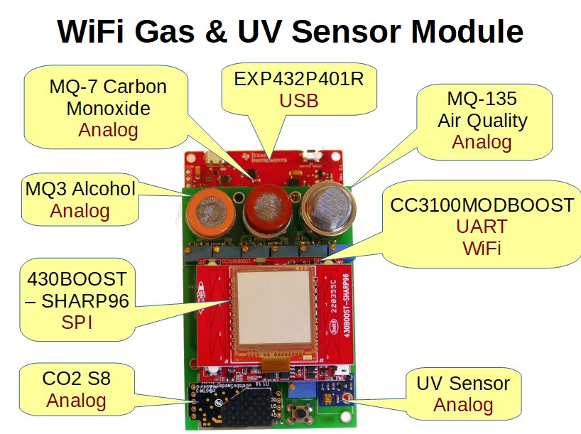

I got to design a custom sensor booster pack and the clear documentation available from Texas Instruments allowed it to work flawlessly without rework, respin or modification. It is really worth taking the time to do the job well – the gratification (and relief image) is immense.
I also got to design many 3D printed parts, continuing my mechanical design learning journey.
It has been a long project with many little problems to overcome, but all the things I've learned and all the things I've accomplished in this project have made it a truly fabulous experience.
This is probably my last blog during this challenge as I have other projects that need attention, but you never know – I certainly will continue to work on the system and use it – the novelty has not worn off yet.

IHEF MQTT Subscriber Firmware
Invisible Hazardous Environmental Factors
by Doug Wong 2017-04-08
Remote Display via MQTT
   - connects to an MQTT server
  - subscribes to the topic "IHEF"
  - displays Alcohol, CO, Air Quality, CO2, UV
#include <SPI.h>
#include <WiFi.h>
#include <PubSubClient.h>
#include <LCD_SharpBoosterPack_SPI.h>
