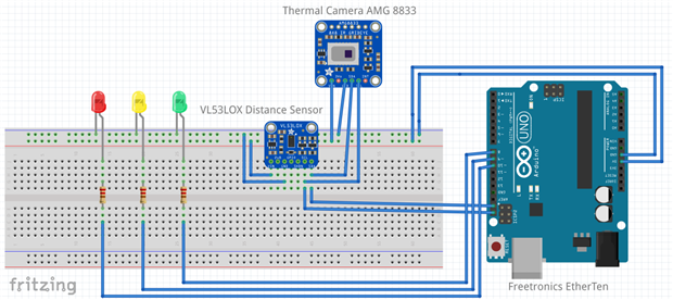

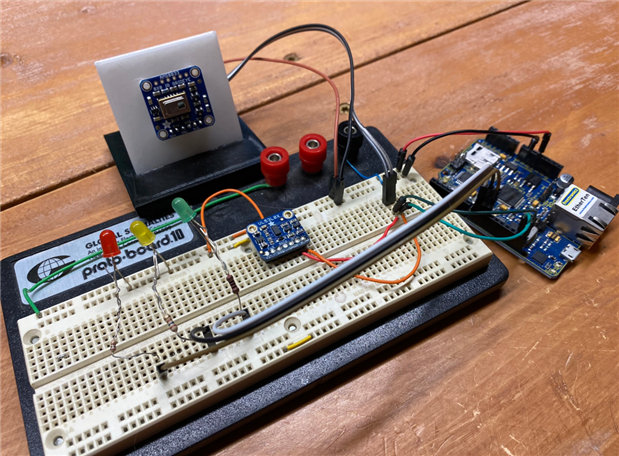

What I wanted to create was a simple device that could check one's temperature. I wanted it to be non-invasive and non-contact. I also gave myself a restraint to only use what I had on-hand and not order any parts, as to not add any additional stress on other companies unduly. I used a Panasonic AMG 8833 sensor on a breakout board from Adafruit as the main sensor. This is an infrared (thermal) sensor with a resolution of 8x8 pixels. I had this laying around as a spare from the Smart Range Hood project (Still up and running!). Most projects using this generate a heat map image, but I wanted to go a little simpler. I just used three LEDs to indicate the status. Green = good, Yellow = borderline, Red = Fever. To trigger the system, I used a VL53LOX Time of Flight sensor. I am able to control the trigger distance this way and only read the thermal sensor when a person is in range. I had picked up two of these years ago and never used them until two weeks ago when I started putting this together. As a controller, I used an Arduino Compatible EtherTen from Freetronics
I had a plan to hack a PiSense hat to use the 8x8 LED array to correlate the temperature from the thermal camera, but couldn't find it in my bins after about 30 minutes of looking around. It would have been a stretch since I would have had to manually interface it to an Arudino instead of a RaspberryPi and I couldn't find any guides online. I would have likely had to switch to the Arduino ProMini that I have to use the 3.3v logic.
I also had another concept that would use an RFID scan to trigger the temperature reading. The idea here is that an employee could scan their badge, have a temperature taken, and the temperature could be logged in a database. This database could then establish a baseline for each employee and apply a individual curve to look changes over time. This could potentially be more accurate, but with the downside of being more invasive as employees might not be comfortable with their employer having this information about them. I have an NFC kit for RaspberryPi in a bin and grabbed it, but later passed on the concept.
Wiring it up
The layout was pretty simple. Both the main sensors are I2C, so they just needed the clock and data lines connected to the SDA/SCK pins of the Arduino. The Green/Yellow/Red LEDs were on pins 8, 9, and 10; each with a 220 Ohm resistor. This was a very simple circuit layout that only took about 30 minutes, with 27 of those minutes with a multi-meter digging through a pile of resistors trying to find the right ones...My sensors could work at 3.3V or on 5V. I opted for 5V since the Arduino I was using was set up on 5V. If I was using the PiSense hat and hacking it into this project, then I would convert everything over to 3.3v.
This project is 'simple enough' to be easily represented in Fritzing, so here it is.

Video Demo
See this video for a walk-through of the system running.
Note: The reason that my hand can make the sensor go from green to yellow is because I am averaging all the pixels in the camera. As I move my hand closer, more pixels see my hand and thus the average moves up. If I used the "max" pixel temperature the behavior would be different.

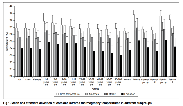

Efficacy of using external temperature sensing of core body temperature
A key aspect of this project and other similar ones has to do with the correlation of external body temperature versus core body temperature. The golden standard is either oral (under the tongue) or rectal to get the most accurate measure of the core temperature. Studies have shown that there is a "significant but weak" correlation between forehead and temporal temperature versus core body temp, but this can differ by up to 3.5°C. So the forehead could measure 34°, but the core could  actually be closer to 37-38°. That amount of error if not accounted for could be cause for a false negative result. With Coronavirus being as contagious as it is, that false negative could have very real consequences. There is also a possibility of having a false positive where someone has a naturally higher exterior temperature. The measurement device would be hard-pressed to simply just add 3.5° to all readings since it will put some amount of healthy people into the range where they wouldn't be allowed in to work and would potentially have to try to speak with a doctor or visit a hospital. This could be very disruptive for a lot of people trying to work at an essential business with limited means of child care and loss of income due to layoffs of others in the household.
(Image taken from the article linked just below here)
This chart illustrates how the forehead is the farthest-away option (largest temperature delta) when compared to the core body temperature, especially in the case of febrile (sick) individuals. Latmax and areamax (max of the entire face region) are the closest.
There are also some significant differences in the delta and core temperature across age and gender which can make blanket assumptions difficult.
See this link for some very useful information: https://www.hkmj.org/system/files/hkm1204sp3p31.pdf

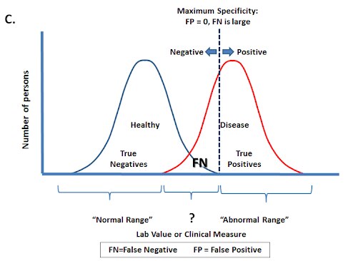

The exact definition of a fever and the thresholds chosen as the cutoff will play a large factor in the number of false positives and false negatives. This is referred to as "sensitivity and specificity". The chart below from an image search demonstrates the concept of these terms. The study done in the document linked above talks in detail about the SARS outbreak in China in 2005/2006 and goes into a lot of detail about how this could have helped (or not). The best results based on the data set was "77% sensitivity and 74% specificity" based on a maximum face temperature of 36°. That equates to roughly 25% of results being false positives and 25% being false negatives. Not a very stellar result, but that is the highest success rate that could be achieved as a result of this study.
The article mentions that reading on the lateral max temperature of the face (temple area) has the highest correlation to the core body temperature, so should be the preferred measurement type as opposed to the center of the forehead (which my work is currently doing...)
Note that none of this data or methods dispute the accuracy of thermography in any way. The sensors are plenty accurate enough, but the methods in which they are applied can cause lead to undesired results. The next step of finding an individual with a fever must be considered. It would be expected that many would contest the accuracy of the device and the methods and make for some headaches on the side of the employers.
One thing of note is that there are many hand-held devices for checking temperature on the forehead and in the ear. These are often "contact based" instead of non-contact, and they also will have one button for forehead and one for ear. The idea is that a different offset will be given for each of the measurements to try correlating to core body temperature.
So any who may be considering this for a workplace should consider the implications very carefully.
