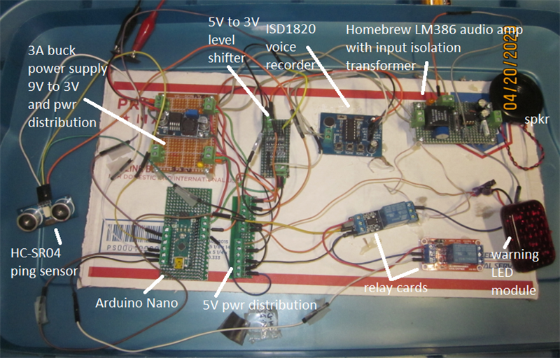

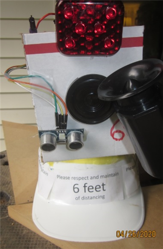

Keeping social distance and wearing a mask greatly reduce the risk to transmit/receive coronavirus.
While our attentions are usually focused on other tasks, we (or others) may need a reminder to stay 6 feet apart.
This hat looks for an object within 6 feet of the wearer. If an object approaches within 6 feet of the wearer, my voice will announce "please respect a 6 foot distancing"
If an object is within 2 feet of the hat wearer, the hat sets off a 90 dB horn for 1 second to get their attention.  nyuk nyuk nyuk
The electronics platform rotates to detect objects 360 degrees of the wearer - No Sneaking UP on the wearer from behind !  :-)
Using the ISD1820 sound recorder chip allows instant re-recording of the message should it need to be changed quickly to a different language, or make the message multi-lingual.
The social distancing hat is clearly marked around its circumference to respect a 6 foot distance.
The hat in action can be seen on this video:
https://youtu.be/nFs1KOz2dAw

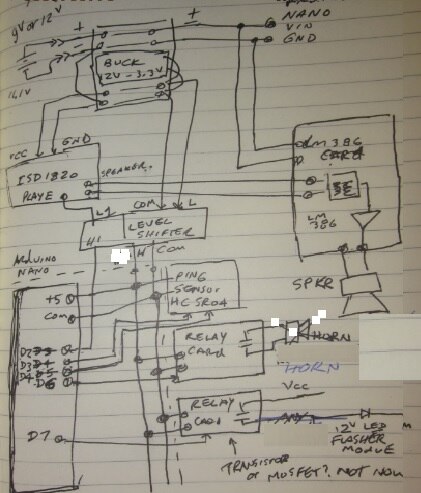

parts
schematic
Future Modifications:
1) I'd like to get a modified PixyCam2 that could detect IR images.
This would allow the control to distinguish close objects and people, and add important features:.
An infared PixyCam2 would allow the ping sensor  to be put on a tilt/pan device to get a distance reading at a specific infared target.
It would allow accurate annunciation from a standing position as well as a sitting position.
2)  I'd like to use a better speaker to improve audio intelligibility

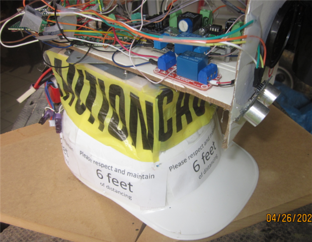

3) This packaging is awkward and spread out. A next prototype would be compact , lower center of gravity, and attractive.
4) The turntable motor is mounted on top of the hat, with electronics on a platform riding on a bearing
   Next prototype version, the motor would be on the rotating platform.
   This allows the use of one battery, and the turntable motor could be temporarily stopped when an object is detected

    dubbie over 6 years ago +3
    I think if you were wearing this hat people would most likely stay more than 2 metres away anyway. A good solution although it looks a little top heavy - perhaps it is a top-hat. You might try using a…
  • robogary
    robogary over 6 years ago in reply to dubbie +3
    Thanks Dubbie - The suspension on the bump cap came apart on the inside and the hat is top heavy from the turntable motor and gearbox used. Definitely the gearbox motor could be downsized, but its what…
  • ralphjy
    ralphjy over 6 years ago +2
    I don't think that I could manage a 2 hour walk wearing one of these . I bet the kids love it!! Ralph
    I think if you were wearing this hat people would most likely stay more than 2 metres away anyway. A good solution although it looks a little top heavy - perhaps it is a top-hat. You might try using a hard hat safety hat instead of the soft-cap. These provide  a much more rigid structure with the potential to hide the electronics inside the hat, between the webbing and the plastic of the hat. You could also try placing multiple PIR sensors around a hat to achieve the same outcome.
    Dubbie
  • robogary
    Thanks Dubbie - The suspension on the bump cap came apart on the inside and the hat is top heavy from the turntable motor and gearbox used. Definitely the gearbox motor could be downsized, but its what I had in my inventory.
    A baseball helmet or motorcycle helmet definitely work better for stability as well.
    The PIRs sense motion, but dont return distance measurements, maybe you meant multiple ping sensors.
    The main idea of the spinning platform is to have the speaker and the flashing light pointing in the direction of the perpetrator, thats the reason I opted for one ping sensor   :-)
    If this were being designed for a production model,  I considered removing the 90 db horn, the ISD1820 IC, audio amp and speaker, and just using a smoke detector piezo-speaker and driver IC.
    These changes significantly simplifies the control, reduce size, power consumption, weight and cost ................but the hat just wouldn't be novel and fun anymore..................
