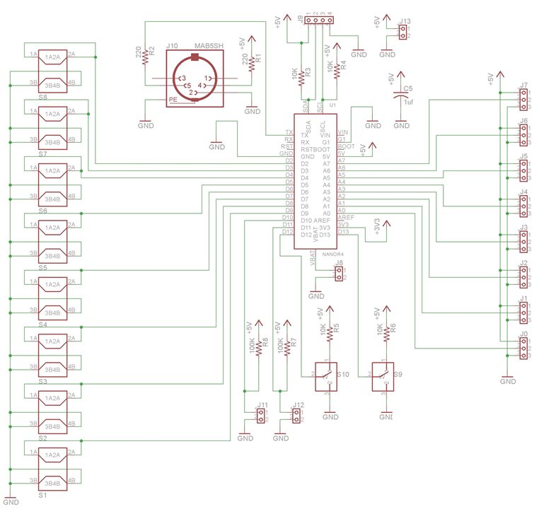

Intro
I have been having fun dabbling with MIDI electronics for quite a while. I'm no kind of musician, but I still find it fun to fool around with the technology. This project is a MIDI controller, specifically a MIDI controller that can convert electronic drum pad signals into MIDI data.
The idea is to design some drum pads that use piezo disks to sense drum stick hits and a microcontroller to perform digital signal processing to translate the signals into valid MIDI data. Any drum pad can be assigned to sound like any percussion instrument.
There is also a metronome that can be turned on or off and it can also sound like any percussion instrument, so it could sound like a foot pedal bass drum. (Which I am not coordinated enough to handle with my foot) The Interface card does have 2 separate inputs for foot pedals though.
The drum pads are made using PCBs so the signals can be conditioned right on the card to keep the signals compatible with the MCU voltages.
Video & Demo
Here is a video outlining where the project stands.
Schematic
Software
  MIDI Percussion Controller for Arduino Nano and Nano R4
  - 8 analog drum pads on A0–A7
  - 1 metronome “channel”
  - 4x20 I2C LCD
  - 4 buttons for channel/instrument selection
  - Metronome on/off and rate select switches
  - MIDI over UART (Serial) on channel 10 - the percussion channel
  by Doug Wong 2026
