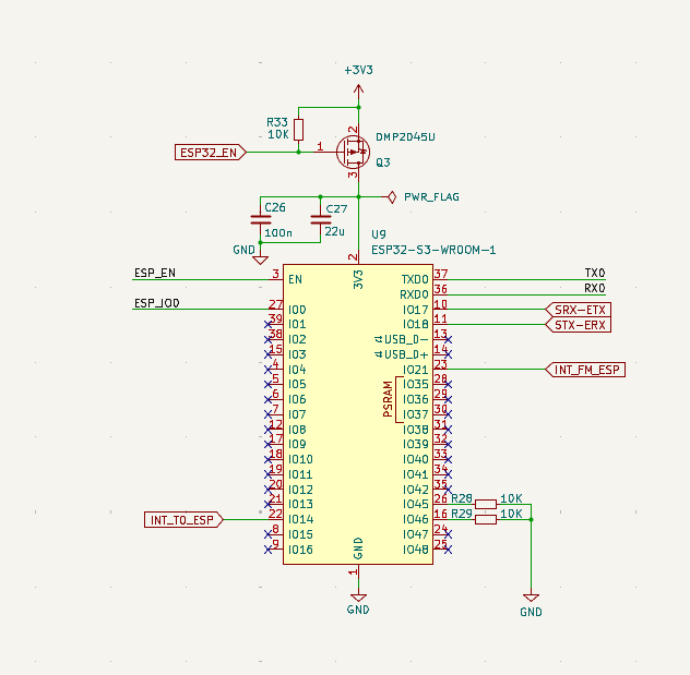

I’m using a DMP2045U P-channel MOSFET as a high-side switch to control 3.3V power to an ESP32-S3-WROOM module. The gate is driven by an STM32.
Connections
  • Source → 3.3V (measured 3.289V)
  • Drain → ESP32 3V3 pin
  • Gate → STM32 GPIO
  • 10k pull-up from gate to 3.3V
Measurements
When gate is LOW (~0.009V):
  • Source = 3.289V
  • Gate = 0.009V
  • Drain = 3.289V
  • Vgs ≈ −3.28V → MOSFET turns fully ON (as expected)
When gate is HIGH (3.287V):
  • Source = 3.289V
  • Gate = 3.287V
  • Vgs ≈ 0V → MOSFET should be OFF
However:
  • Drain measures ~2.89V
I added a 47k pulldown resistor from drain to GND. This reduced the drain voltage to ~2.4V — but not to 0V.
  • All STM32 GPIOs connected to the ESP32 are driven LOW.
  • If I completely remove the MOSFET, the ESP32 3V3 rail stays at 0V (no floating voltage).
Question
Is this expected off-state leakage/floating behavior for a discrete P-MOSFET in this configuration, or is there something wrong with my circuit?

    Is it possible you have active signals on the digital lines when the ESP32 is off, that seep to the power rail?

    You have about 50uA leakage through the MOSFET when it's supposed to be turned off - the spec says it should be less than 1uA. Try shorting the MOSFET gate to source (I know its already meant to be at…

    It sounds like the FET is damaged.
  • arvindsa
    0 arvindsa 8 months ago in reply to dougw
    I had simultaneously soldered two boards. Using standard reflow profile on miniwares hotplate, yet both showing same behaviour. I will try replacing it.
  • kmikemoo
    0 kmikemoo 8 months ago
    And sometimes, they just leak.  Either way, the solution is the same; replacement.
    Try shorting the MOSFET gate to source (I know its already meant to be at the same voltage but maybe that only happens when your meter is there - I have seen that before.)
    Then check that it really is turning off.
    Also try a restive load rather than the ESP32.
    I have seen a batch of MOSFETs that were a lot leakier than spec - so it could just be that.
