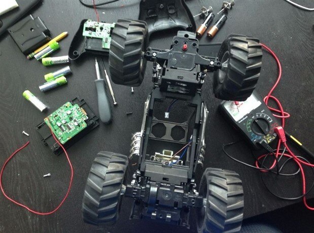

If you ever run into a scenario when you RC controller stops working or does not connect to the transmitter for some weird reason, and you have tried all the tricks up you sleeve to fix the issue, the best thing to do is to gut most of the components and add either a Raspberry Pi  or an Arduino with a motor controller. In my case, I am using a Raspberry Pi 3 B+ and Adafruit's motor driver Pi Hat to breathe new life into my broken monster Toy Truck. Here is a picture of the final setup
First I started of by removing most of the electronic components from the truck, but keeping the battery holder and motors intact.
Once done I ran a quick test o see that the two DC motor are still working, I used a 4 AA battery back of the this, as the truck takes 6 AA batteries, and dint want to risk the motor. It say a sigh of relief that both the motor are functional image ..

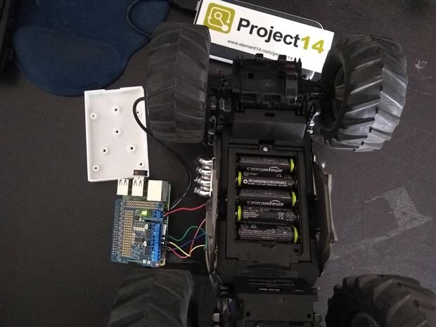

To setup the Raspberry, download the latest version of Raspbian from https://www.raspberrypi.org/downloads/ .Once the SD card is setup ,insert it in the slot of your Pi and boot it up, and enable SSH and I2C interface using raspi-config, and also setup the WiFi on the Pi.
Once done, connected the back DC motor to M2 on the Pi hat and the front motor that drives the direction to M3. And also connect the battery +ve and -ve to the hat. For more info check out the learning https://learn.adafruit.com/adafruit-dc-and-stepper-motor-hat-for-raspberry-pi

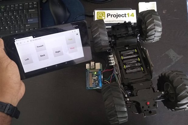

In addition, I also created a small web app so that I can control the toy truck using a Phone/Tablet, as you see in the picture below.
Here are the instruction to setup the web app, first I had to install flask http://flask.pocoo.org/ (sudo pip install flask).Flask is a microframework, which means you should be able to get it up an running quick, and test out your setup was successful. To do this, save the following python program to a hello.py file
from flask import Flask
app = Flask(__name__)
@app.route("/")
def hello():
  return "Hello World!"
if __name__ == "__main__":
  app.run(host='0.0.0.0', port=80, debug=True)
And to start the webserver run the hello.py file using - sudo python hello.py
Now to open the website on you laptop/computer browser use the http://ipaddress-of-pi , and you should see Hello World! printed on your browser.For more info/documentation about Flask follow the link http://flask.pocoo.org/docs/0.10/
Now if you are able to open the hello world webpage on you Laptop,Tablet or Phone you are ready to download the Truck-Pi.zip , extract it and upload it to the pi using Filezilla. Then run the controller.py program in the folder - sudo python controller.py, And access the web app hosted on your Pi use- http://ipaddress-of-Pi:800
Here is a quick video of testing front and back motors using the web app
In addition, since I wanted to mount the Pi board on the Truck, I had to 3D print case for the bottom, so that the Pi does not get damaged and to avoid unnecessary short circuits.
