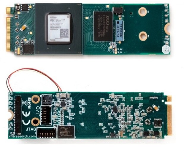

Before i could start on the JTAG boundary scan, I had a breakthrough. Remember earlier when I said earlier that the interest on EEVBlog had a downside of driving up prices? Well, it also had the benefit if having more eyes on the device. Someone spotted an uncannily similar crowd-funded device called the NiteFury on Crowd Supply. A bit of digging on other forums and it seems that they are indeed the same device. It seems likely they were developed in parallel rather than one ripping off the other. There seem to be minor differences with the location of the connectors but that seems to be all I've found.
Luckily the NiteFury does have some documentation and a schematic. This saved me a lot of time and also solved some issues I probably wouldn't have been able to - how to determine what clocks were available and where they went.
This bit of luck meant that not only would it be possible to use the SQRL Acorn - my £35 investment had netted me an open source development board that went for $329 on Crowd Supply.  I can't actually find any info on whether this actually shipped to backers. Considering the fiasco surrounding the SQRL Acorn it may not have. However, I haven't seen anyone complaining about the NiteFury either. image
