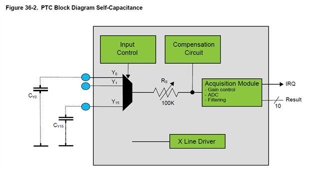

The SAMD21 processor that is used on the QT Py has a built in Peripheral Touch Controller (PTC) that can detect touch on external capacitive sensors.  The PTC has a mutual-capacitance mode to sense touch on an x-y matrix and a self-capacitance mode to detect touch on a single point (pin).   The QT Py is in the 32 pin package so there are 6 capacitive touch pins available in self-capacitance mode (A0-A3,A6,A7).
Here is the PTC Block Diagram from the SAMD21 spec

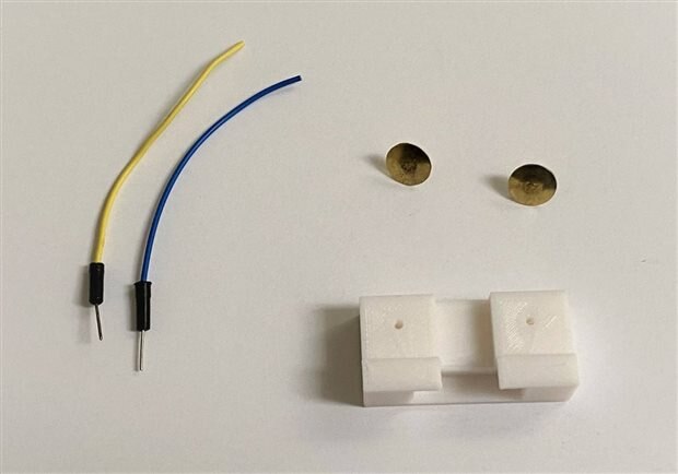

I decided that I would add 2 touch buttons to the project - one to change the NeoPixel pattern and one to play a sound (haven't implemented that yet).
I am going to use thumb tacks as my buttons and I printed a button holder that I could add to my ornament base.
