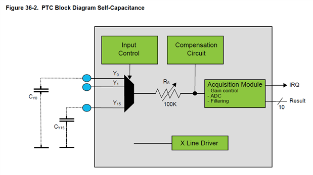

The SAMD21 processor that is used on the QT Py has a built in Peripheral Touch Controller (PTC) that can detect touch on external capacitive sensors.  The PTC has a mutual-capacitance mode to sense touch on an x-y matrix and a self-capacitance mode to detect touch on a single point (pin).   The QT Py is in the 32 pin package so there are 6 capacitive touch pins available in self-capacitance mode (A0-A3,A6,A7).
Here is the PTC Block Diagram from the SAMD21 spec
