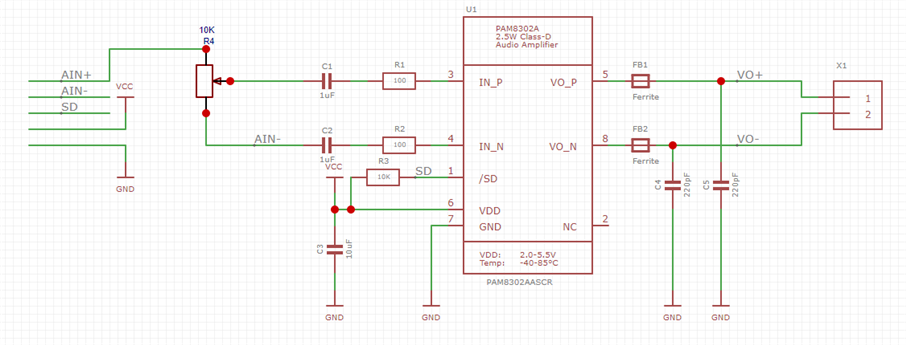

For the final element of my QT Py Christmas ornament, I'd like to add the ability to play some Christmas music.
The SAMD21 has a single DAC output that I'll use to generate tones, but I'll also need to add an audio amplifier to drive a speaker and figure out how to access the external flash memory that I added to store the music files.
In this blog I'm going to cover adding the audio amplifier and generating the tones using the DAC.  I'll hopefully be able to get the music playing from the flash memory next time.
Audio Amplifier
I recently used a PAM8302A audio amplifier Hat with the M5StickC, so I decided to use an Adafruit PAM8302A breakout board for the audio amplifier.  This is a simple mono class D amplifier, so I'll just need to attach power and ground and the DAC output.  Here is the schematic below:
There is a shutdown pin to save power when not in use, but I'm not going to use it.  I'm also not driving it differentially, so I'll tie the AIN- input to ground.  I'll add a small 8 ohm speaker to the output.
The small SMD potentiometer that is used to adjust the input amplitude is very fragile, so if I have to adjust volume much I may end up adjusting the DAC output swing instead of using the pot (I've read reviews of this pot breaking).
