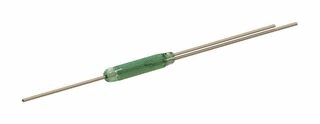

  • Reed Switches Product LinkProduct Link(note these are sourced only through the UK with a freight fee)

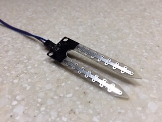

  • Moisture Sensors

REED SWITCHES
Reed switches will either close or open a circuit when a magnet is nearby.  This allows for non contact switching.  However, they are still mechanical inside, so if you have fast switching such as to track wheel speed, use a Hal Effect Sensor instead.  For our purposes, we just want to know if a window or door has opened, so a reed switch is the perfect device.
When I buy reed switches, I typically get the style that has a Normally Open or Normally Closed option.  It doesn't add much to it and allows for flexibility.  We will use a Normally Open reed in our window/door open detector.  This will trigger a power latching circuit on an ESP8266 to ensure it boots up and sends our brain box a signal.  Here is the circuit:
The code is the same as that of limit switches.

MOISTURE SENSORS
A water pipe or hot water tank rupture can result in thousands of dollars of damage.  If you are at work, having a 3/4" supply pipe gushing for hours will definitely make a memory.  So, having a moisture sensor in key locations of the home are a great upgrade.  They can actuate a shutoff valve to cut the water supply.
Moisture Sensors are a simpl device you simply lay on the lowest spot at the location of interest.  For a hot water tank, a good spot would be by the relief valve discharge.
For our sensor, we will use the readily available hygrometers you often see for alerting when to water you plants.  In our case, we'll trigger when we detect water.
Here is some simple code for detecting a water leak for an Arduino or ESP8266:
const int hygrometer = A0;  //Hygrometer sensor analog pin output at pin A0 of Arduino
int value;
void setup(){
    Serial.begin(9600);
void loop(){
  value = analogRead(hygrometer);   //Read analog value
  value = constrain(value,400,1023);  //Keep the ranges!
  value = map(value,400,1023,100,0);  //Map value : 400 will be 100 and 1023 will be 0
  Serial.print("<10 Means Water is detected: ");
  Serial.print(value);
  Serial.println();
  delay(2000); //pause for 2 seconds
