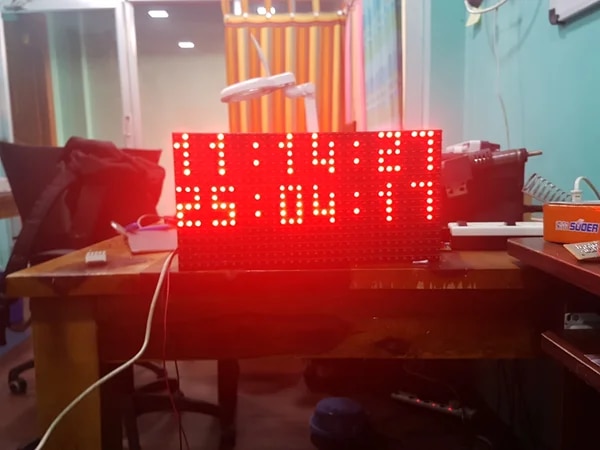

Real-time clock using DS3231 and p10 Display Matrix
This project demonstrates the use of electronics and embedded systems with Clock. Dot-matrix Display or more commonly referred to as Free Running Text is often found in shops as a means of advertising their products, it is practical and flexible in its use that encourages business actors to use it as advertising advice. Now the use of Dot-matrix Display has spread, not just as advertiser media only, as well as prayer schedules, warning boards, queuing machines, etc. Here, we will give a post about how I made a clock using p10 Matrix Display and DS3231 RTC using Arduino.

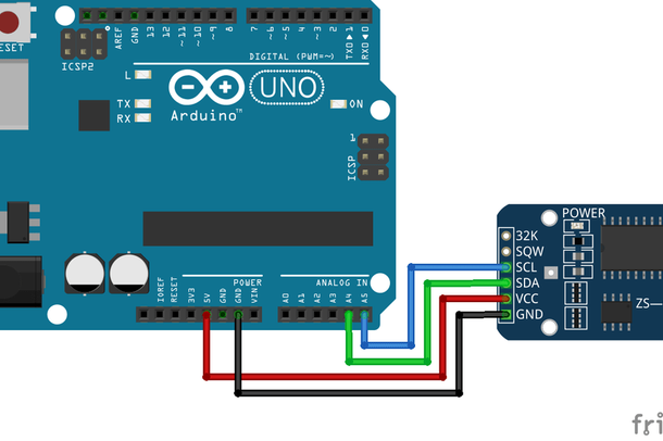

Step 2: Connections
*Arduino -> RTC MODULE*
  • A4-> SDA
  • A5-> SCL
  • VCC -> 5V
  • GND -> GND

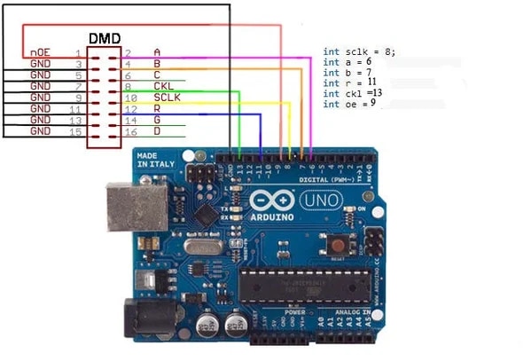

*Arduino -> P10 DMD*
  • D8-> SCK
  • D6-> A
  • D7-> B
  • D11 -> R
  • D13-> CLK
  • D9-> OE

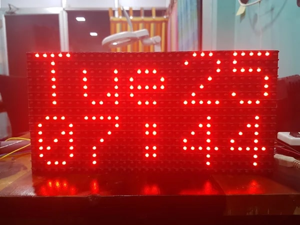

Working of This Project: Simple Clock
Working of This Project: Clock With Settings

    dubbie over 5 years ago +1
    Looks a nic complete clock. How much power does it take? Dubbie

  • shanchya
    shanchya over 5 years ago in reply to rahulkhanna
    Nice project, but could you please gives us a diagram where to put the Push-button (Keypad) x 4 ?
  • rahulkhanna
    rahulkhanna over 5 years ago in reply to dubbie
    Hi,
    The entire setup consumes 20W-22W.
