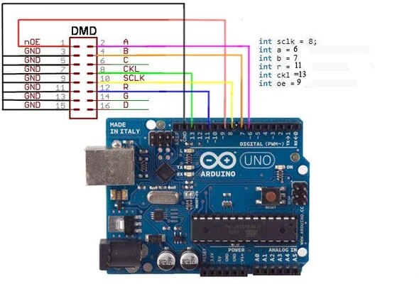

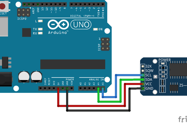

Step 2: Connections
*Arduino -> RTC MODULE*
  • A4-> SDA
  • A5-> SCL
  • VCC -> 5V
  • GND -> GND
*Arduino -> P10 DMD*
  • D8-> SCK
  • D6-> A
  • D7-> B
  • D11 -> R
  • D13-> CLK
  • D9-> OE

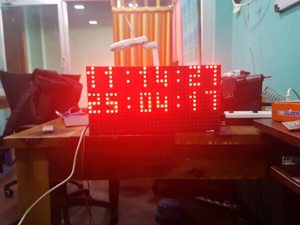

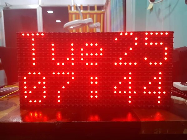

Working of This Project: Simple Clock
Working of This Project: Clock With Settings
