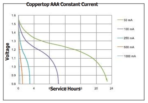

The next step was to pull the actual data sheet for the battery. I was running a Duracell AAA, model MN2400MN2400 Alkaline battery. Here is the datasheet.
According to this chart, a 1.5V AAA cell would really have more like 0.75-0.9 mAh instead of the 1,000 mAh that Google showed me. So a big fail on my part for not looking up the actual specs and trusting a quick google search. If I calculate the total run time of the system, 500 button presses @ 37 seconds works out to 308 minutes of run time; or 5.13 hours. If we look at the graph of current usage for my application, it looks like I fall between 100 and 250 mA. So that would probably land me right smack where I should be for a load of about 200mAh. Another calculation mistake I had done was adding the current for each battery. However since they were in series instead of parallel, that shouldn't have been done.
