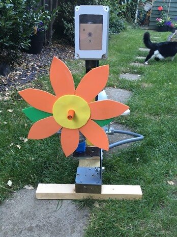

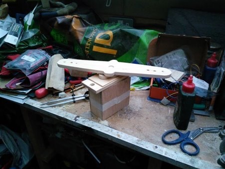

I was building a big project and wanted to move the nozzle of a squirting flower, and the only servos I had were micro servos which did not have enough power to move the mechanism, so I decided to build something, a Jumbo Servo.

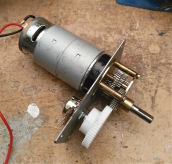

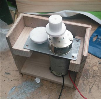

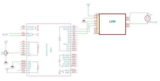

As mentioned in Motor Drive Control for Makers  a servo consists of a motor with some kind of position feedback and a control circuit. I decided that a potentiometer and an arduino should be capable of this. I found a 12v gearbox motor in the spares drawer and after a little cleaning and lubrication got that running. There was a gear on the output shaft that could be used for driving a the potentiometer. I added a mounting plate and determined where I could add a potentiometer. A 3D printed gear was added to slip onto the pot and mesh with the output gear. Also something to drive the motor would be needed and I had a suitable L298 H-Bridge module which fitted the spec.

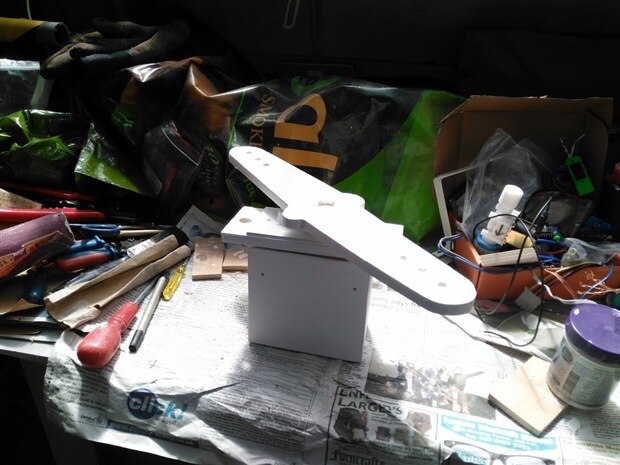

So that my jumbo servo would look the part, I made a wooden case and wooden servo horn. A 3D printed output shaft was also added.

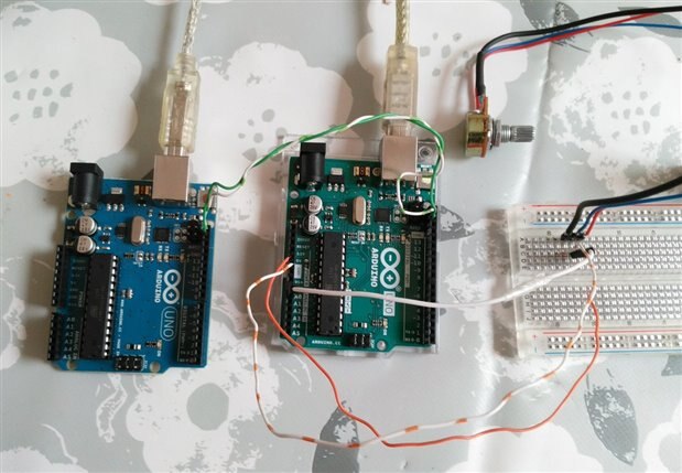

Next up was the electronics. I decided to go with I2C for communication rather than the analogue PWM which is typically used by a servo. This allows me to stop the motor when the servo has reached it's destination rather than constantly seeking position, it also means that I can read back the position to the controlling software and avoid that twitch you get when you first power on a servo.
To test this I used two arduinos and used the examples from Arduino to work out what code was needed. Because I was using a long cable (for I2C at least) I added some low value pullups on the servo end.
Here's my first draft of the code.

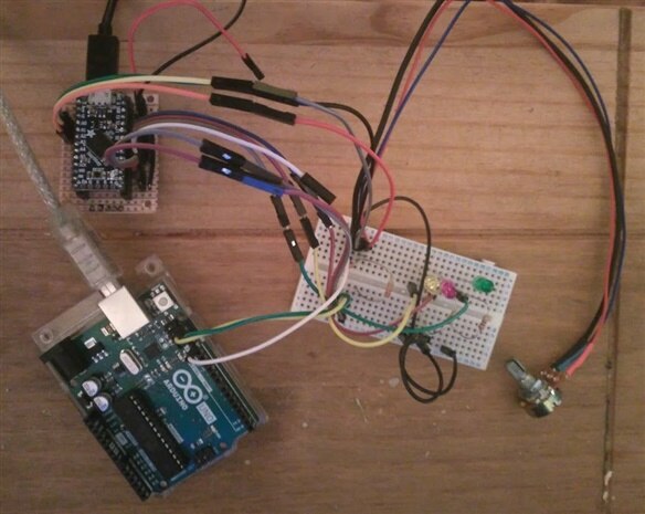

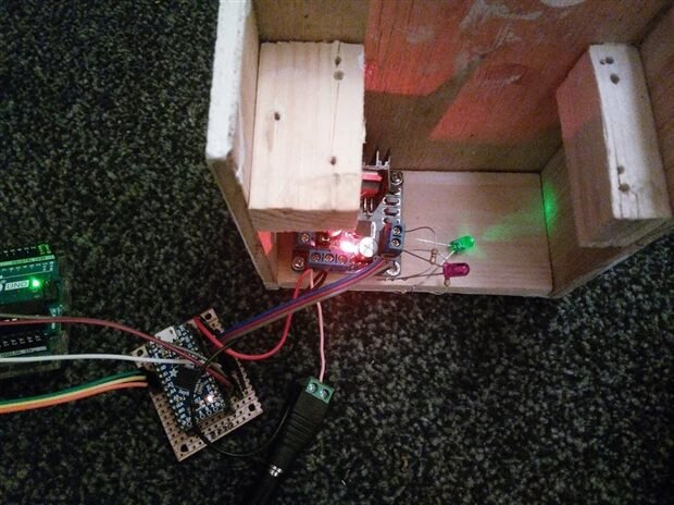

I've got myself an AdaFruit "ItsyBitsy" which is basically a small form factor Arduino Leonado. So the next step is to wire this in, instead of the Arduino.
I'll also need to do some simple calibration to turn the 0-1023 value into a degrees value. Because of the gearing on the pot the servo can do a bit more than 180 degress so I should be able to set it up with a safe limit so I don't over drive the pot.
Have added a breakout board for the ItsyBity and completed some further testing with some LEDs in place of the H-Bridge,
I then did some testing with the H-Bridge. I used back to back LEDs to check that the circuit was wired correctly and the software was working. After a few loose connections I got that working. However, swapping the motor in caused my 2A PSU to shutdown.
So I plugged these into the bench power supply (thanks again Secret Santa) and set the voltage and current limit. Luckily I happened to have a slightly smaller motor that had the same size shaft and screw holes that took a lot less current. Next up I'll swap that in.

    jw0752 over 8 years ago +6
    Hi Andy, Really cool build. I like how you even went for the visual and made it look like a micro servo. John

    Hi Dean, I'm afraid the project got decomissioned at the end of last year as it was taking up too much space in the shed.  It did not spray particularly far so I'd suggest connecting it to a hose rather than a sprayer if you want maximum fun.
    You can read more about how it was made at https://hackspace.raspberrypi.org/issues/9
    I was also hoping that the BCS would publish the video of my servo demo but that seems to have got lost so I'll see if I can record one of the servo and control panel in action.

    If you could add a 'shield' around the shaft to deflect water away from the shaft, it would stop direct ingress.
    The environmental issues might be tackled with the housing or sealing the pot itself.
    Eventually there will be an impact.
    The Snow Groomer use wire wound pots for the steering and drive speed adjustment. I guess they figure that the use is high and any moisture effects will be null.
