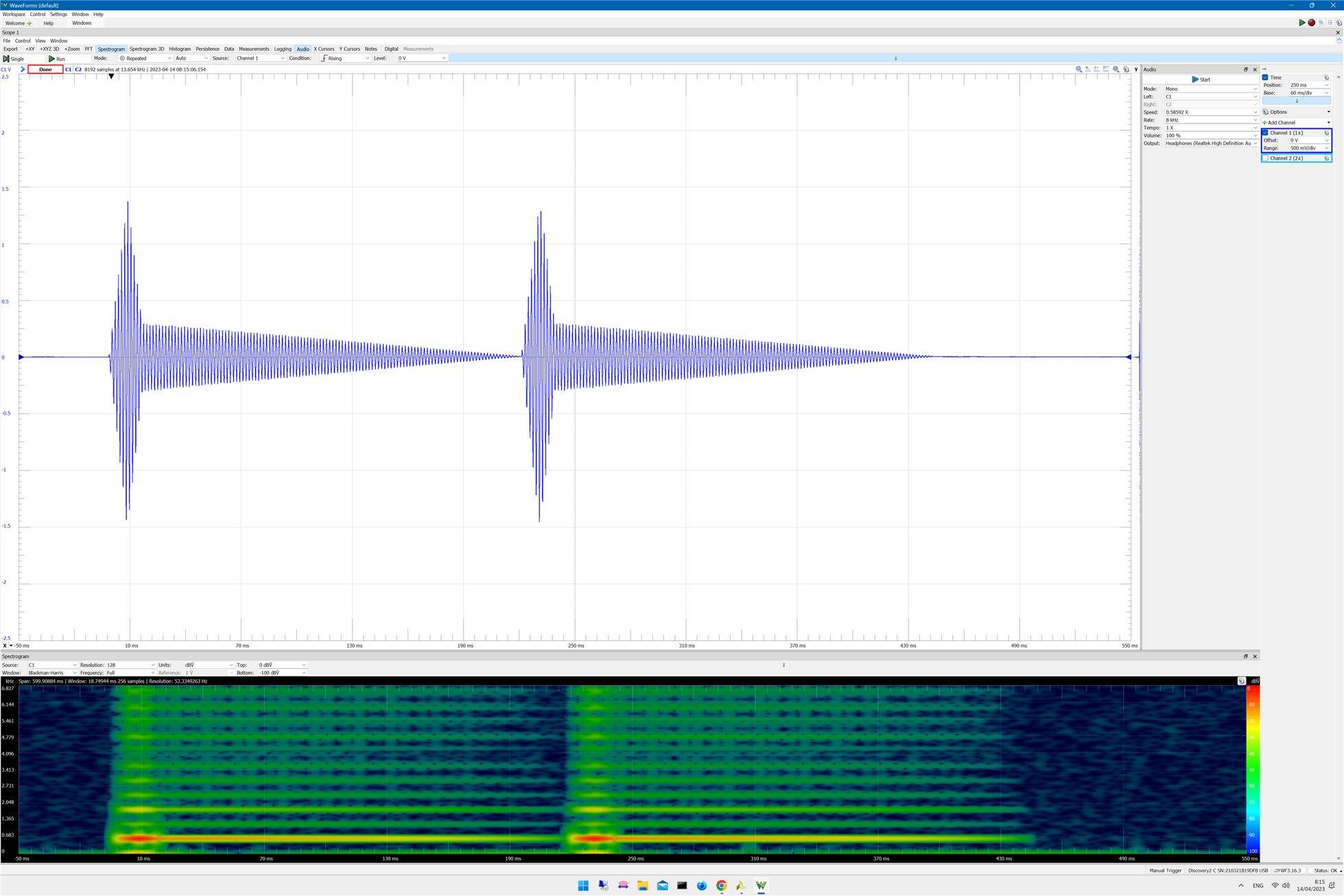

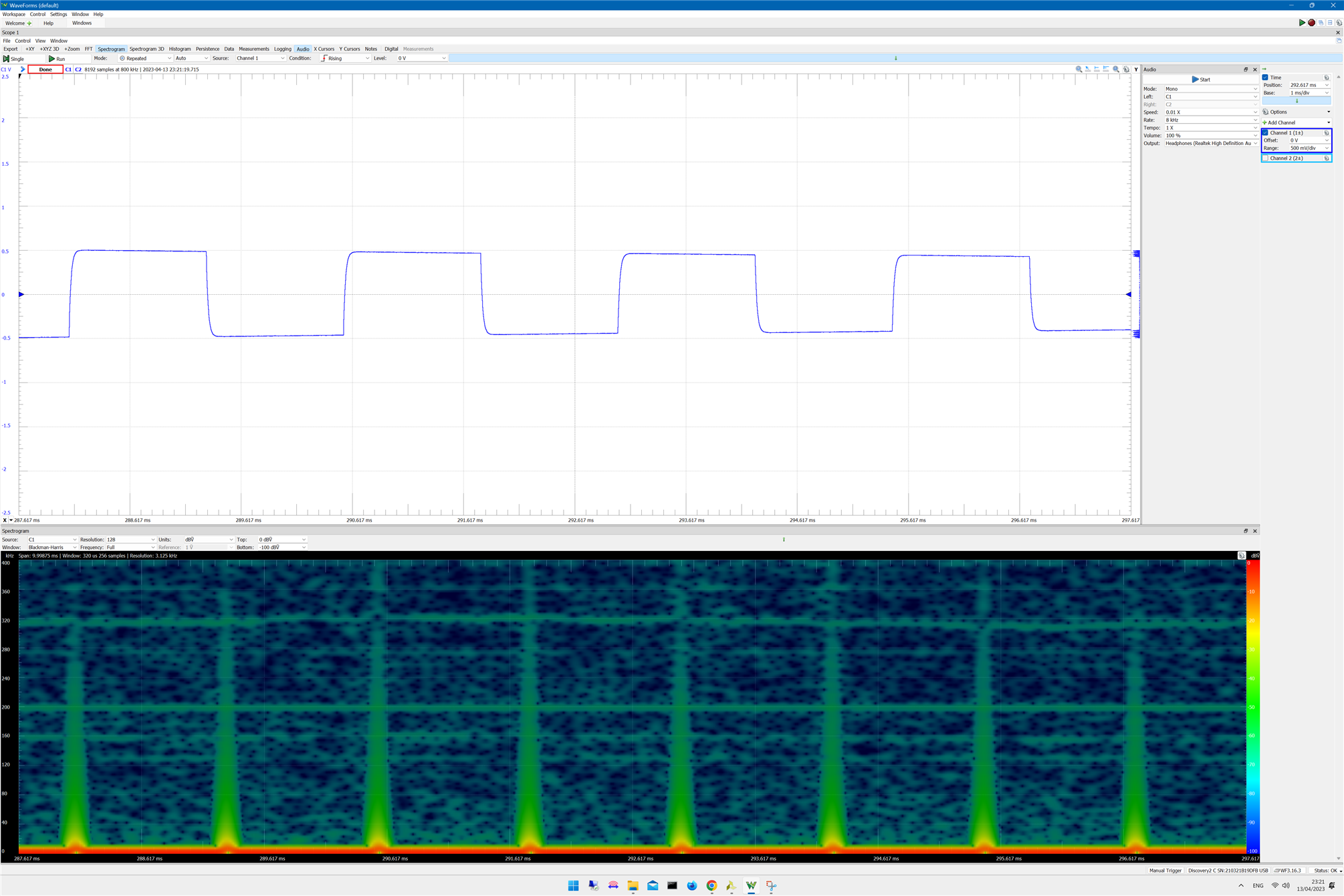

This system designed as a test bed for the synthesis of musical instruments based on FPGA is closely linked to the concept of "musical time". Timing plays a critical role in the precise generation and synchronization of waveforms, to ensure that musical notes are played at the right time and in precise pitch.
By using the Direct Digital Synthesis (DDFS) technique, digital waveform data points are generated and converted to analog signals, which are then filtered and shaped to produce an audio output.

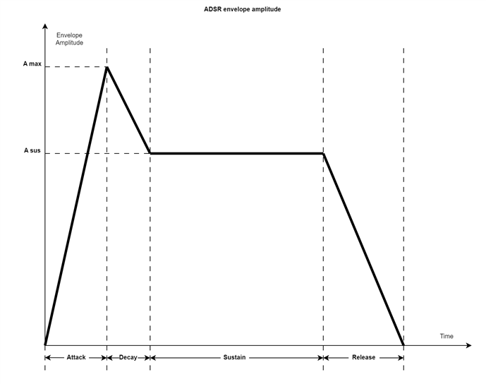

Additionally, the system uses techniques such as an ADSR envelope generator to shape sound waves over time, allowing for dynamic and expressive musical sounds, allowing something close to the sound of real instruments to be mimicked.
The synchronization of waveforms and effects within the FPGA enables the creation of complex audio effects or multi-timbral musical instruments, further reinforcing the close relationship between the system design and the concept of "music time".

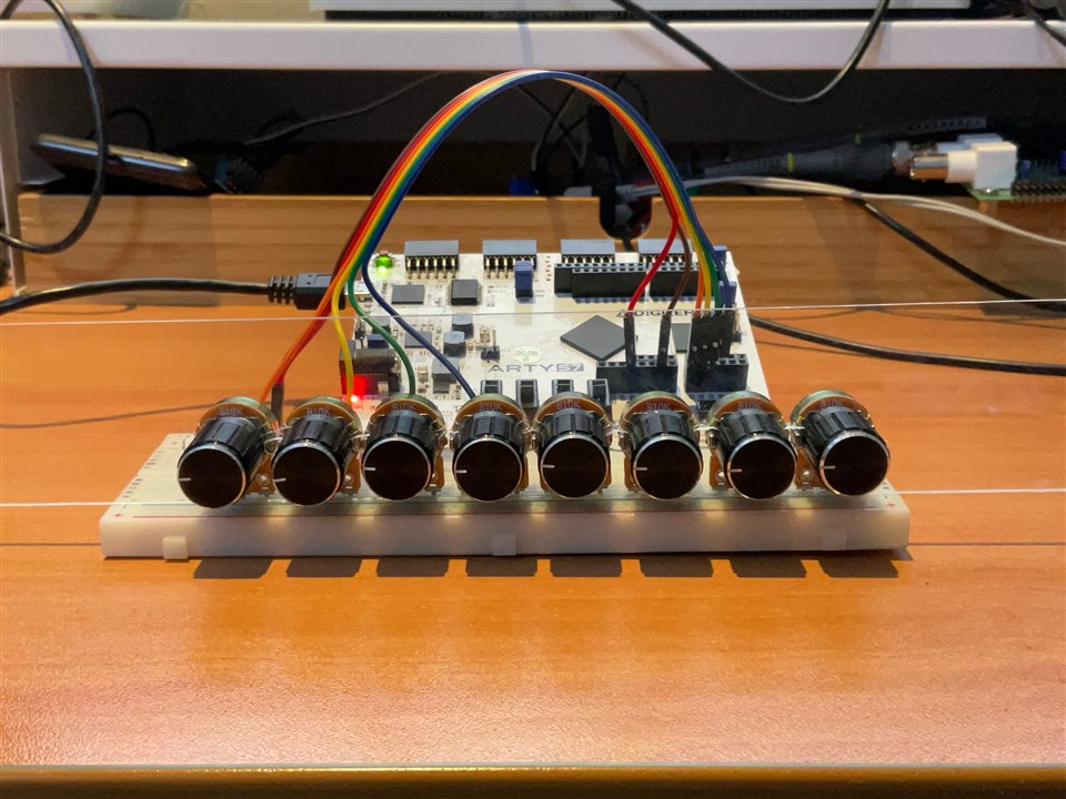

The system is based on the Digilent Arty S7 50  development board, which features an AMD Spartan-7 FPGA. It incorporates a simple RC low-pass filter and utilizes six potentiometers for parameter control. The readings from the potentiometers are captured using the XADC component from the series 7 FPGA, allowing control over the audio synthesis parameters. The audio output is connected to an amplified speaker, allowing for the synthesized sounds to be heard in real-time with amplified volume.
User interface
The user interface of the system consists of four buttons for selecting different notes, four slide switches for changing the octave, and six analog potentiometers for adjusting various parameters, including the ADSR parameters such as attack time, decay time, sustain level, sustain time, and release time, as well as the waveform type (such as sine, square, sawtooth, triangle, and random noise). This interface allows for control over the synthesized sounds, enabling users to shape the sound and create different musical effects.
6 analog potentiometers to control sound parameters

ADSR module
The ADSR scheme is based on the observation that when a real instrument generates a note, the volume of the musical note changes over time. It rises rapidly from zero and then steadily decays.
The ADSR scheme is based on the observation that when a real instrument generates a note, the volume of the musical note changes over time. It rises rapidly from zero and then steadily decays. To model this effect we can multiply the constant tone produced by the DDFS module by an amplitude ADSR envelope that contains the segments, attack, decay, sustain and release
ADSR envelope
See: (+) SystemVerilog Study Notes. FPGA ADSR envelope generator for sound synthesis (I) - Blog - FPGA - element14 Community for more info about this module
The ADRS envelope can be specified by two amplitude parameters, A max and Asus, and four time parameters, Attack time, Decay time, Sustain time and Release time.
  • A max: maximum amplitude level the envelope can reach.
  • A sus: the amplitude of the sustain segment.
  • Attack time: the time interval of the Attack segment.
  • Decay time: the time interval of the Decay segment.
  • Sustain time: the time interval of the Sustain segment.
  • Release time: the time interval of the Release segment.

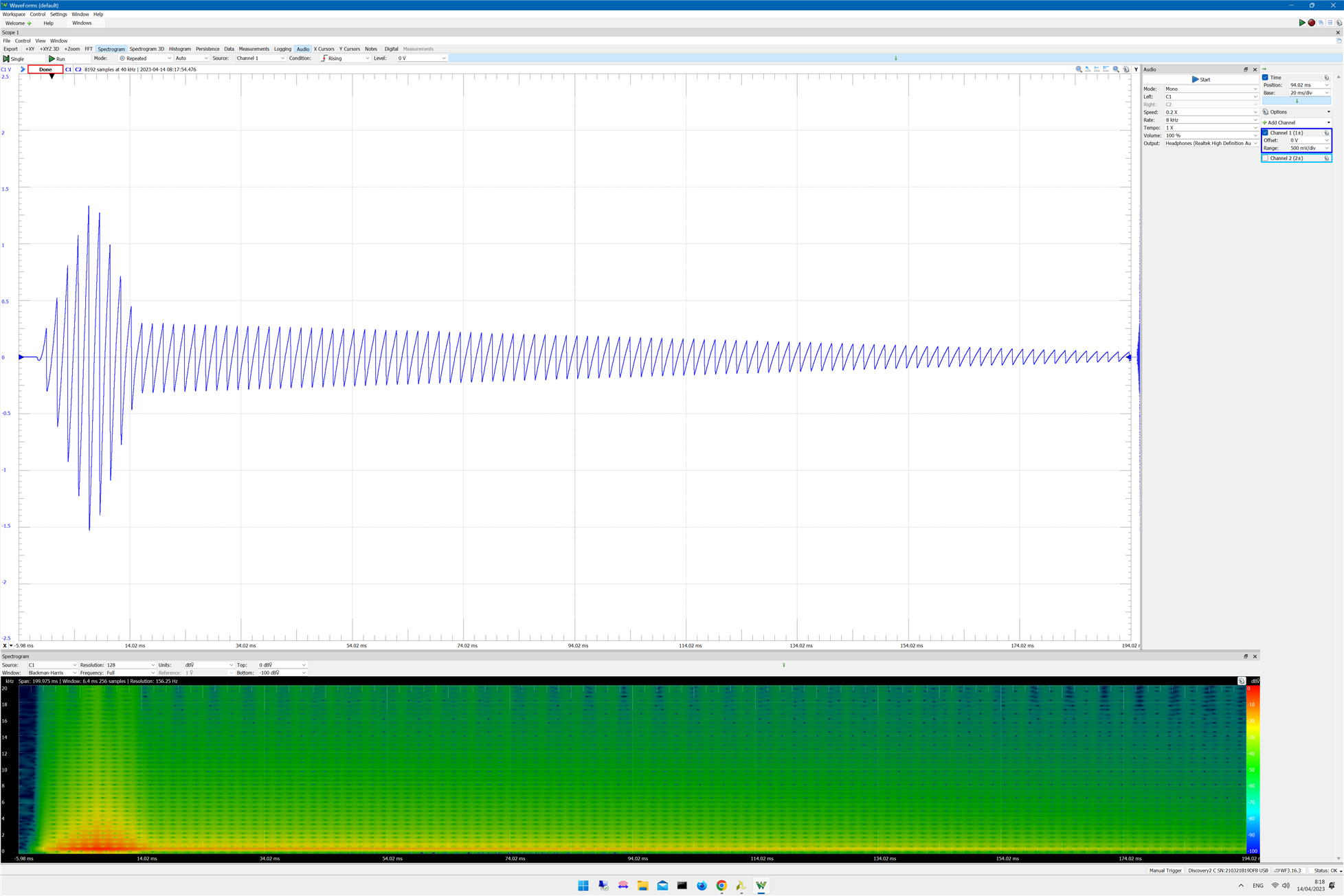

Test Bench: Synthesis Simulation in VIvado
Waveform and spectrogram using noise as source
Noise Generator
Zoomed view

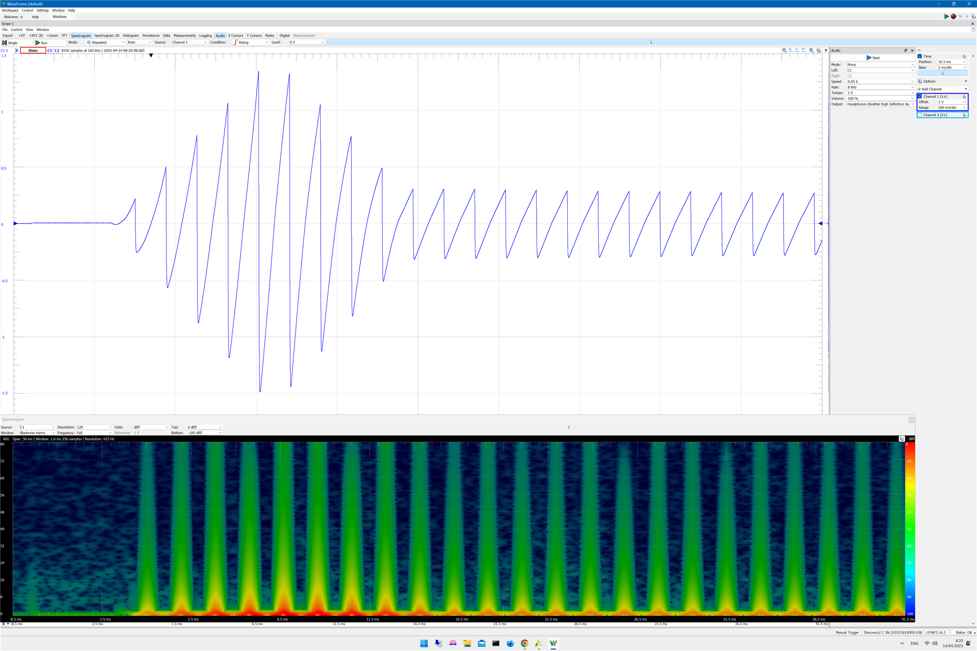

Triangle Wave Generator
Zoomed view:

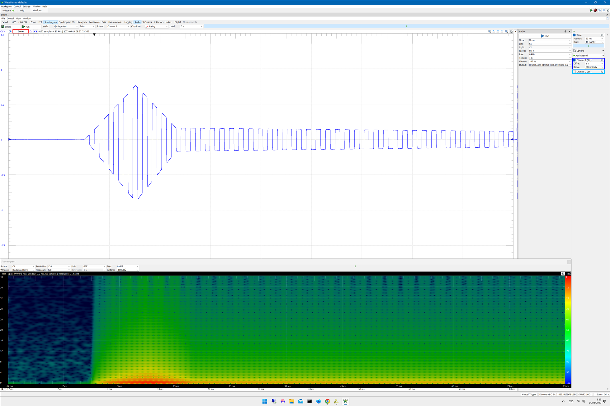

Waveform and spectrogram using one square module as source
Square wave generator
Zoomed view

XADC Sequencer Mode
The reading of the potentiometers to control the attack time, the decay time, the sustain amplitude value, the sustain time and the release time of the ADSR module as well as the type of wave to be generated is done with the XADC module of the AMD Spartan 7 FPGA configured in sequencer mode, gives us the readings of the six potentiometers in sequence. See the ILA capture, when the ready signal is asserted we can read the value corresponding to the active sequence channel.
