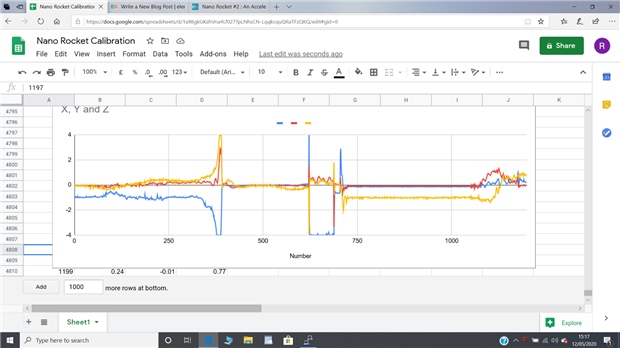

Armed with this calibration data I decided to throw the rocket straight upwards so that only the Y value should show any acceleration and X and Z should be constant at 0.0. Let's see if this is correct and that I am able to throw the rocket directly upwards. So, time for some tea and a sit outside in the sunshine, then some throwing!
A few technical issues intervened in the sitting in the sun, drinking tea, collecting data scenario: it was nearly lunch time so I went without the tea, plus the sun went in so there was no sitting. Also, perhaps more importantly, because I was throwing the rocket directly upwards, or mostly directly upwards, it meant it came almost directly down and as I have mowed the lawn, there was very little buffering and the rocket hit quite hard, causing a power reset. After some additional packaging and repeated attempts I managed to obtain the following data.
It still looks confusing but I started the rocket pointing directly upwards in order to obtain the -1.0 (approximately) on the X trace, as seen in the previous calibration traces. I then threw the rocket as directly upwards as I could manage, indicate by the spikes at sample number 325 (approx.). At this point there is no force acting on the rocket so all traces show 0. At sample number 625 (approx.) the rocket hits the ground and there is a considerable deacceleration period, possibly due to the casing flexing as it absorbs the force of impact, followed by some further rapid accel/de-accel periods as the rocket bounced into the flower bed. There is then  a long static period and then some further variations as I picked up the rocket.
As it is rather confusing having all three traces plotted together, I have just plotted the X trace on it's own and the process outlined above becomes much clearer.
I am not quite convinced that I fully understand what is happening as I would expect to see acceleration due to gravity in the period between launch and hitting the ground, but perhaps that is due to a flaw in my understanding of how gravity works or the sensor does not detect gravity when in free flight.

    Your confusion is normal because, despite their name, accelerometers don't measure the motion of acceleration. Usually, they measure the force required to prevent a known mass from moving in its housing…

    "... or the sensor does not detect gravity when in free flight..." Or rather in free fall there is no measured displacement of the mass within the sensor itself ? I think some of the confusion might arise…

    I did physics at school and am OK with the concepts of acceleration, just about, but I'm still struggling to understand why the sensor doesn't show any deacceleration or acceleration when in flight. There is acceleration when I throw the rocket upwards but then the sensor doesn't shown anything until it hits the ground, but the rocket must be slowing down (deaccelerating until it reaches it peak (zero velocity) and then speeds up (accelerating due to gravity) as it starts to fall down. Is it the sensor or my brain that is not registering?
    Usually, they measure the force required to prevent a known mass from moving in its housing.
    Since F=MA if you know the force and the mass you can deduce the acceleration.
    When the accelerometer is in free fall, there is no force required to stop the mass moving in its housing. Both the housing and the mass are accelerating at the same rate.
    When sitting stationary, the housing must exert a force (equal to the weight of the mass) to prevent the mass from accelerating toward the earth. This causes the accelerometer to read 1 g (vertical) when at rest, even though it is not accelerating at all.
    When you launch the device, the accelerometer measures the force you apply and outputs acceleration as A=F/M.

    Think of how the sensor actually works. Basically a mass suspended inside the sensor housing by a spring type arrangement. In order to get a reading, the mass needs to be displaced in relation to the housing.
    In freefall however gravity is acting on the mass and the housing equally so there is no displacement taking place so a zero reading.
    The velocity of the mass and the velocity of the housing is the same until another force acts on the  housing. The sensor housing is attached to the rocket, so when the rocket hits the ground, the velocity of the housing almost instantly decreases to zero but the mass inside keeps going and you end up with a displacement which is measured. A change in velocity over time is what gives you the acceleration.

    Yes, there are other forces involved that affect what the accelerometer records verses why you think it records.
    Think of it more as an impact sensor, not a relative sensor. Your brain is telling you that you should see readings of it going up and going down. If it was a powered vehicle, you might see some of that, but as a toss up and come down vehicle, all you should see is the initial push up and then the impact as it comes down.
    You have to look at the whole event through the view of the sensor. It is not an IMU, where it keeps track of position, velocity and acceleration. It is looking for specific events where the sensor is shaken or moved. While the vehicle is in motion, there are no sensor events. As the vehicle drifts upwards from your initial impulse, the sensor sees a very benign environment, which is why you data does not show much. The next big event the sensor sees is when you catch it or it hits the ground.
    I hope my little discussion here helps you better understand what you should expect to see.

    This is very helpful. So I should probably have used the IMU data rather than the accelerometer data. I might have a go at this, sometime. At the moment my brain still hurts. Electronics seems so much easier than mechanical stuff.
