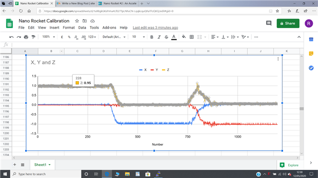

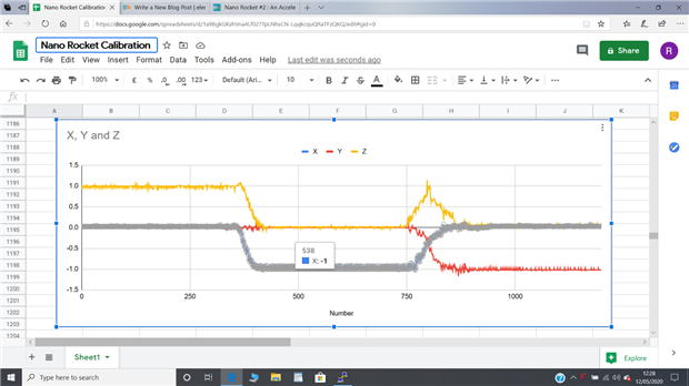

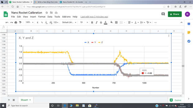

Then, as before, I connected the rocket to a USB - serial converter module and downloaded the data into Putty, and then cut-and-pasted it into Google sheets and obtained the following graphs, showing highlighted X, Y and Z traces.
X Trace Highlighted
Y Trace Highlighted
Z Trace Highlighted
Apart from a little bit of noise which could be vibration from the laptop fan, or other external sources, the only acceleration being applied is that due to gravity, in the downward direction. The output from the accelerometers is 1 g = 1.0 and this can be seen in all three traces. In the X trace the value is zero until the middle third (when the rocket was turned on end) and has a value of -1.0. This would have been +1.0 if I had stood the rocket on the other end but that is rounded and much more difficult to maintain in an upright position. The Y trace also shows a -1.0 in the final third of the graph which is when the rocket was held on it's side. If the other side had been used it would have been +1.0. These first two traces show a simple transition from one orientation to another, but the Z trace shows a much more interesting output. The Z trace in the first third shows a +1.0 value, as gravity is accelerating downwards. At the second reorientation two thirds of the way along there is peak as the rocket is rotated and illustrates an acceleration followed by a deacceleration.

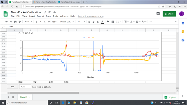

A few technical issues intervened in the sitting in the sun, drinking tea, collecting data scenario: it was nearly lunch time so I went without the tea, plus the sun went in so there was no sitting. Also, perhaps more importantly, because I was throwing the rocket directly upwards, or mostly directly upwards, it meant it came almost directly down and as I have mowed the lawn, there was very little buffering and the rocket hit quite hard, causing a power reset. After some additional packaging and repeated attempts I managed to obtain the following data.
It still looks confusing but I started the rocket pointing directly upwards in order to obtain the -1.0 (approximately) on the X trace, as seen in the previous calibration traces. I then threw the rocket as directly upwards as I could manage, indicate by the spikes at sample number 325 (approx.). At this point there is no force acting on the rocket so all traces show 0. At sample number 625 (approx.) the rocket hits the ground and there is a considerable deacceleration period, possibly due to the casing flexing as it absorbs the force of impact, followed by some further rapid accel/de-accel periods as the rocket bounced into the flower bed. There is then  a long static period and then some further variations as I picked up the rocket.

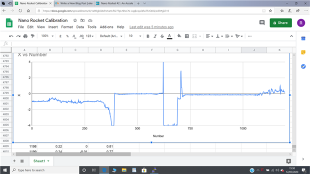

As it is rather confusing having all three traces plotted together, I have just plotted the X trace on it's own and the process outlined above becomes much clearer.
I am not quite convinced that I fully understand what is happening as I would expect to see acceleration due to gravity in the period between launch and hitting the ground, but perhaps that is due to a flaw in my understanding of how gravity works or the sensor does not detect gravity when in free flight.

    Your confusion is normal because, despite their name, accelerometers don't measure the motion of acceleration. Usually, they measure the force required to prevent a known mass from moving in its housing…
    DAB over 6 years ago in reply to dubbie +4
    Yes, there are other forces involved that affect what the accelerometer records verses why you think it records. Think of it more as an impact sensor, not a relative sensor. Your brain is telling you that…

    "... or the sensor does not detect gravity when in free flight..." Or rather in free fall there is no measured displacement of the mass within the sensor itself ? I think some of the confusion might arise…
