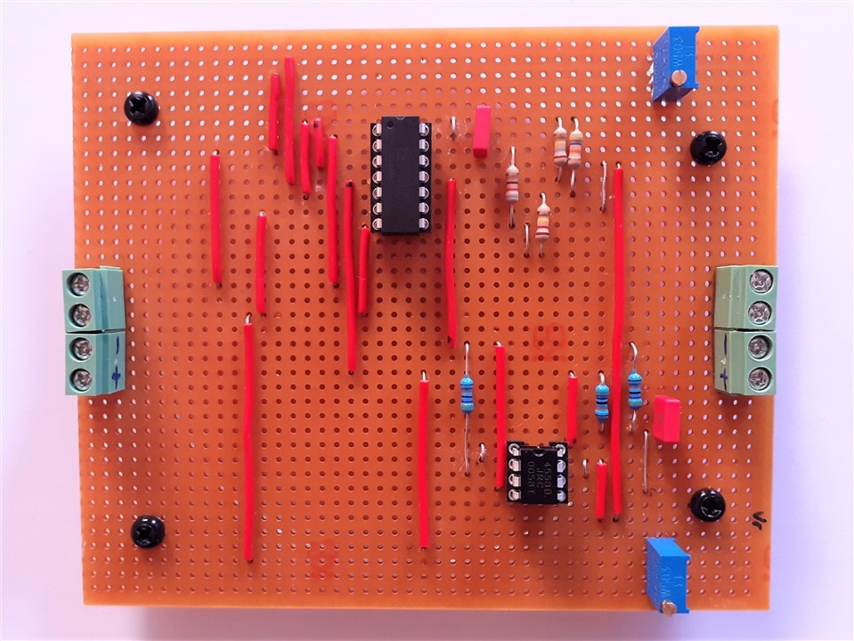

With the help of Fritzing, we tested the layout of the components on the strip prototyping board.
For the prototype we use an Eurocard Prototyping Board , FR2, Epoxy Paper, 1.5mm, 100mm x 160mm, cut so that it does not protrude from the chassis and drilled in 4 places so that it can be fixed to the chassis with standoff spacers.
To cut the tracks that were not supposed to be connected we used a Duratool Track Cutter
This was the end result once the components were soldered to the prototyping board.
The fine adjustment potentiometers are located at the rear, in the most stable area of the robot so that the robot does not swing and change the distance of the sensors to the ground while adjustments are made.
A potentiometer has been placed to the right and another to the left corresponding to the motor on each side and in a position such that turning clockwise decreases the speed of the motor and turning counterclockwise of the clock increases the speed of the corresponding motor.
Top view of the control board.

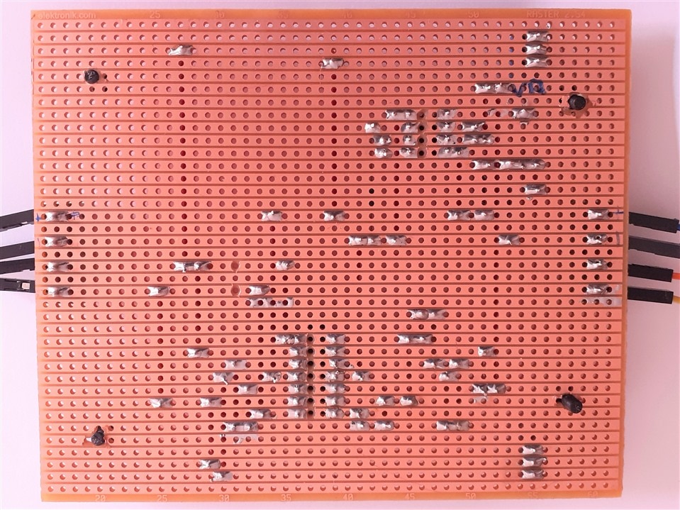

And the back of the board.

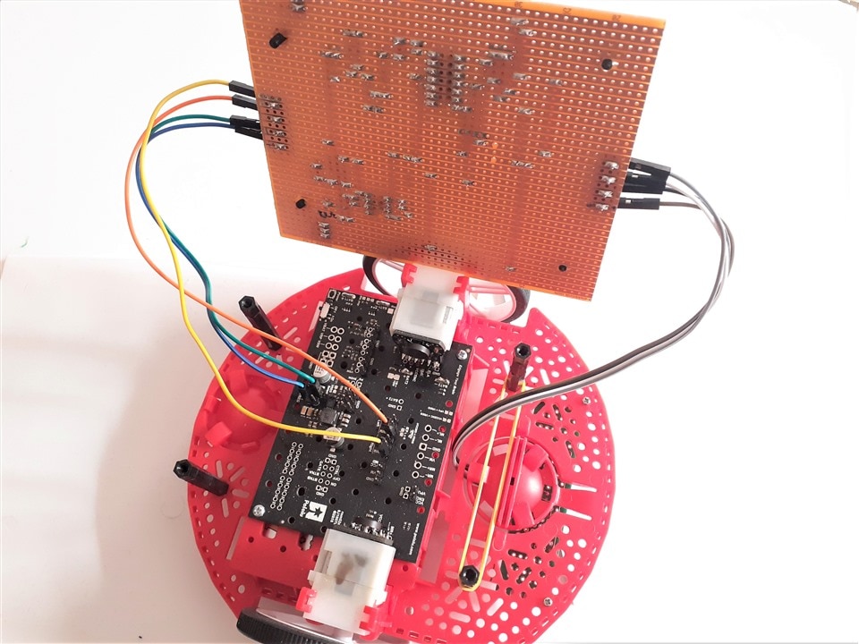

The controller board is connected with Dupont cables to the line sensor and to the the Pololu motor driver and power distribution board.

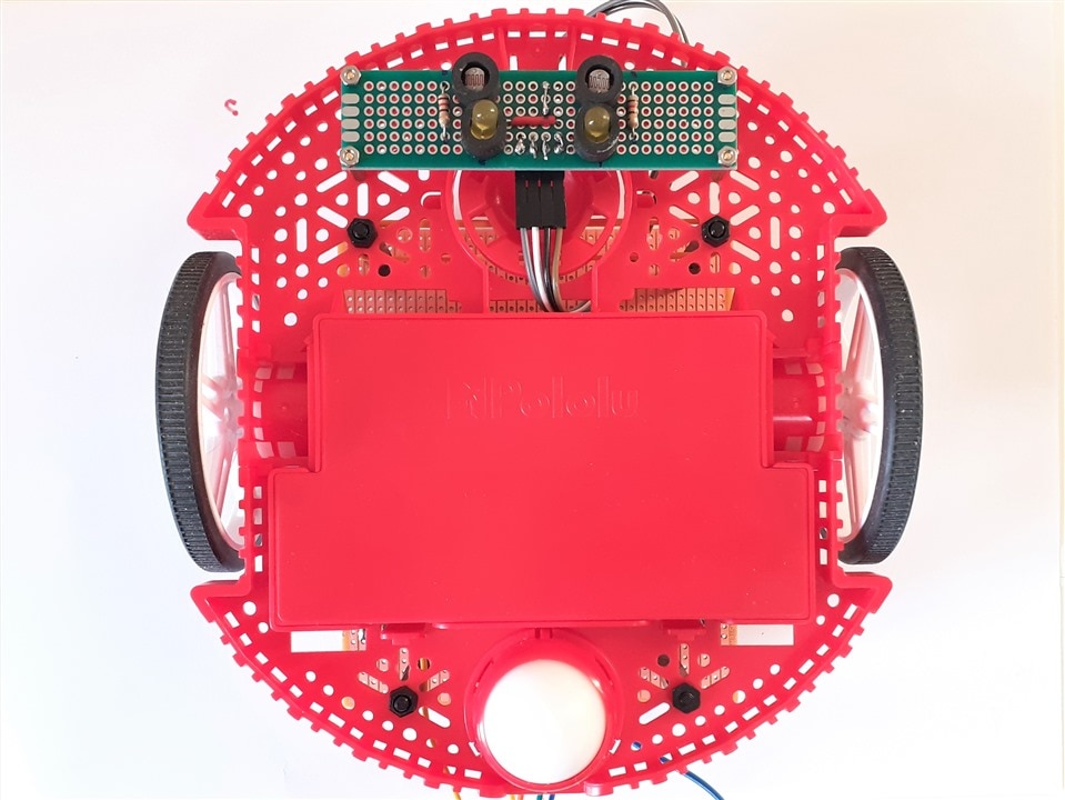

Line sensor board
The line sensor with the two photoresistors and the two yellow LEDs are built on another board.
The line sensor is placed in the lower part of the chassis separated with standoff spacers at a small distance from the surface on which the vehicle is going to navigate. If the surface is not completely smooth, you have to leave more space with the ground.

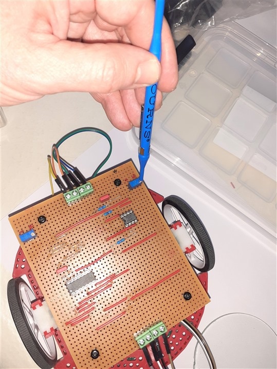

Adjusting sensors sensitivity
Using the two trim-pots you can calibrate the sensitivity of the two sensors. The trim pots form a voltage divider with the photoresistors. You can adjust the input voltage to be between the peaks of the triangle wave. The Trim Pot Adjustment Tool for Bourns Trimmers is very useful for this task. Trim Pot Adjustement Tool
