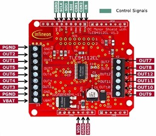

Introducing the TLE94112LE Arduino shield
One of the limits I have experienced with other motor control shields for Arduino (but not only) is that they use the features of the same micro controller (i.e. PWM and other GPIO pins); this means that your board becomes dedicated to these tasks while only a few other resources (MPU and GPIO) are available for other uses. To stay on the same topic of this project many 3D printer controllers based on Arduino clones experience this kind of limits. Having the possibility to put my hands on the TLE94122LE Arduino shield for road testing, the most evident advantage of the IC the board is based on is just its completeness. Arduino board communicates with the board via the SPI protocol using just only two pins (or three if you stack two different TLE94112 shields on the same Arduino). Every command you send to the shield is processed autonomously by the IC without consuming MPU resources. Another remarkable feature of the Infineon board is the possibility to control up to six brushed motors with three programmable PWM channels. This means that Arduino can setup one or more motors, start then continue working on other tasks. This shield revealed perfectly to support up to six different filament rolls at the same time that is just one of the main goals of this project.
Considering the possibility to manage six different filament spools with a single Arduino + shield the micro controller cost impact of every single filament controller less than 5 Euro.

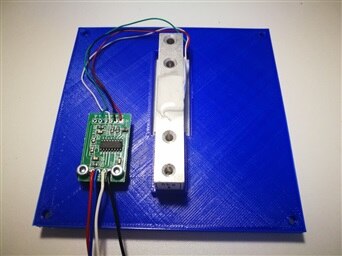

Weight sensor
After doing some experiments in several directions I saw it was possible to control the entire system - monitoring and automatic feeding - with a single sensor; with some experience managing data in the right way a load cell able to dynamically measure the filament spool weight variations can provide all the information we need.
I  used an inexpensive load cell in the range 0-5 Kg (less than 4 Euro) sold together with a small breakout board of the HX711 AD Amplifier, an IC adapt to manage the load cells sensors. There were not interfacing problems as the Arduino library is available on GitHub (HX711).

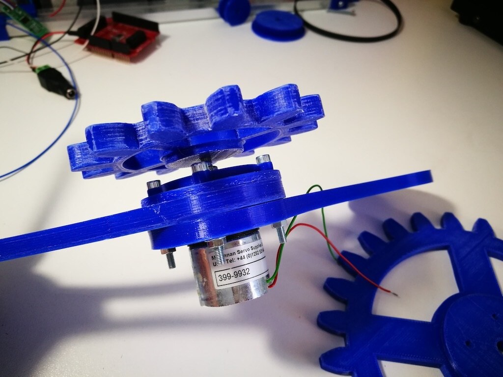

Spool rotation is obtained by a couple of 2:1 demultiplied gears moved by a 280 rpm brushed motor. The motor is a McLennan instrument DC geared motor 90:1 with a rated current of 50 mA and a max no-load current of 20 mA (see the attached datasheet). This brushed geared motor fits the specifications of the TLE94112LE DC motor controller shield.
Obviously also similar characteristics geared motors can be used as well.

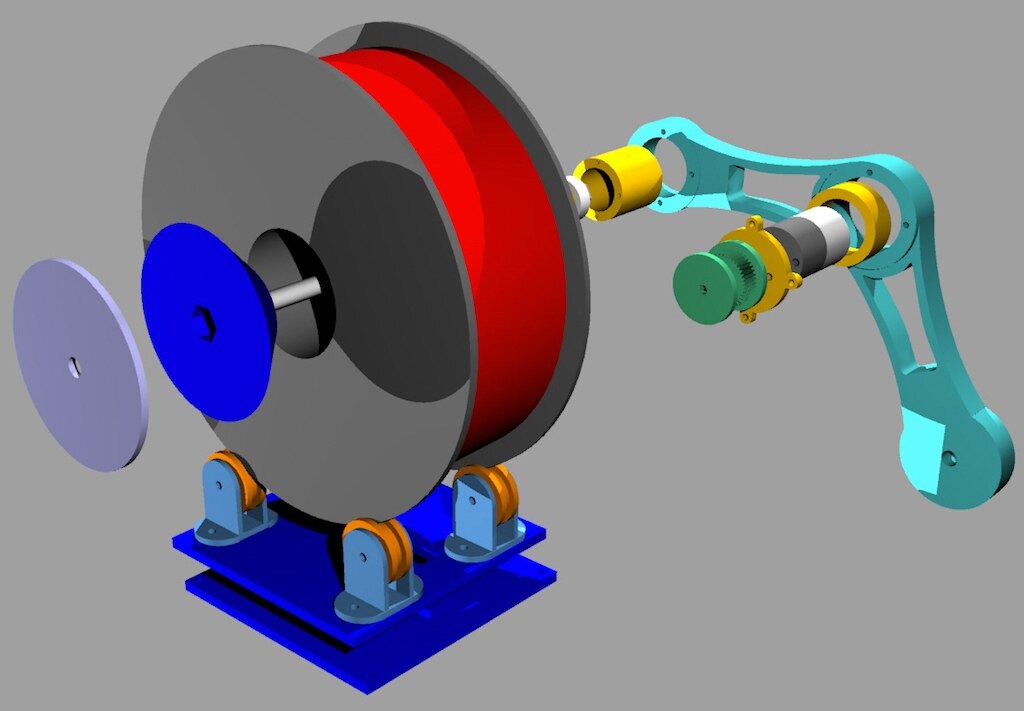

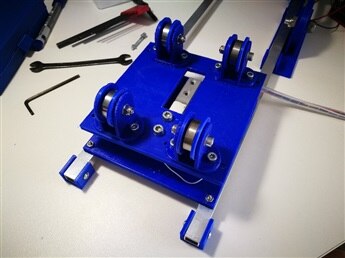

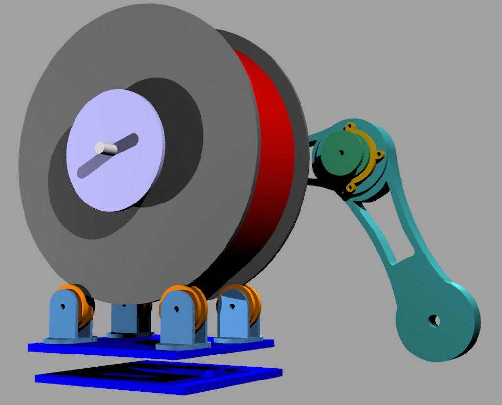

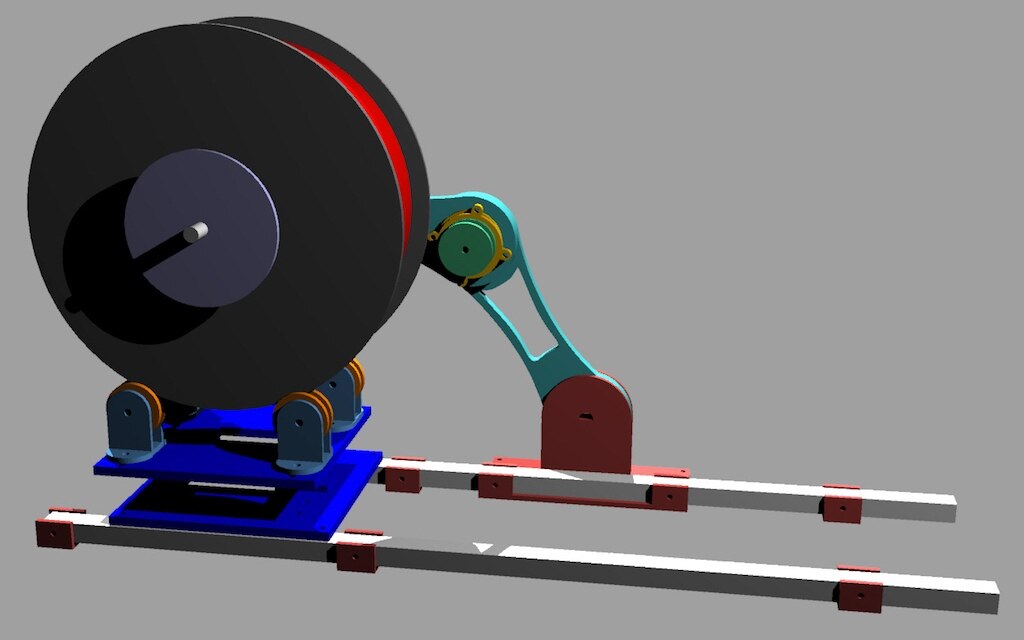

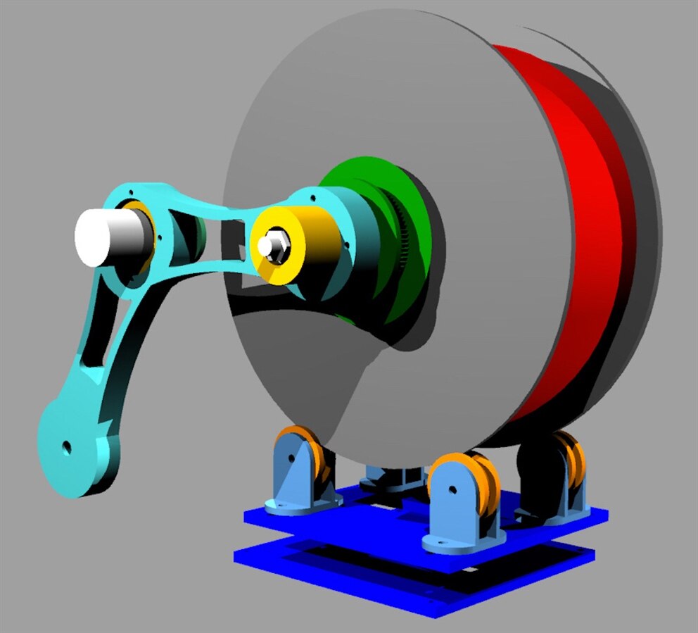

The spool driver is the base where the filament spool rotates free. The weight sensor is the mid support of the two-layers base so the system is able to detect the weight variations in the various conditions.
To avoid as much as possible the friction during rotation I have used four bearings while on the bottom part of the base the HX711 breakout board is fixed with a couple of screws.
Only six wires should be connected to the Arduino shield:
  • 5V and GND (from Arduino) power line for the HX711 IC
  • Two signal lines from the HX711 IC (to Arduino I/O pins 4 and 5)
  • Two power lines from the brushed motor connected to out 1 & 2 of the shield (TLE94112LE power lines)

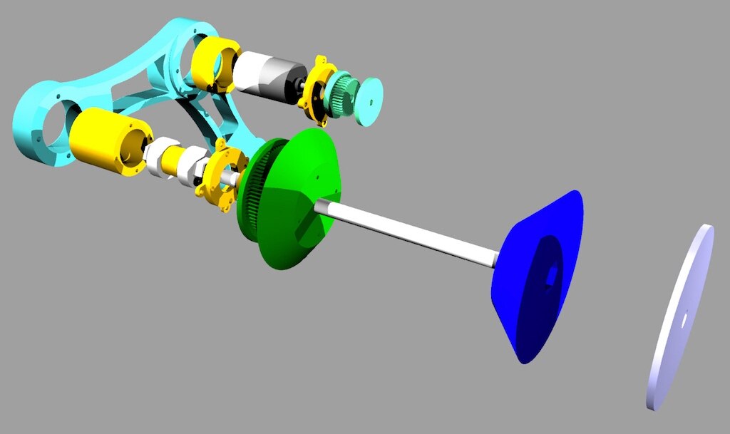

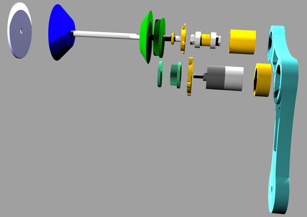

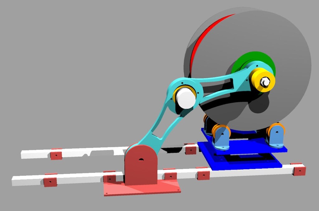

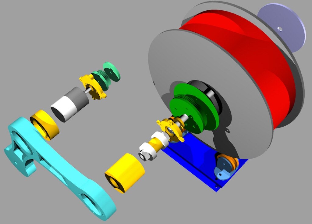

The mechanic design needed two different prototypes. Before seeing in depth the steps I followed there is a short foreword we should say about 3D printing and mechanic design.
When we need 3D printing to build - no matter how complex - moving parts and in general mechanical elements we should always consider that there will be some forces, static of dynamics, that will be applied to the prototype while it is working. Knowing what are the kind of forces applied to our 3D printed structure it is essential to decide important parameters:
  • 3D printing orientation: always reduce as much as possible the extra-material used to create supports while printing, large surfaces grant better adhesion so it is good to place them to the bottom on the printing bed
  • Layer thickness: a too thick layer (i.e. 4 mm) makes printing fast but we loose definition. I always use 2 mm layers that are a good compromise between final quality and printing speed
  • Solid fill density: excluding the first experiments I have done with my first 3D printer, it is very rare I fill objects more than 75% and I strongly suggest never to fill objects less than 15-20% to avoid very crap results.

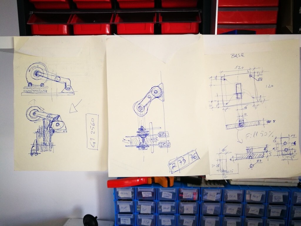

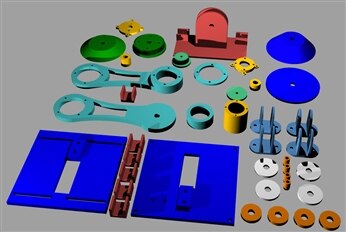

But the first step that can dramatically change the quality and robustness of the resulting 3D printed piece is the CAD design. Designing single objects like cases, puppets, gadgets CAD choices is not influencing too much the final result but when we have many moving parts I consider a must designing compound objects for at least two reasons:
  1. Depending on the role of every part it is possible to decide separately the better fill density
  2. The compound object - just like in this case - can be easily modified and upgraded without impacting the entire structure and reducing the number of elements to reprint

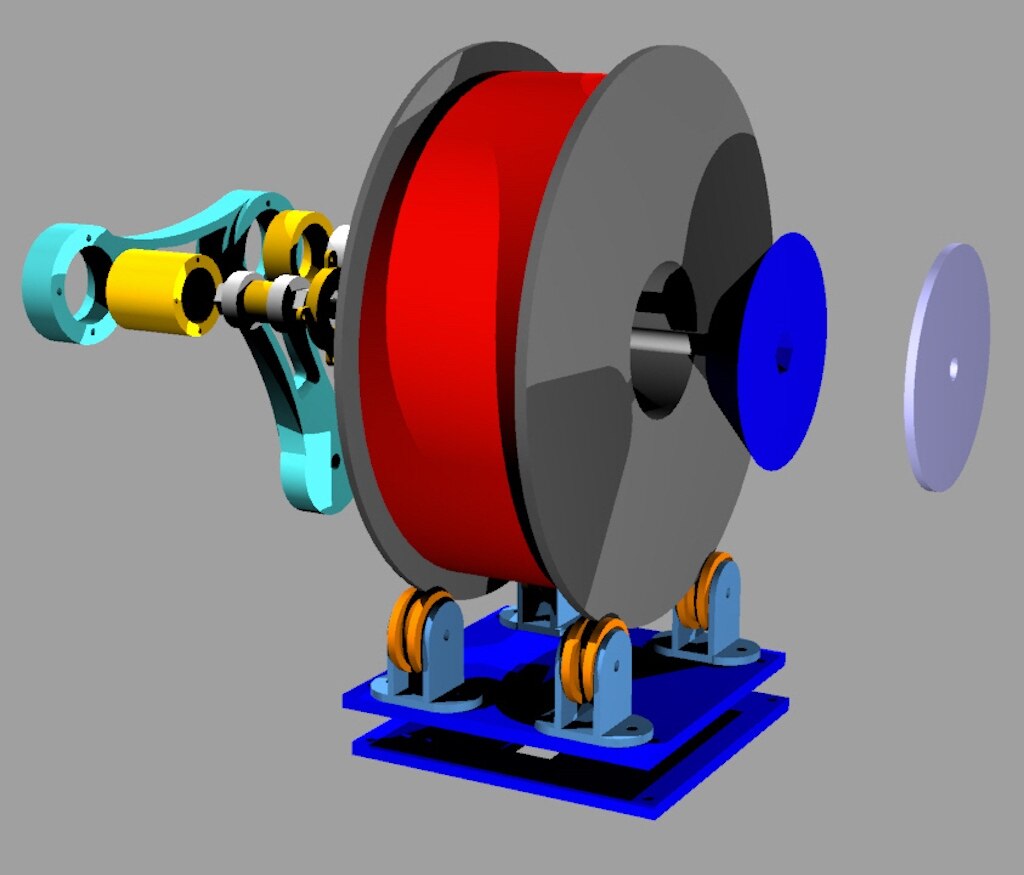

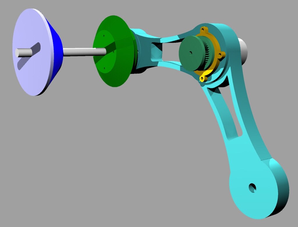

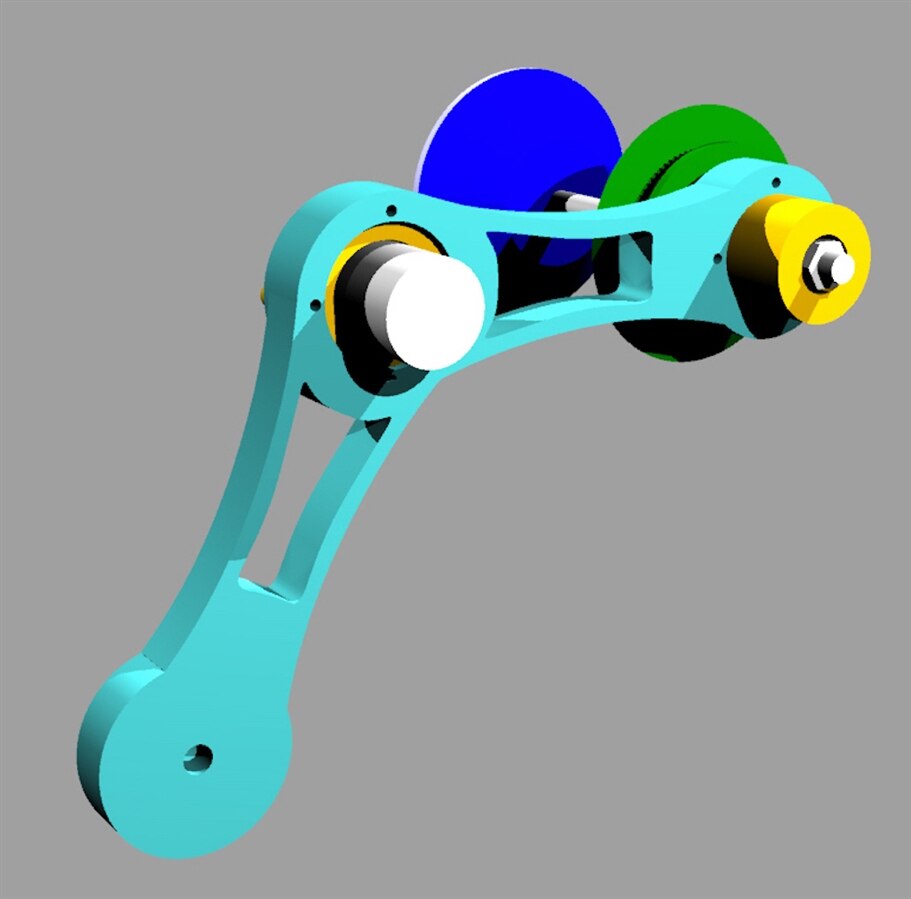

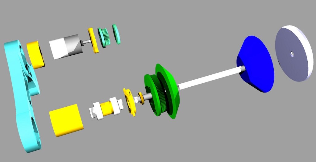

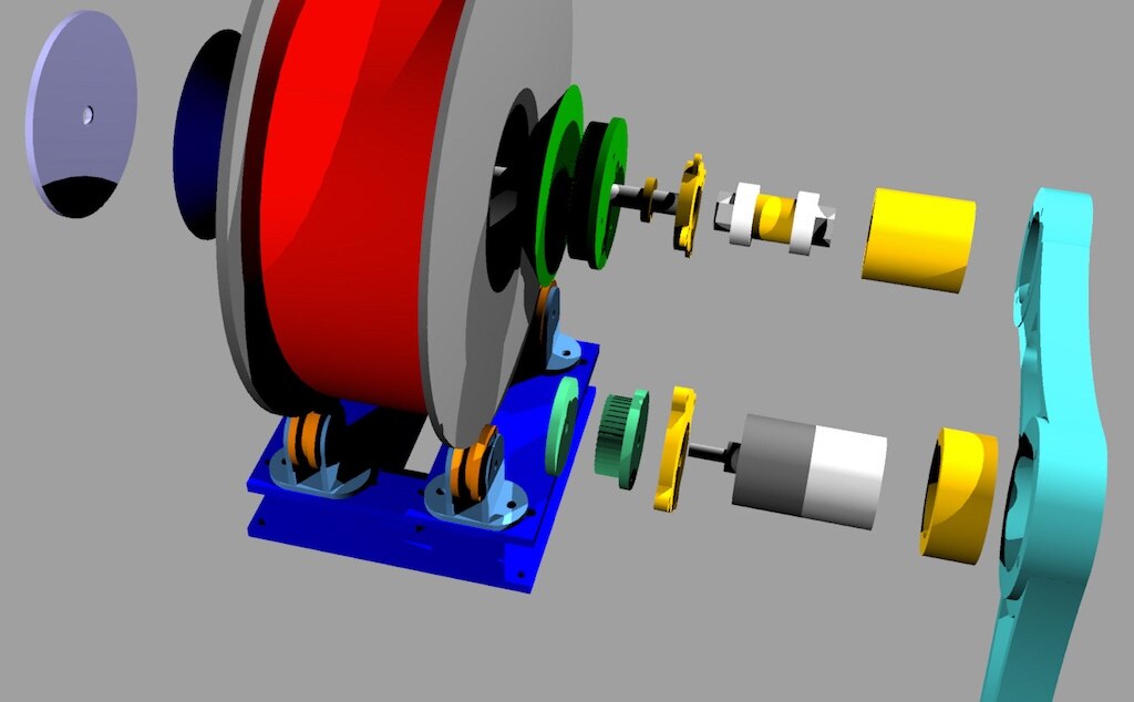

The two images above shows all the parts to be printed from the first prototype design. You can see the two green pulley used to manage the movement; the first idea was using a toothed belt for the transmission but when the prototype was built the solution revealed almost bad. The gallery below illustrated several rendering of the mechanic design before I started 3D printing the parts.
{gallery} Model rendering
IMAGE TITLE: THEN IMAGE DESCRIPTION
After 3D printing then assembling the first prototype the tooth belt transmission was not working well. The tension of the belt required a more robust support than the structure I designed. The rest of the parts instead was working perfectly. As the complete structure was built with different parts it was sufficient to replace the two tooth pulleys with a couple of gears; I had to reprint only these two replacements and the issue was solved.
The video below shows the final solution and the making of refining and assembling the first prototype
