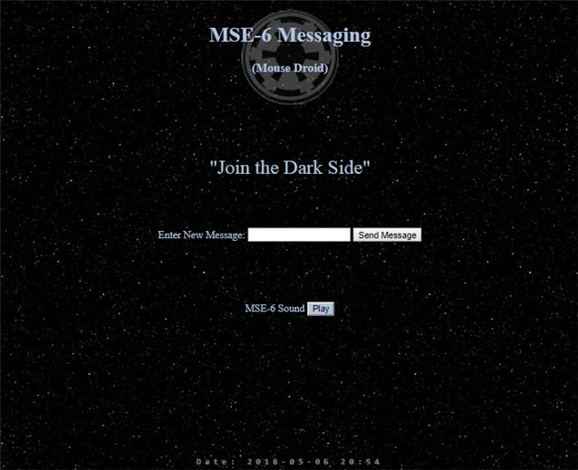

For the MSE-6 Mouse Droid project I'm working I decided to use an Arduino Yun to act as a web-server to host the user interface. My initial idea was to use Node.js or Johnny-Five, however the TFT screen I am using uses pretty much all of the Digital I/O ports on the Yun as well as the Bridge UART Serial1 (Pins 0 and 1 on the Arduino Headers) communication thus I had to seek out another solution. I've used Flask in other projects using a Raspberry Pi so I was concerned that it would not work on the Yun with OpenWRT. But, after getting all of the appropriate libraries in place and tools installed, it works rather nicely. The Yun has been around for something now, thus I will not go in depth as far as the details of the Yun.

I use a script to set-up the Flask environment:
# cat set_flask.sh
#!/bin/ash
echo "Set Exports!"
export APP_CONFIG="config.py"
export FLASK_APP="run.py"
export FLASK_DEBUG=1
The 'config.py' script is used to set-up the Development and Production options as well as set the HOST and PORT values.
# config.py
class Config(object):
 Common configurations
 # Put any configurations here that are common across all environments
class DevelopmentConfig(Config):
 Development configurations
 DEBUG = True
 HOST = '0.0.0.0'
 PORT=5000
class ProductionConfig(Config):
 Production configurations
 DEBUG = False
 HOST = '0.0.0.0'
 PORT=5000
app_config = {
 'development' : DevelopmentConfig,
 'production' : ProductionConfig
A 'run.py' script is used to run the flask instance for the MSE-6 UI
#!/bin/ash

A 'views.py' script is used to GET and POST messages from the MSE-6 webpage and process them via the python bridge and Yun BridgeClient interfaces.

To handle the passingof the message from the MSE-6 webpage to TFT Screeen on the Yun, the 'BridgeClient' 'mailbox' was implemented.

To format the webpage a, CSS stylesheet was used. The format options were placed in a separate folder under 'app/static/styles' and referenced in the HTML file.

The 'index.html' file for processing the MSE-6 page includes a bit of JavaScript to handle changing the Play button's color as well as set the value button element when the button is pressed. This is then passed back to the Python script for processing.
// <br
 function toggleState(item) {
 if(item.className == "on") {
 item.className="off";
 item.value="Stop";
 } else {
 item.className="on";
 item.value="Play";
MSE-6 Messaging
(Mouse Droid)
"Join the Dark Side"
Enter New Message:
Enter New Message:
MSE-6 Sound
class="on" onclick="toggleState(this)" />
Date: {{ time }}
iv>
The end result is the MSE-6 UI page the looks like the following.
The following video shows the webpage and Yun TFT Screen interaction.
ToDo: I plan to add button controls on the MSE-6 webpage to control the MSE-6 remotely.
