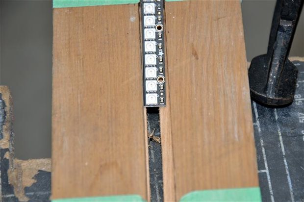

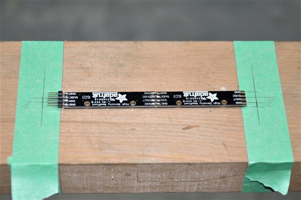

My signs were going to be 100 mm or so, and to get the maximum LED density I used the neopixel strip.
These were soldered together to form a 16 LED strip.

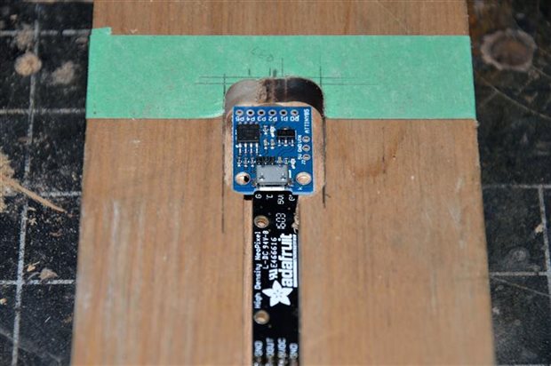

BASE
The illuminated panel slots into a base which hides all the workings.
Once you've decided on the LED's and sign size, you can start making it.

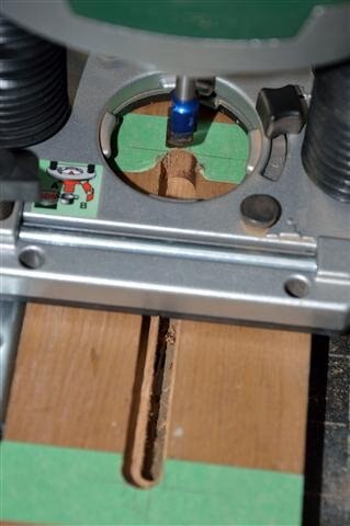

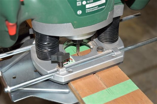

Woodwork isn't my best/favourite material so there was some trepidation ....  how many ways I could muck this up, and at what step would it go pear shaped. image
I had a router and not much experience (read none) using it, so the first thing to try was a slot for the panel.
I found the masking tape helped to see the pencil marks, and it gave a very clear start and stop point.
The neopixel is slightly offest, so the slot to house these is not centered.
The controller was always going to be a Digispark (or clone) so space for that was made.
I left enough room for the wires and the USB plug which will power it.
The base was cut to size and then sanded to tidy it up and make it ready for a coating.

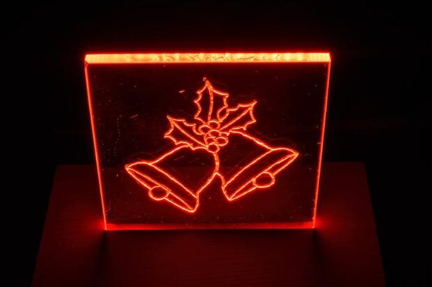

I decided on a Xmas theme and tried a couple of different methods and patterns.

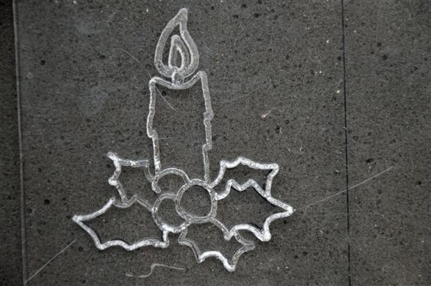

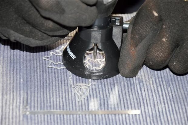

Etching
A Dremel 3000 was used with mixed results. This was due to my acrylic being very soft and was constantly blocking the tip, making it a etch - stop - clear tip - etch - stop ... affair.
The project has made me look seriously at a CNC machine, and I'm sure the quality would be great (well I've convinced myself it will be)

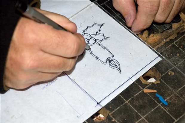

With the design taped to the rear, everything is white, making depth perception difficult, you also get a parallax errors, so in the end I found transferring the pattern onto the front panel was better.
You really need to be careful how much material you are removing as it will illuminate more/less depending on the depth.
I did see a method where they provided edge illumination, but I found that I needed to turn the panel as I etched which meant the illumination would be difficult.
I tried using the stand arrangement they provide with the Dremel kit.
It certainly made the depth variance go away and allowed you to use both hands to control the movement.
I did make use of the Hot Air Rework with the smallest tip to heat the rough etched piece.
It did clean up very well, however you do need to be careful as it will cause the acrylic to bubble.

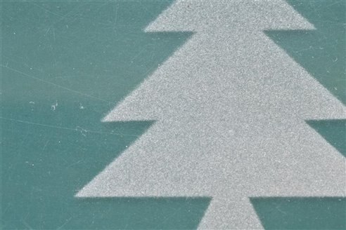

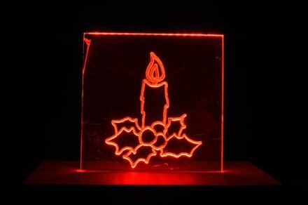

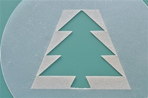

Sandblasting
Because the light bounces off any break in the surface, sandblasting the surface should work.

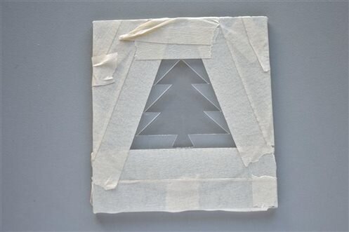

I found some cake decorating patterns at a large retailer and they are a piece of mylar like plastic material.
Controlling how much blasting and the distance to obtain an even pattern is one problem, plus once you start blasting in a small cabinet, visibility becomes very limited.
Another issue is the mask lifting and grit getting underneath.
The mask was taped onto the panel and a couple of blasts at right angles to the panel was enough.
The mask held up very well, but there was some creepage underneath.
As the photo shows the edge is not as sharp as it could be and there are marks out from the edge that the photo doesn't show very well
For something more critical, a thin aluminum mask would be perfect.

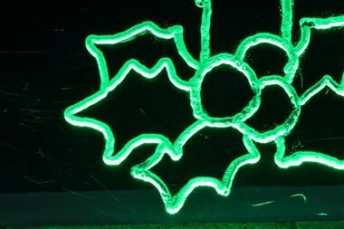

The colour cycle starts from green, and slowly cycles, so leaving the magnet in place means a continually changing colour sign.

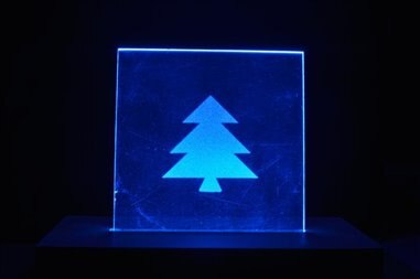

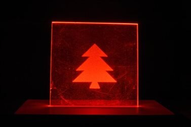

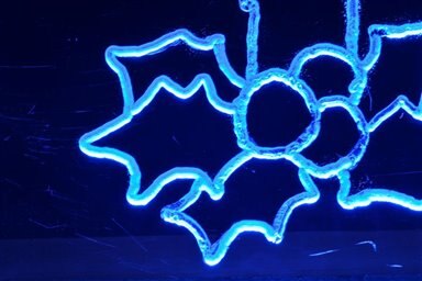

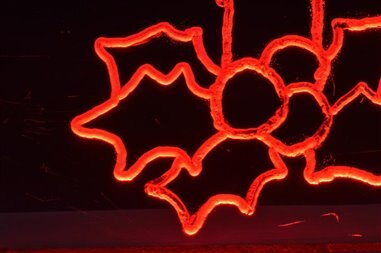

These show the variation of the etching process. Obviously straight lines will not etch well so a varying pattern is more suitable.
Note the scratch which happened during the process, buffing it out can be done but avoiding the problem is the best and easiest method.
These show the sandblasted version and are suitable for dense areas or logos, etc.
They certainly don't pop as well as the etched versions, but the marks and scratches do reduce the contrast, so there is room for improvement.
A combination of both sandblasting and etching might yeld some really interesting effects.

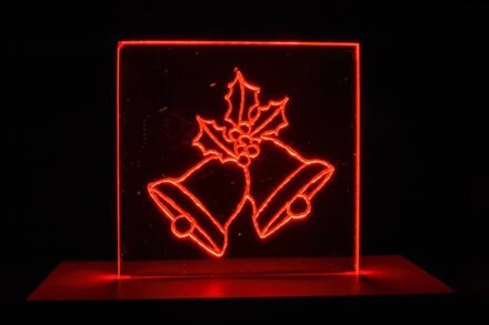

Both of these were done to trial the techniques and demonstrate the effects, so the acrylic panel had a few "war wounds" before I started.
However I did crack one and chip the corner on the other.
This picture give a view of the leakage from the opposite end of the LEDs. (It is quite bright)
Painting the edges white and then adding black over the top will help bounce light back into the panel and stop the leakage outwards.
I didn't bother addressing the leakage at the base, but should be easy to resolve.

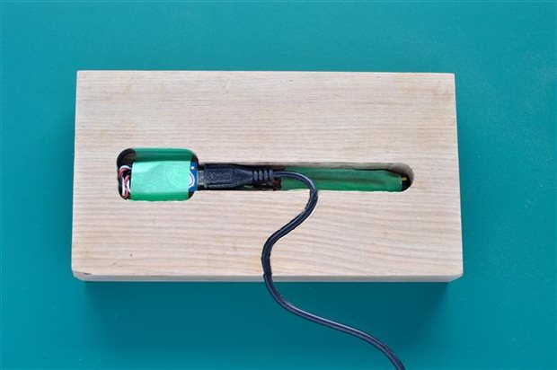

Power
You could power this from a battery and use Wireless Charging if your base is large enough.
I decided on fitting a usb cable and plugging it in for this version.

    mcb1 over 8 years ago in reply to makerkaren
    You have to be quick .... image
    I'm not sure I'd tackle it using a sharp blade.
    You might want to try polishing the piece you cut out to ensure maximum light transfer from the LED.
    SMD style LED's might be another option.

    Hehe. You beat me to the punch. If you haven't seen it yet, be sure to check out this week'sThe Learning Circuit 09: Edge Lit Signs.
    mcb1 over 8 years ago in reply to the-dubster
    Sounds like a good plan.
    I'd be aiming for the CNC ....
    The lighting sounds like a good idea, hadn't thought of doing it, mainly because I can't/don't need to.
    However that could be an idea on some custom stuff coming up. ... if I ever get a chance to return to it.
