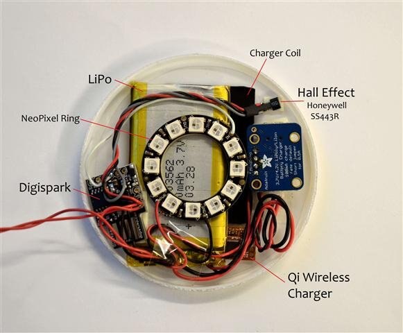

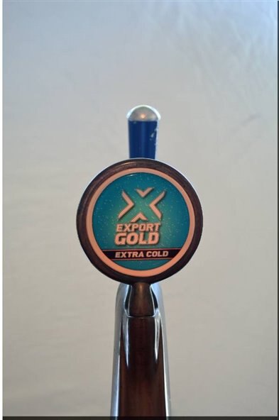

This is something done as an extra for the Beyond the Phone Design Challenge.
For those interested, it was sponsored by Wurth and my conversations with sleuz was the deciding factor to apply.

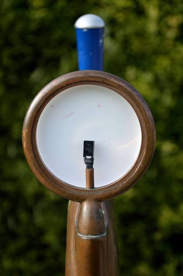

I had heard that someone was rather interested in beer, and since we had these interesting taps that featured an illuminated circle, it made sense for me to call in a favour to get my hands on one.
The originals have a rather crude tungsten lamp and I imagine are a right pain to replace.
Sadly my tap didn't have the lamp, but there is not much thickness and as I understand it was low voltage.

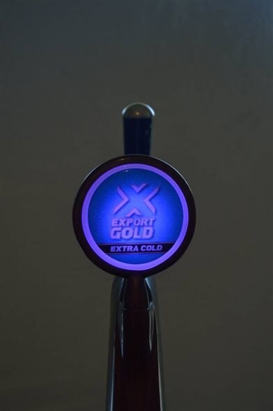

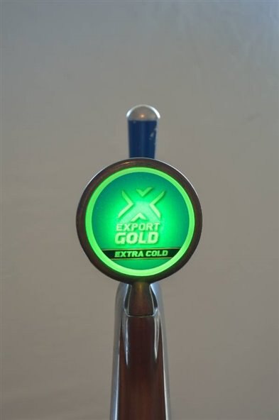

My first idea was to create something that would illuminate both sides, using a led ring both sides, but it quickly became obvious that it was easier to concentrate on one side.
The decision to use neopixels was also made allowing colour changing and brightness.
To keep with the wireless theme, I used a battery and wireless charging.
A slight change to the design was made for a second Hall Effect switch for the brightness control.
Settings were stored in the EEPROM and the digispark has a modified bootloader to remove the 5 sec startup delay.
The items were stuck to a piece of mylar cut to fit within the circle, and a generous amount of double sided tape ensured they would behave themselves.
In real life these taps have refrigerant piped thru and the body is usually solid ice, so heat wouldn't be the issue if it was used in real life.
http://www.andale.com.au/wp-content/uploads/2016/05/Iced_font.jpg
   stolen from http://www.andale.com.au/glycol-beer-system/

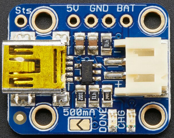

Adafruit supplied the charger/battery management and the unit was turned toward the rear to allow it to be viewed more easily.

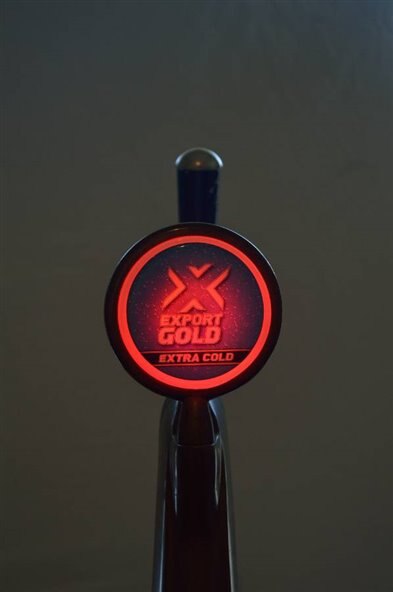

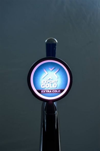

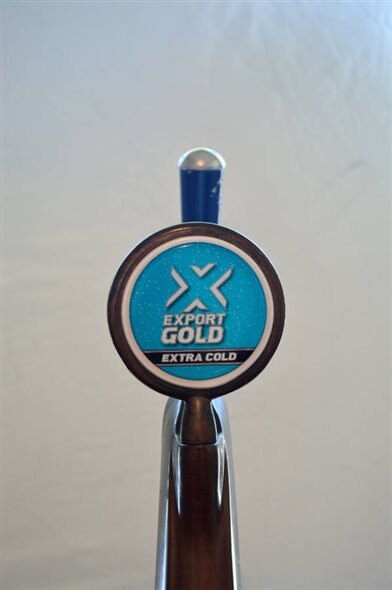

This gives an idea of some of the colours and the video shows it cycling between colours.
                                   OFF                                                                                          WHITE                                                                                                BLUE
                                   GREEN                                                                                                RED                                                                                                MIXED
