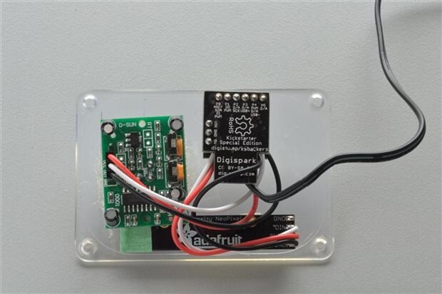

Simple choice really use a Digispark
There is only two I/O required, one input for the PIR trigger, and an Output to drive the NeoPixels.
The case was something I had used in a previous Design Challenge eLDERmon  EnOcean Sensors 4 and it still had the PIR.
Recycling or re-purposing has wonderful benefits sometimes.

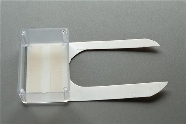

During that challenge I came up with solution to fit a PIR detector just above a power outlet.
It is a piece of plastic cut to fit behind the power socket, with the housing stuck to it with double sided tape.
Some double sided foam tape help secure the Digispark and Neopixels in place for the trial.

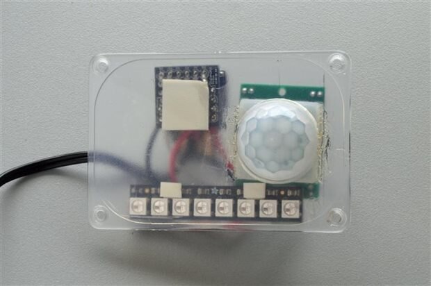

If there is nothing detected then the pixels are red with reduced brightness.
A Heartbeat changes one pixel to white every second and travels across the pixels.
When the PIR detects movement, the pixels change to white and ramp up to full brightness over 8-9 secs.
