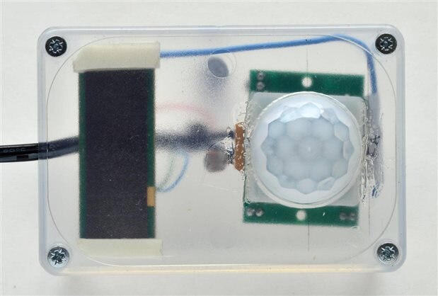

2 layers of double sided foam tape, to stick the sensor to the cover or side, and it seems to work.
The solar energy may be a little reduced due to the plastic, but so far they seem to be working.
For the Movement detector, I drilled a hole with a hole saw (first one was too big), and then filed it out to suit.
      This is the other one, and as you can see it has rotated slightly
A quick slot filed in the base allows for the power lead to run the PIR, and the EnOcean sensor is stuck to the top or side to collect the illumination for charging.

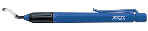

Deburring
For anyone that makes holes in metal, or plastic that require the sharp edge removed, I suggest you look to buying one of these.  Deburring ToolDeburring Tool
I have a larger handle version  UH1000 Deburring HandleUH1000 Deburring Handle  that extends and contain blades inside the handle.
I can assure you, once you've used one of these, you'll never look at using a file for hole deburring again.

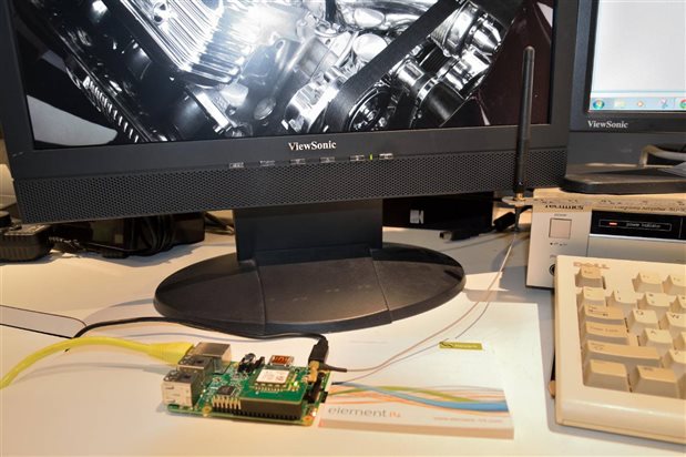

Receiver

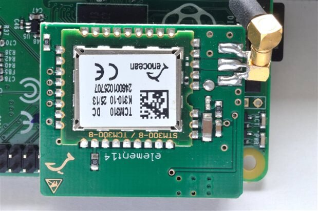

I had always been mindful of the antenna when I assemble this in it's final case.
While the wire whip works and is efficient, it would be compromised inside the enclosure.

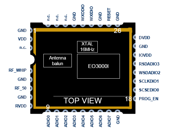

Enocean have allowed for the connection of a 50 Ohm external antenna, and they detail everything you need to know in the TCM300x manual.
Section 4 (Page 24 ) has some very good information regarding the best orientation for whips, and what to avoid.

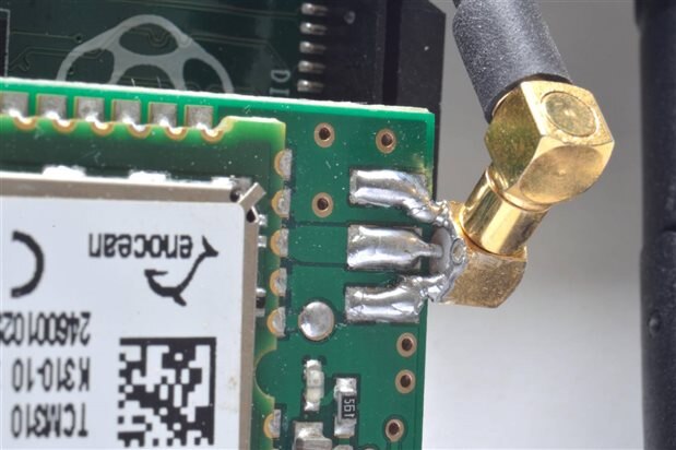

I scrounged a connector, lead and antenna from a dead GSM modem we had, and added it the EnOcean Pi module.
         Photo showing the external antenna connected to EnOcean Pi
The hardest part was removing the socket from the 4 layer board, that was 90% earth plane around the socket ...needless to say, the side cutters got used in the end.
A larger socket would have fitted better, but its there and it works well.

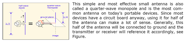

Just remember that all 1/4 wave antenna rely on the ground plane to work correctly, so if possible add something metallic at 90 degrees to the whip.
          snipped from enOcean AN102 application note.

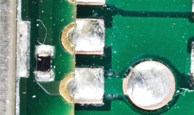

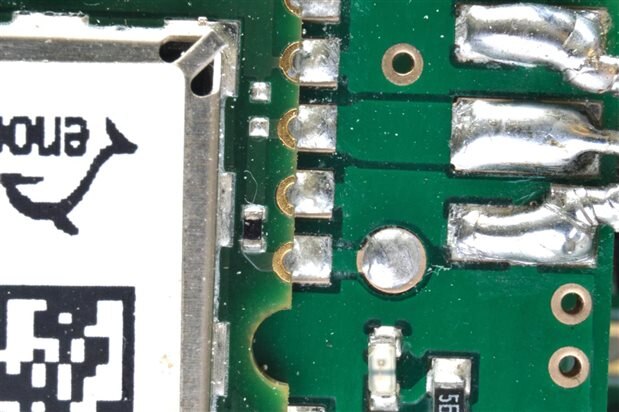

In amongst the notes, they mention some parts to remove.
Depending on your version of TCM310, this capacitor is part of the whip tuning, and should be 12pF.
This is a crop of the image showing the capacitor ... bear in mind that the pins spacing is 0.1 inch (2.54mm)

    mcb1 over 12 years ago in reply to kipe
    Kimmo
    Thanks.
    I haven't actually done any range checks with the original items.
    You should be able to check the RSSi by using the TCM320 supplied with the programmer, and Dolphin View.
    You can add an external antenna and see if it makes a difference, but ensure you follow the instructions to remove the impedance matching components.
    The external antenna I used is still a 1/4 wave whip, so I'm not expecting any gain, BUT the ground plane is improved (or will be when I mount it properly) so there is an improvement to be had there.
    re your struggle.
    There is some very good information in the Application notes I referred to, for proper antenna placement.
    AN 001 Range Planning has some suggestions and general guidelines.
    The first suggestion I'd make is to ensure both transmitter (sensor) and the receiver (EnOcean Pi) antenna are the same orientation ie vertical or horizontal.
    The wire should be straight, not folded in half, or coiled up.
