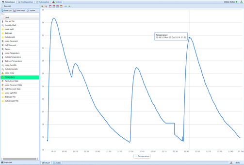

At a later date I was asked about doing an article for TheShed magazine.
The publisher wanted a remote display of the glasshouse temperature, and it seemed that I could adapt this to show the concept.
Many of the readers wouldn't have the required OpenHAB display we were using in the Design Challenge, and therefore a receiver and some form of display was necessary.

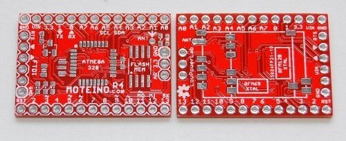

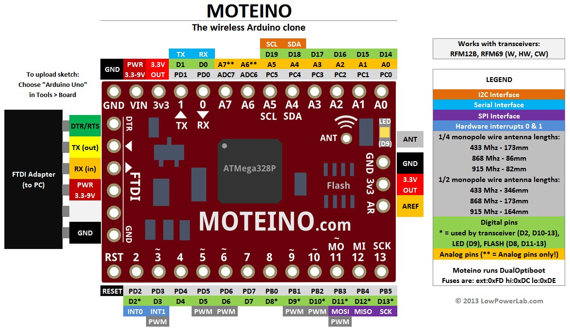

Eric had demonstrated the RFM69xx transceivers but they needed a microcontroller board to host them.
When I was looking at where to buy the RFM69's I came across the Montenio board that was made by LowPowerLab
https://lowpowerlab.com/guide/moteino/#whatisit
          image from LowPowerLab showing the raw unpopulated boards.
The price of the competed item was below what I could get the raw parts for.
The documentation and support also seemed to be there (unlike many other sites just selling the product), so it made sense to support someone else.

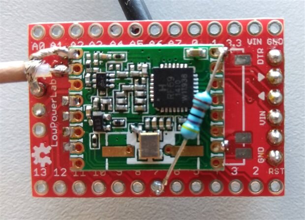

The big advantage of these is the ability to solder the Transceiver module directly to the board, rather than wires and some mounting method.

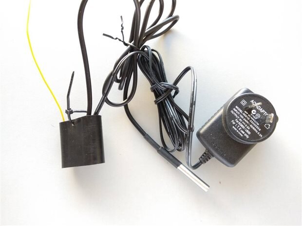

The DS18B20 was attached to D7, and a 4k7 resistor soldered between the pin and Vcc.
These pictures shows another board configured with the sensor and resistor.
In order to stop it getting damaged, I placed it inside a small container that I picked up somewhere.
The yellow wire is the antenna.
The 5v adaptor gets connected to the Vin and Gnd pins of the Moteino, and the 3v3 regulator happily runs the transceiver and the DS18B20 sensor.

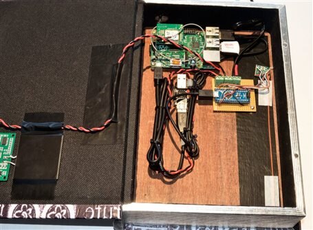

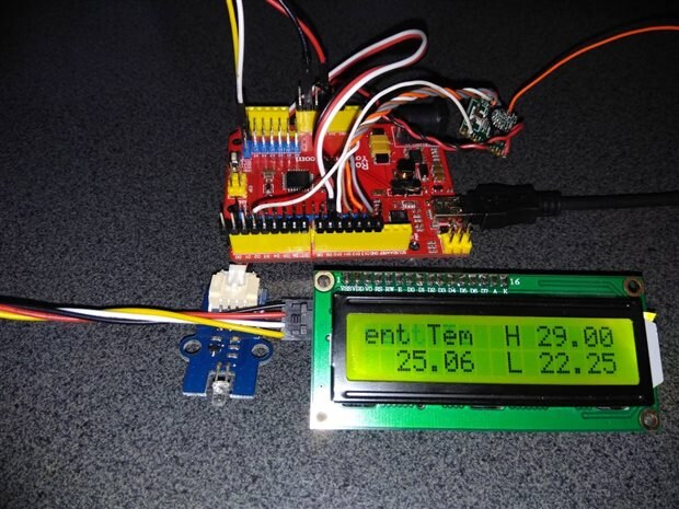

Receiver
The original had the receiver buried inside what looked like a book.
The serial output was fed into the Raspberry Pi and presented in OpenHAB.
eLDERmon Graphs
For this application I needed an LCD.
It's not the best photo but the glare from the overhead lights was killing other angles ...

I decided to use some of the techniques that I explained here Arduino, Temperature, LCD and more
The display scrolls 8 characters of a message ... in this case "Current Temperature"
The Arduino's I use for developing projects have the option of 5v or 3v3, which eliminates the need for level converters.
The RFM69 is a 3v3 device and while they survive 5v on the inputs, they don't work correctly, so either you'll need level converters, or a board that works on 3v3.
The biggest issue is most of the LCD's want 5v and hence the contrast becomes a problem.
I2C LCD's can happily be powered from 5v and 3v3 on the SDA and SCL pins, so they'll work correctly. image
I do have a 3v3 I2C LCD somewhere that arrived with some other 5v versions.
There was some head scratching about why it wouldn't work until I noticed it had an extra chip on the board.
It seemed to have slipped into the suppliers shipment as they don't offer them. image
Video
This is a simple demonstration showing the concept with the receiver connected to an Arduino Uno rather than the Moteino.
I've done this because as luck would have it, I didn't have a spare one available to photograph/video.
Hopefully this has refreshed some memory cells and provided some useful information to others interested in sending data from one place to another.
While you can use WiFi and other methods, having an intelligent receiver means you can add value to the data, or raise alarms when you're not getting it within the required time.

    mcb1 over 8 years ago in reply to mcb1 +2
    I've added the transmitter pictures and made a very minor edit I ordered some more Moteino and Felix was very helpful in pointing out the new R6 version support the RFM95/96 LoRA radio he has. https:/…
    Thanks Gene
    It seems my photos of the transmitter and receiver never made it.
    I'll sort that out tomorrow as they are at home and I'm not .. image
