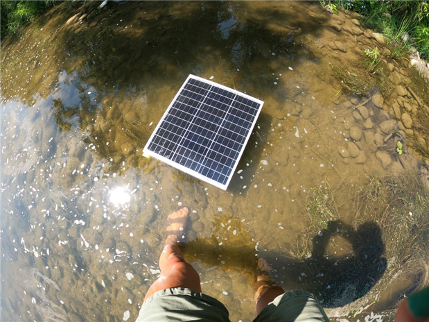

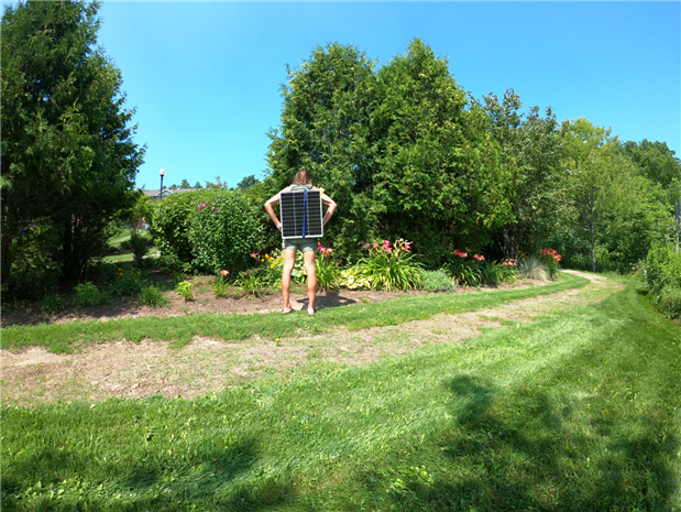

The day arrived to finally put the Nemo Discovery Apparatus out into the wild! I lashed up the solar panel to my backpack and headed down to the river.
I can't help but laugh when I see this photo, the solar panel is borderline too big for a backpack, but it does put out the watts!

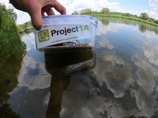

Putting the solar panel in the water was really just to validate the proof of concept. The pool noodle pontoons could drastically be improved for a long-term deployment.
Placing the camera into the water for the first time! No Leaks image

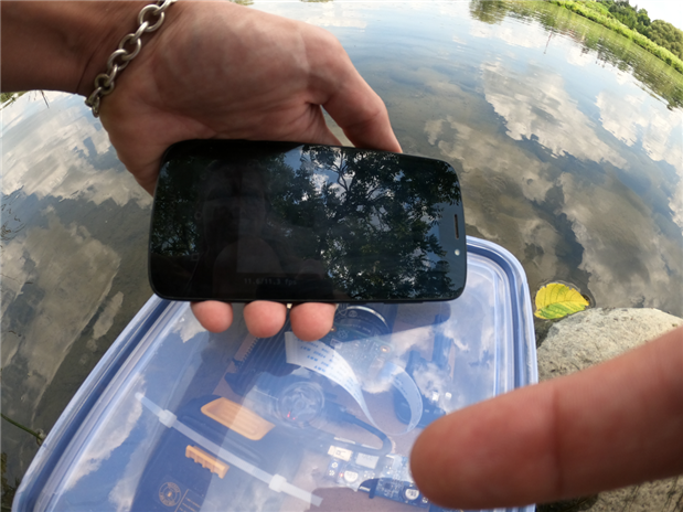

Giving the system a final test from motioneye on my phone.
Everything looks good.

    Oh dear, the solar backpack! lol Though it is quite the delight when there are no power outlets in sight.
