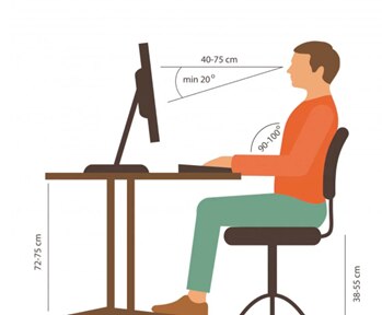

This pandemic has made most of us work from home. While we may not have an ergonomic chair to sit for long enough at home, we may need to sit in a straight posture (without like slouching) such that it does not affect our body's posture or our health in the long term.
So, in this project, we'll use Raspberry Pi HQ Kit and Computer Vision (CV) to monitor the posture of the person sitting on a chair and alert when the person's posture is bad and not as per standards (refer image below).
Source: Sitting positions: Posture and back health (medicalnewstoday.com)

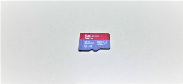

SD card with a recommended size of at least 8 GB space To store files and for the Raspberry Pi OS

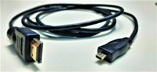

Micro HDMI to Standard HDMI Cable *
(x2 if you wish, since RPi 4 has two HDMI ports,
you can now connect to two separate monitors)
To connect Raspberry Pi to a screen Buy a Micro HDMI to Standard HDMI (A/M) Cable – Raspberry Pi

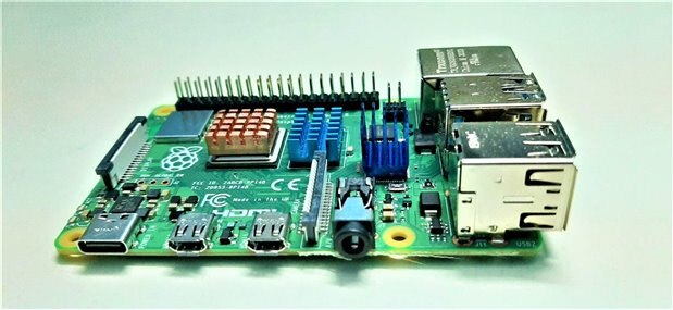

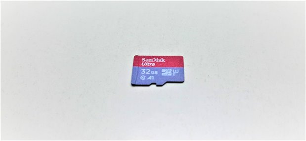

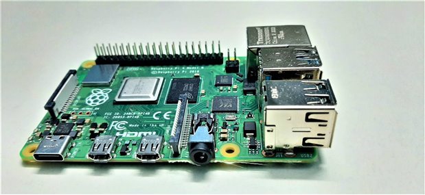

3. Raspberry Pi 4 and accessories
Here are some photos of Raspberry Pi 4 and accessories - Heat sink, SD Card, Micro HDMI to standard HDMI cable and Power supply.
{gallery} Raspberry Pi 4 and accessories
Raspberry Pi 4
Raspberry Pi 4 with Heat Sink
32 GB SD Card

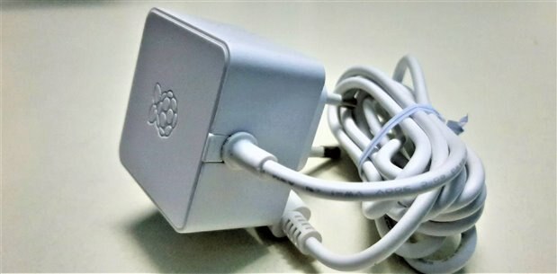

15.3W USB-C Power Supply

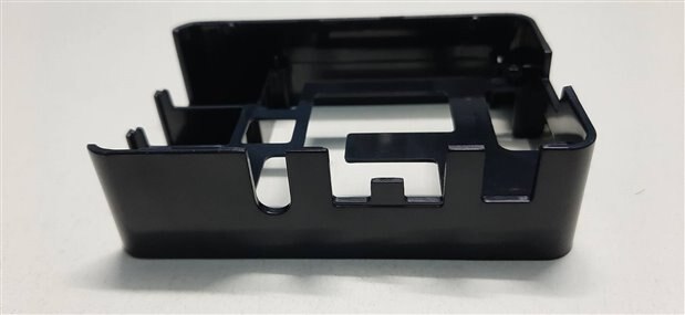

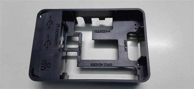

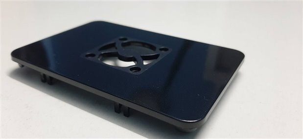

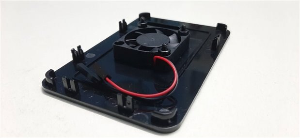

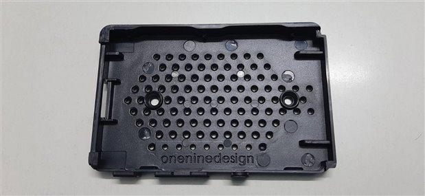

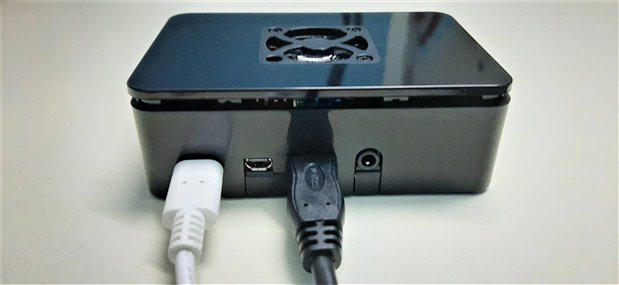

4. Raspberry Pi 4 Case
Here are some photos of the case for Raspberry Pi 4 with fan which I bought and an animation of fitting Pi into the case.
{gallery} Raspberry Pi 4 Case
Bottom piece of the case
Middle piece of the case - Top View
Middle piece of the case - Bottom View

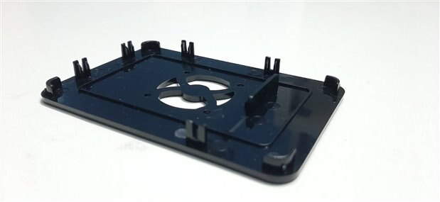

Top piece of the case - Top View
Top piece of the case - Bottom View
Fan fitted onto the case's top piece
SD Card inserted through the case
Cables plugged through the case

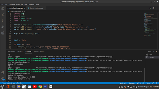

Initially I was waiting for the Raspberry Pi HQ Camera kit to arrive. So, without wasting any time, I started exploring OpenCV in my laptop (with Linux OS) and this is how it went...
OpenCV has been in my to-do list for a long time. I am happy that finally I got a nice excuse to start learning and making projects using OpenCV. From OpenCV's Website we can understand that (About - OpenCV),
OpenCV (Open Source Computer Vision Library) is an open source computer vision and machine learning software library.

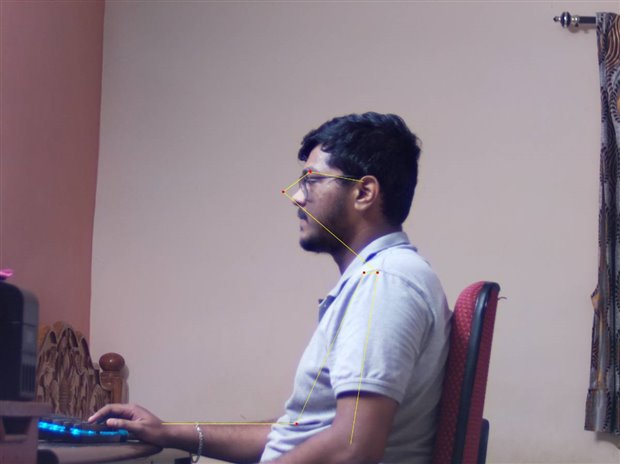

In this project, we are going to use OpenCV as the brains to analyze the photos/ videos that Raspberry Pi HQ Camera kit would capture and estimate the posture of the person who is sitting. Then we'll alert the person if required to correct his posture to prevent any long-term detrimental effects on his/ her body.
There is a project called OpenPose which will help to detect key points of body. Then based on the position of key points we can identify whether ideal sitting posture is followed or not. In this blog, we'll cover up to key point detection and the remaining will be covered in upcoming blog posts.
1. Installation of OpenCV in Linux - I had followed instructions in the following link to install OpenCV in Linux OpenCV: Installation in Linux
I faced an issue while importing OpenCV library (command given below) even after following the required steps in the web page mentioned above,
import cv2 as cv
This was resolved by using the below command in terminal. Thanks to the following post - python - Cannot find module cv2 when using OpenCV - Stack Overflow
pip install opencv-python
After installing OpenCV in Linux I ran a basic project given in OpenCV website - OpenCV: Getting Started with Images. It ran as expected, so now let's move on to the next step.
2. Selecting a Model - After searching for a while, I landed on this beautifully written article on human pose estimation - Deep Learning based Human Pose Estimation using OpenCV (learnopencv.com). I could see two data sets that can be used for pose estimation or key point detection. One is MPII and another is COCO model. But based on the key points generated I can see COCO model covers more facial details like ear and eye whereas MPII detects only as head (and other body key points as well). So, I picked up and proceeded with the COCO model - COCO - Common Objects in Context (cocodataset.org). Since it can help to better estimate the position of head like titled or straight.
3. Model Weights - We'll need to now get model weights which will be used in the OpenPose project. To do the same, first you need the project from here - openpose/models at master · CMU-Perceptual-Computing-Lab/openpose · GitHub. Then you can run the below commands in terminal.
sudo chmod a+x getModels.sh
./getModels.sh
Or it can be downloaded from here as well - http://posefs1.perception.cs.cmu.edu/OpenPose/models/pose/coco/pose_iter_440000.caffemodel
4. OpenPose Project - This is the last step, for this you need project from here - learnopencv/OpenPose at master · spmallick/learnopencv · GitHub. Place the weights file generated or downloaded from previous step inside 'pose/coco' folder. You can then place the image/ video that needs to be processed and key points identified into the project home directory. I used Visual Studio Code to run the 'OpenPoseImage.py' or 'OpenPoseVideo.py' files. A screenshot of the same is given below. On successful run, output skeleton and output keypoints detection files will be placed in the same project home directory.

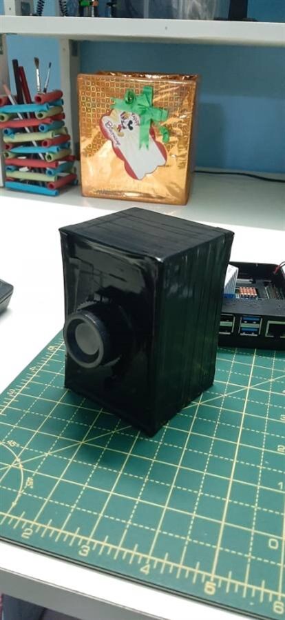

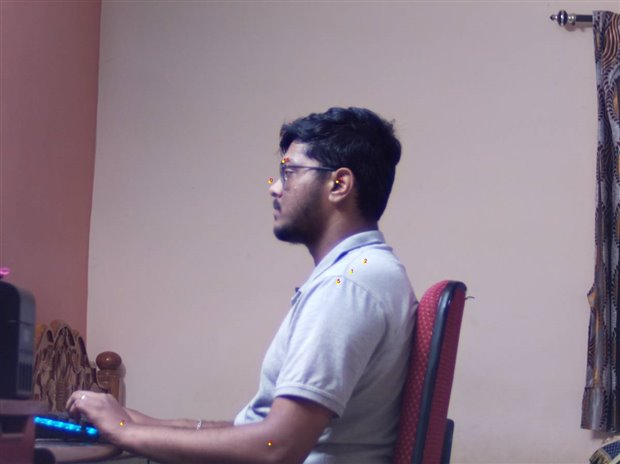

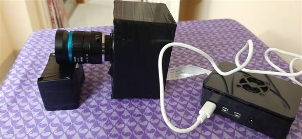

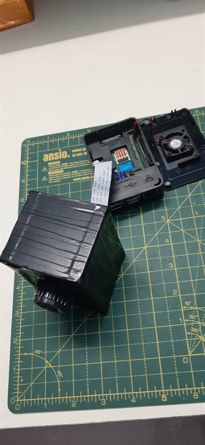

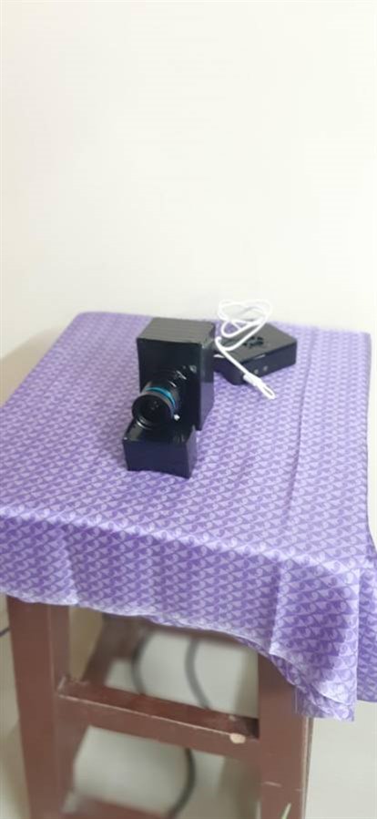

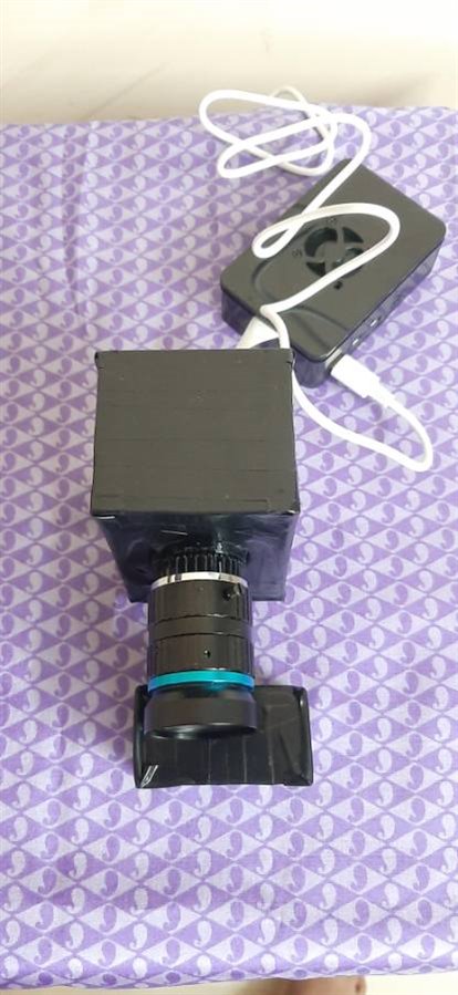

First, I was using images and videos available online or captured using my mobile phone to test the OpenPose project. And then the Raspberry Pi HQ Camera kit arrived which was then used to capture images and video to provide input to the OpenPose project.
Below are the images and video of the camera kit in action. I made a case out of foam board to temporarily support the camera module and to hold the lens.
{gallery} Camera in Action
Case for camera using foam board
Camera full setup with support for telephoto lens using foam board
Camera full setup with support for telephoto lens using foam board - top view
Camera full setup with support for telephoto lens using foam board - side view

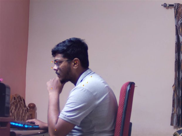

Output Skeleton
{gallery} Output Skeleton
Sitting straight
Sitting straight
Slight bending forward
Extreme bending forward
Output KeyPoints
{gallery} Output KeyPoints
Sitting straight
Sitting straight
