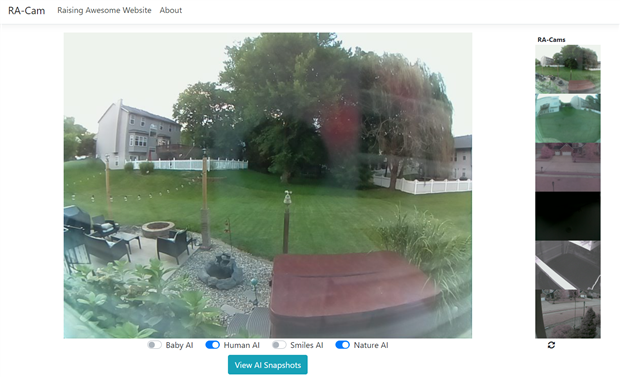

Screenshot of the RA-Cam Interface

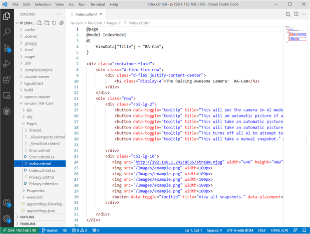

VS Code:  More-and-more becoming the standard for coding across all platforms
Here is how to connect to your PI remotely:
  1. Put the SD card in your Pi Zero W, plug in the usb power, and you'll have a working PI on your network.
  2. To code on the Pi, I like to use VS Code these days.  It's like Cloud 9 married Visual Studio and they had a very cool kid.  However, Putty is still a lean, reliable alternative to connect via SSH and is required over VS Studio for a Pi Zero due to its architecture.

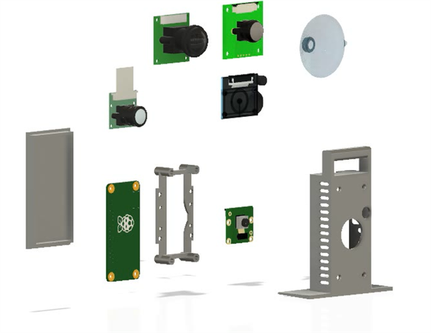

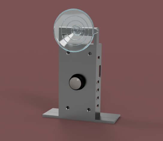

IV. 3D Printed Enclosure
You can get my 3D Files in Autodesk Fusion 360 to make the design your own here:
     https://github.com/RaisingAwesome/RA-Cam/blob/5296548d731a4924abf2038610f99a7fd419d2ae/RA-Cam%20v65.f3z

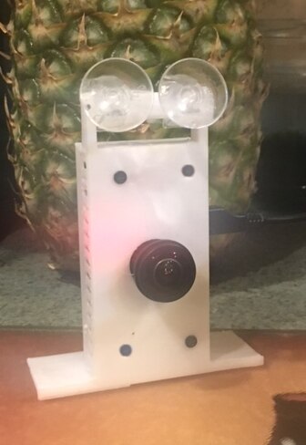

You'll notice a lot of mounting points.  That's because my cameras all had there own twist on hole locations.  I made a one size fits all frame and enclosure.
All Components and Different Cameras that Can be Applied
My Favorite One at Our Kitchen Sink Window

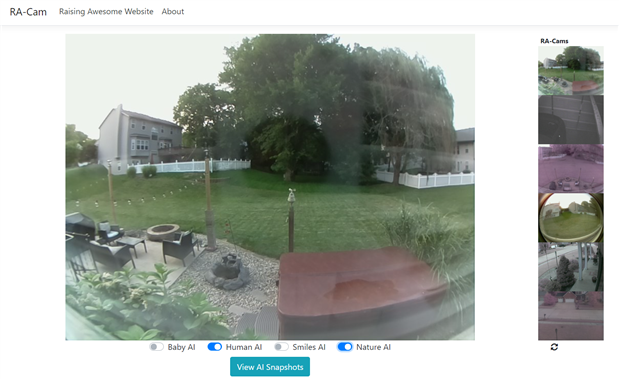

My web design is this:
  • Single Page Application - my Razor Pages use AJAX calls allow the user to never have to see a "postback".  This gives it the look and feel of an application.
  • When buttons are clicked, ASP.Net make process calls to linux console app that snags frames and applies AI to create snapshots.
Using Bootstrap in the web design allows for responsive formatting which allows one code base to serve any screen size
VI.  THE CODE
What makes this project truly unique is the code.  You will not find this ASP.Net Core 5 code anywhere else but right here.  That's because it was written from the ground up just for this project.
So what's so big about it?  Well, it's a full-on, dynamically generated, single page asynchronous user event handling web app.  That makes it super user friendly and capable of being leveraged well beyond just taking pictures.

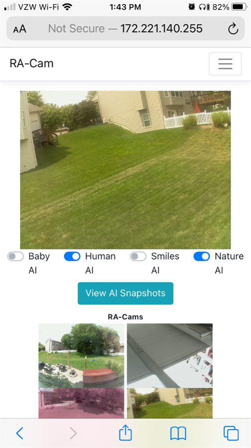

  1. WIth a browser, the user visits the IP address of a RA-Cam that is running the ASP.Net Core 5 web app.
    • you can have just one RA-Cam running the dotnet app, or all of them on your network, but you'll end up just bookmarking one on your phone.  So, I just have one.
  2. The RA-Cam web app serves up a page that is made of dynamically created HTML and JavaScript.  This produces an ad hoc JQuery driven client side single page app - that is...one that never appears to "post back" to the server.  It behaves like you would expect any app on your phone to behave.  The URL at the top of the page doesn't change.  It's all happening on the original page.  Even better, thanks to Bootstrap, it has a responsive look-and-feel that looks good on any size device.
  3. When the user clicks on that generated client side app, the client app does an asyncronous post (AJAX via JQuery) back to the web app on the server.
  4. The web server then evaluates the AJAX post to determine what to do depending on what the user clicked.  Most clicks will result in the ASP.Net web server sending a "GET" to the main active RA-Cam's Python server that is handling the streaming.
  5. The RA-Cam that receives the "GET" request interrogates the "Get" to see what the ASP.Net Web Server wants and then does the necessary command locally and sends back content.  This could be turning an AI mode on/off or serving out a still shot for the thumbnails.
So, basically, the ASP.Net app is making an app on the fly.  It does this so you don't have to configure anything other than your Wi-Fi.  Just hook up a RA-Cam and they can figure it all out.

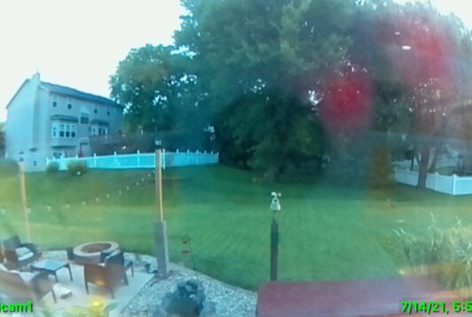

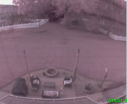

Here are some images we caught.  We found we had some visitors.
The RA-Cam Client Side App
Can you spot the RA-Cam?  A deer? A Skunk!!!!?  Comment below if you find them.
Can you spot the skunk!?

    I See the skunk! Can’t find Wally though. This is a really nice setup Sean.
  • Sean_Miller
    Sean_Miller over 5 years ago
    Four deer this morning - two of them fawns: RA-Cam
  • Sean_Miller
    Sean_Miller over 5 years ago in reply to javagoza
    Thanks, Enrique.  I figure if Google can publish it on their street maps, why not me, :-).
  • javagoza
    javagoza over 5 years ago
    Brilliant! I've been snooping around with your RA-Cam Ecosystem website. In my country these images could not be published.
  • Sean_Miller
    Sean_Miller over 5 years ago in reply to Andrew J
    Good job.  The deer is in the upper right of the colored picture.  She's laying down chillin'.
  • Andrew J
    Andrew J over 5 years ago
