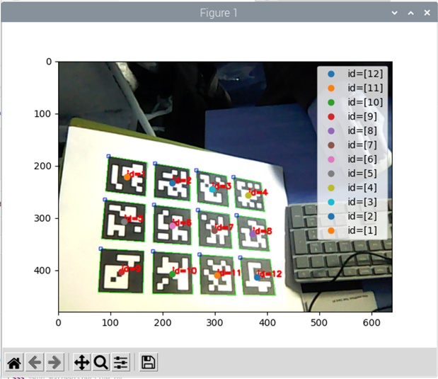

So far we have been using ArUco 6x6 codes, but we don't need that many and size does matter here.
Image using ArUco6x6 codes and PyPlot without reordering the colours.
OpenCV uses BGR as its default colour order for images, matplotlib uses RGB.
ArUco 6x6 codes
Testing with simpler codes to increase processing speed.

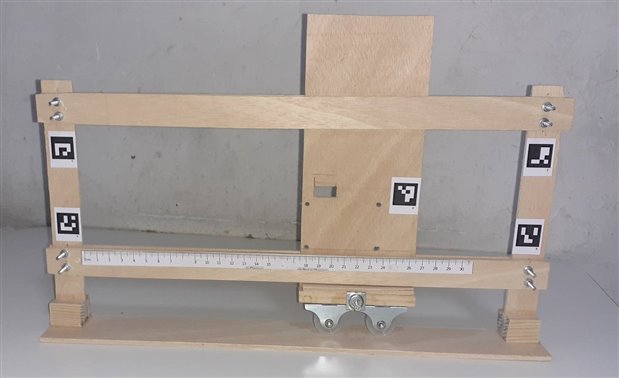

We want to detect the position of the moving parts of the windows using ArUco markers
Depending the alignment of the camera with the windows the images of the window are skewed and in wrong perspective.
We will define the following convention:
  • ID 0 : moving part in control
  • ID 1 : top left reference corner
  • ID 2 : top right reference corner
  • ID 3 : bottom right reference corner
  • ID 4 : bottom left reference corner
