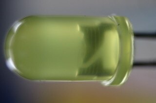

First thing I did was to put an led in a breadboard and take a photo.
Then I powered the LED with 1v and nothing happened.
I increased voltage to 2v and the LED lit up.
Next  I increased the voltage and the LED failed in what looked like a small explosion. Video shows LED lit  normally then I turn off the power, increase the voltage and turn the power back on.
So what is actually happening here?

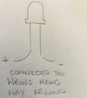

I noticed on the data sheet, that I looked at, there was a reverse voltage i.e. the voltage at which the diode will allow current to flow back. The data suggests that when this point is reached it is usually also the point at which the LED will fail.
More Experimenting
So back to experimenting and I put an LED in the bread board and reversed the voltage.
I started my camera recording and watched what happened as I cranked up the volts.

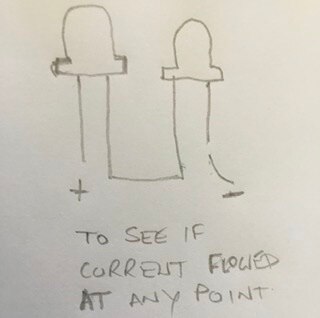

Nothing.  I started at 5V and reached 31V (the limit of my bench power supply) and what I expected, which was some sort of catastrophic failure, didn’t happen. I tested the LED and it still worked. So I connected another LED the right way around into the circuit to see if at any point the current flowed. Still nothing.
So from that I can conclude , for my LEDs at least, that they would act as a diode for quite a high current, certainly more than I ever play around with. I guess other LEDs will have different characteristics.

    I was curious about your reverse measurements. It's not something that you normally ever look at if you design with LEDs, you just go by what the datasheet tells you (which is usually 5V). I've tried it…
