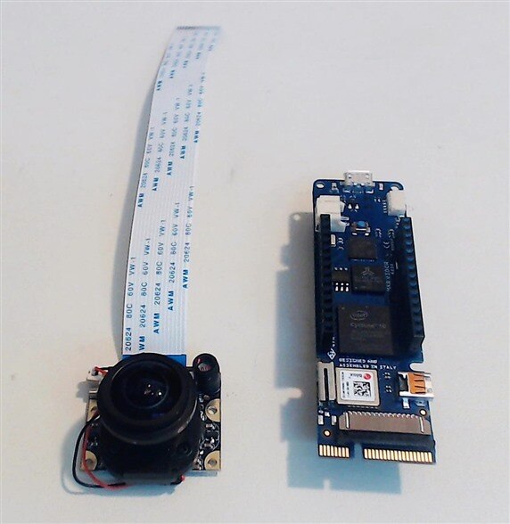

  •     Arduino MKR Vidor 4000
  •     Omnivision OV5647 camera or Raspberry Pi Camera V1 (OV5647)
    • Used :
      • MakerFocus Camera IR Fisheye Wide-Angle 175 Degree 5MP OV5647 Webcam Built-in IR-Cut
  •     micro-HDMI to HDMI cable or adapter

  To demonstrate the VidorQrRecognition capabilities of the MKR Vidor 4000, a MakerFocus 5MP OV5647 Camera was used. At this time, the examples provided from the Arduino Libraries only support the OV5647 sensor which was used in the v1.x of the Raspberry Pi Camera module, thus the v2.x Raspberry Pi Camera will not work with the code provided without modifying the code.
   MakerFocus 5MP OV5647 Camera and  MKR Vidor 4000

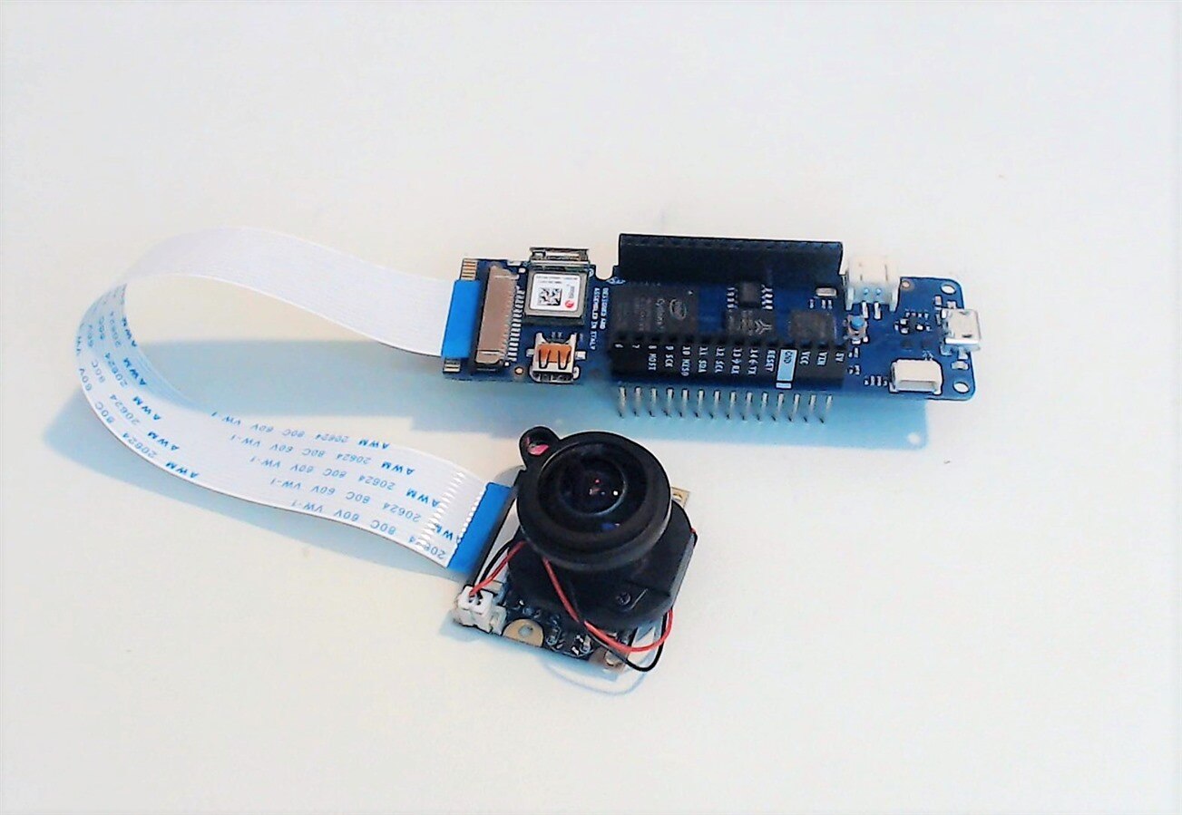

    The O5647 camera connects to the MKR Vidor 4000 at the J8 MIPI camera connector near the Mini PCIe connection (J2) .
    Note the orientation of the blue tab on the camera cable.

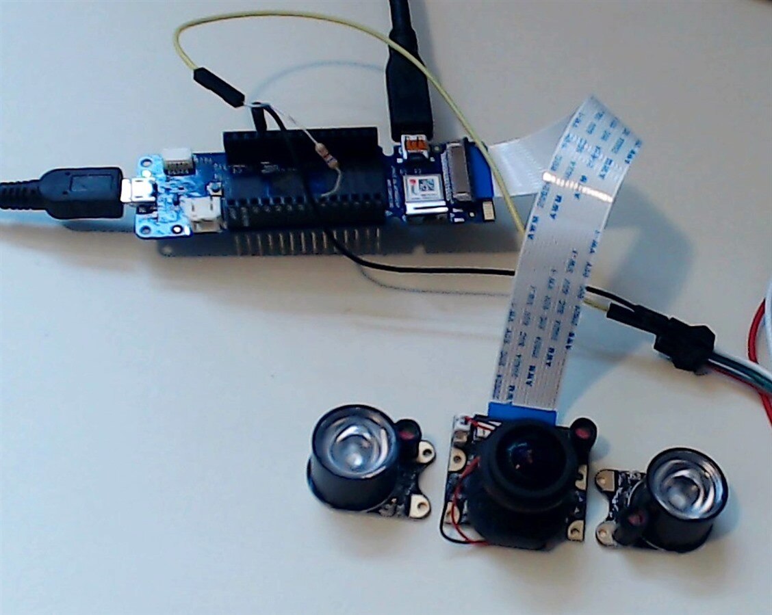

   MakerFocus IR Fisheye Wide-Angle 175 Degree 5MP OV5647 Camera also comes with 2 large IR sensors that mount on each side of the Camera PCB. These will not be used in this example.  Also, the NeoPixel Strip is connected to A6 of  MKR Vidor 4000 with a 470 Ohm resistor.
Connect the MKR Vidor4000 to a computer using a USB to USB-micro cable.

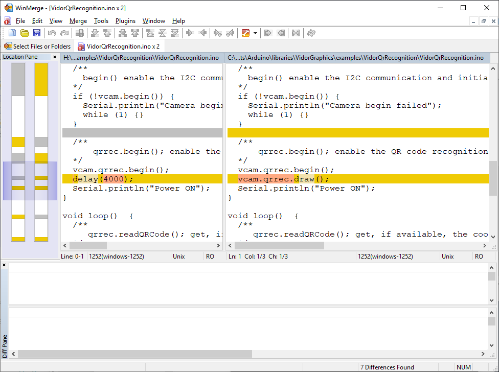

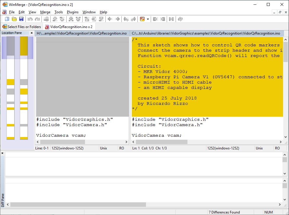

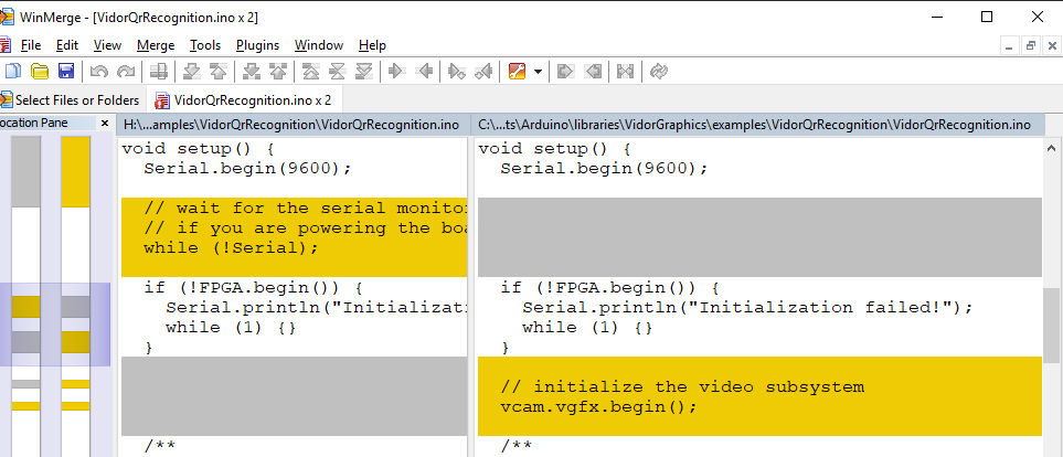

NOTE: There is a difference between the VidorGraphics examples from the VidorBitstream code and the current released version that is added by the Arduino IDE libraries. Thus, if the VidorGraphics examples are from the VidorBitstream process and code was created from the original examples, a few changes will be necessary since the older code will not compile or run with the newer code.
Diff between original and VidorBitstream VidorQrRecognition Arduino code.
  A comment added to top of new code.
  The wait for Serial was removed and a "vcam.vgfx.begin() was added to initialize the video subsystem.
  New code adds "vcam.qrrec.draw()" to enable the camera output for QR code recognition.

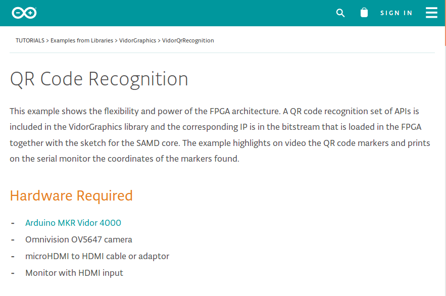

Description of the VidorQrRecognition example can be found on the Arduino site at the following link.
https://www.arduino.cc/en/Tutorial/VidorQrRecognition

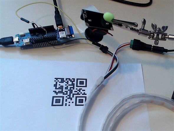

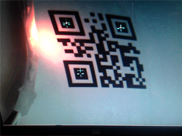

The VidorQrRecognition example demonstrates the interaction between the FPGA BitStream code and the Arduino libraries by recognizing the markers on a QR code and then displaying cross hair images where the QR code markers are located on the screen.  Also, the example was modified to indicate when the QR code markers are found, a NeoPixel LED will light and thus blink accordingly.
If the QR code is covered, then the Cross hair are not displayed on screen and the NeoPixel LED does not blink.  Expose the QR code again and the QR code marker indicators are seen again.
To perform the demonstration, a RadioShack Helping Hand was used to hold the MakerForce camera module and a QR code was created from the works "MKR Vidor 4000".  The image is displayed on an HDMI Monitor and a webcam was used to capture it.
   QR Code markers found and NeoPixel LED lights red
