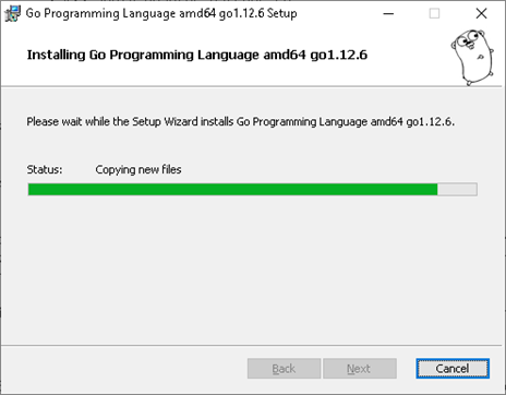

Go Programming Language Install
The VidorBitstream as a requirement to use the Go Programming Language to build a particular package.  If Go is not already installed, then it will need to be downloaded and installed prior to building the VidorBitstream code.
Go can be downloaded from the following:
https://golang.org/dl/
Once downloaded, run the installer to install the Go Language files.

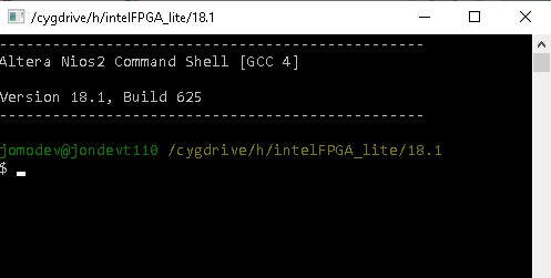

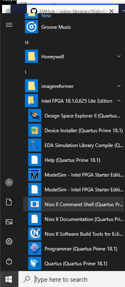

Nios II Command Shell
Once the VidorBitstream bits have been downloaded, open the Nios II Command Shell which will be used to compile the code
In windows, go to the Window Icon and select Nios II Command Shell ( Quartus Prime 18.1)
This will open a Command Shell which acts like a Linux Console.
NOTE: The path in the Nios II Command Shell starts with "cygdrive" and then the driver letter and the rest of the directory structure, "h" in this case.
