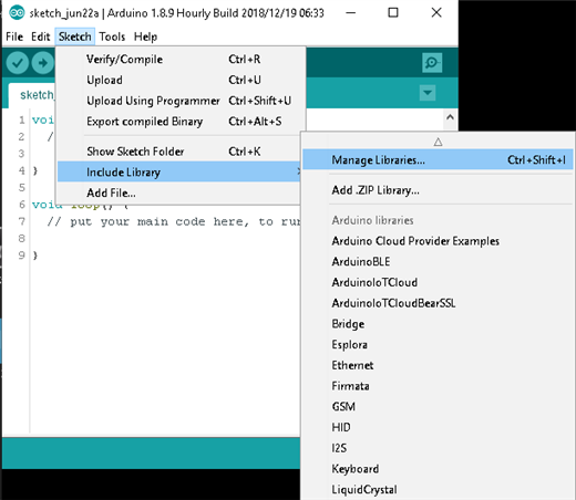

Manage Libraries
To check the Libraries, from the top menu of the Arduino IDE:
1. Select Sketch->Include Library then  select Manage Libraries.

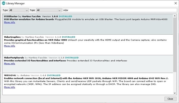

  2. From the Library Manager window, type in vidor in the search bar to get a list of Vidor 4000 related libraries.
      The main libraries are:
  • USBBlaster
  • VidorGraphics
  • VidorPeripherals
  • WiFiNINA
   3.  Update or install the appropriate libraries

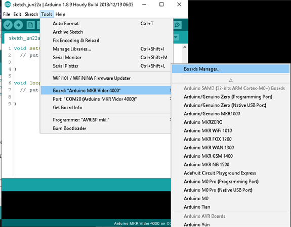

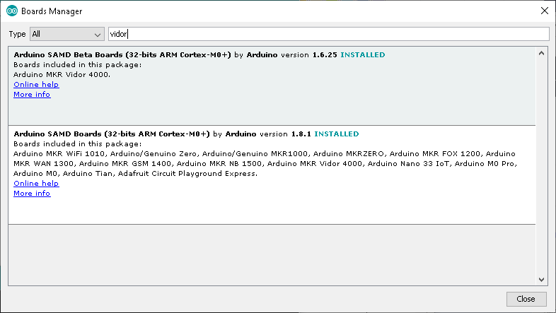

Boards Manager
  To check the Boards Manager, from the Arduino IDE
   1. Select Tools->Board and click on Boards Manager
  2. Type "vidor" in the search bar to get a list of related board libraries.
      The current options are:
  • Arduino SAMD Beta Boards (32-bit ARM Cortex-M0+)
  • Arduino SAMD Boards (32-bit ARM Cortext-M0+)
  3. Update or install the appropriate board files.

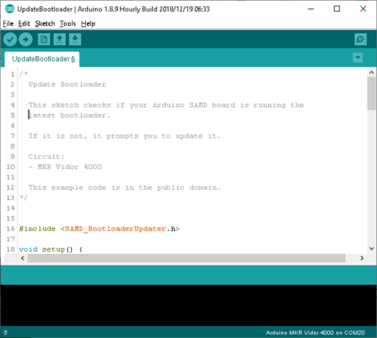

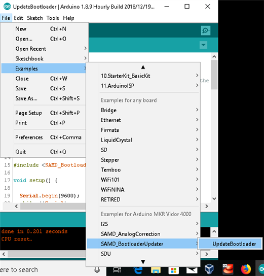

  To update the MKR Vidor 4000 BootLoader:
   1. From the Arduino IDE menu, select File->Examples then SAMD_BootLoaderUpdater->UpdateBootloader
  2. This will open the UpdateBootloader Sketch.
  3. Build and load the UpdateBootloader Sketch and then open the Serial Monitor to complete the update

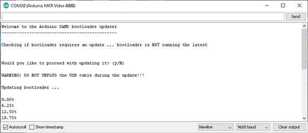

  4. The following message will be seen in the Serial Monitor
Type 'Y' in the upper command input and hit Enter
Welcome to the Arduino SAMD bootloader updater
Checking if bootloader requires an update ... bootloader is NOT running the latest
Would you like to proceed with updating it? (y/N)
WARNING: DO NOT UNPLUG the USB cable during the update!!!
Updating bootloader ...
0.00%
6.25%
12.50%
18.75%
25.00%
31.25%
37.50%
43.75%
50.00%
56.25%
62.50%
68.75%
75.00%
81.25%
87.50%
93.75%
100.00%
The bootloader was successfully updated \o/
Your board will now start blinking in joy :)

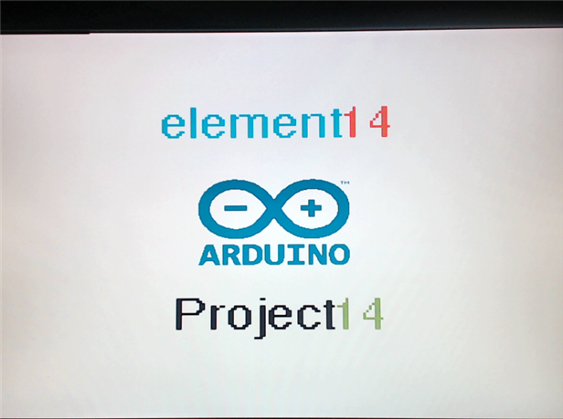

Once the board has been updated, select an Vidor example to ensure the board is working.
Here I have selected the VidorGraphics->VidorDrawLogo as an example but with some modifications.

I made some edits to the Vidor_GFX code to add more colors
Vidor_GFX.h
   uint32_t darkCyan();
   uint32_t darkTurquoise();
   uint32_t redOrange();
   uint32_t yellowGreen();
Vidor_GFX.cpp
uint32_t Vidor_GFX::darkCyan() {
 return Color(0x00, 0x8B, 0x8B);
uint32_t Vidor_GFX::darkTurquoise() {
 return Color(0x00, 0xCE, 0xD1);
uint32_t Vidor_GFX::redOrange() {
 return Color(0xFF, 0x81, 0x00);
uint32_t Vidor_GFX::yellowGreen() {
 return Color(0x8E, 0xAA, 0x31);
This produces the following image from the HDMI connection:
