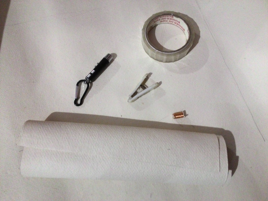

Step 1: Parts Required
Parts Required
1. Key-chain LASER (You can use any LASER source such as laser diode .etc)
2. Injection Syringe(Be careful with the needle).
3.Cellophane Tape
4.Thin Copper Wire(Extracted from old electronic clock)
5.Stands for holding the things
6.White Chart paper for Screen
7.Clip for holding the button of key-chain laser

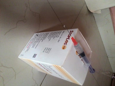

Take the syringe and fill it with pond water (To see aquatic creatures in micro-level) then place it on a stand or on top of a box.

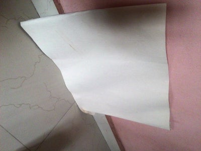

Wrap the chart paper around a cardboard to make a screen.
Place the screen about 1 meter from the syringe arrangement.

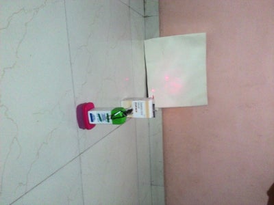

With the help of clip hold the button of key-chain laser in ON position.
Secure the laser setup with the help of a stand or a box.
Place this setup 2 feet away from the syringe arrangement.
Step 3: Setting Up...!
Setting Up...!
Now we have arranged everything let's put the things into action.

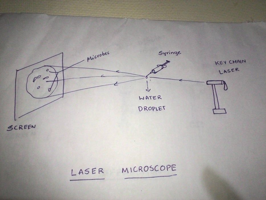

Gently press the syringe piston such a way that water droplet should come at the end of the needle. This is the main part of our microscope i.e Convex lens. Yes, water droplet acts as a convex lens.
Focus the laser beam such that it should point the water droplet. Due to refraction from the water lens, it projects the laser light directly on the screen. This will form a red patch on the screen.

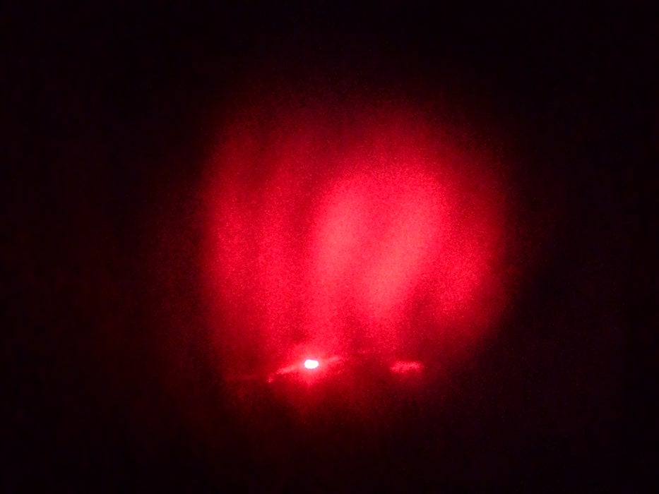

Turn off the light and see the nice view of the microbes. You can use this experimental setup to check the purity of drinking water, boiled water etc.
Now you can observe microbes, bacteria etc. roaming around the tiny droplet of water.

    balearicdynamics over 6 years ago +2
    Maybe a video may help. Anyway, the proof of concept is interesting, but I think it is more probable you see the diffraction of the microbes instead of the cells themselves. The reason that probably you…
