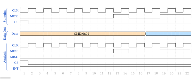

What took me hours of typing and days of checking simulation in MPLABX, took about an hour all together to do in PYNQ. Now that's productivity. I initially wanted to replicate Analog Discovery real-time logic analyzer on PYNQ, but after looking into the API of logictools and its source code, realized it would not be possible to do live display with the methods available in the tools so far. As it was not crucial to the task at hand, simply running the sequence of writing and reading bytes was sufficient for me to check what is wrong with the PCB. Writing out logic for initialization of the CAN controller in PYNQ took 40 lines instead of 1000 in Assembly!!!

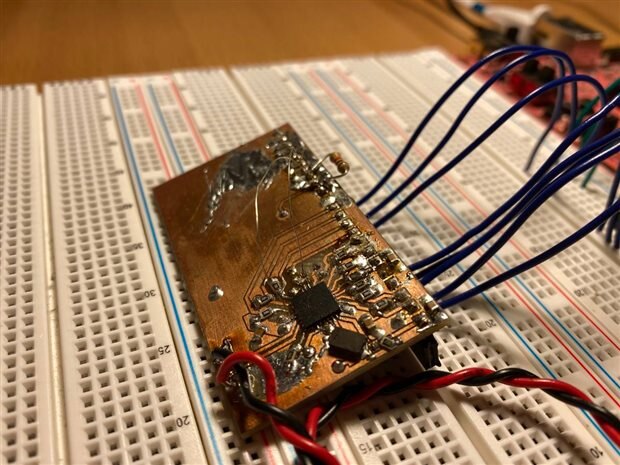

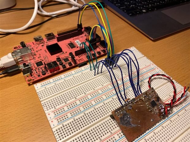

The CAN board was intended for use with a 5V IO of a PIC18 so I had to do some "modifications" to the board so the ZYNQ 7020 does not get mad at me and decides to stop working, which all in all looks more like savagery now. I cut power traces to the logic part of the CAN unit and connected them to an unused header pin using a bare copper wire strand (barely visible on the picture) salvaged from a 24AWG multicore wire along with adding a pull-up for a RST pin.
After thorough checking for shorts, the board was connected and the register initialization was carried out. Sweet! the INT line is pulled high and the board waits to be initialized, PYNQ-Z2 is now sending the sequence of commands, addresses and data bytes to set everything up.
However, having sent the setup bytes, the last transaction read the bytes from the control register on MISO line, which were all 0's indicating the board was not configured. That immediately rose question and I tried sending "SPI" data in mode 1,1 (3) instead of 0,0 (0), which the MCP25625 claims to support both. And what do you know, at the end of the transaction I get the expected 0x40, indicating the CAN controller is in loopback and was configured.
