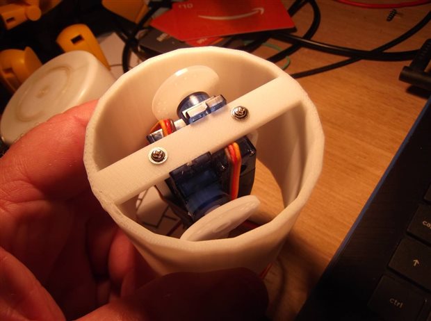

It is now over half way through the 24 hours for my Tiny Mobile Robot and I have a sort of working prototype.
I 3D printed a cylinder slightly wider than the widest part of the two motors which also had a mounting bar at the bottom. I very carefully used self-tapping screws to fix the motor unit to the mounting bar. It is stable but could easily break if knocked - so hopefully I will not knock it. I have programmed the Arduino Nano to simply move both wheels together so that the whole mobile robot moves backwards and forwards in a straight line as I need repeatability while I stuff everything inside the cylinder. As it is a mobile robot it needed to have some sort of sensor and as I had a HC-SR04 ultrasonic distance sensor I decided to use that. The HC-SR04 is a simple to use sensor as all you need to do is to add power, a trigger signal of at least 10 microseconds length and then measure the length in time of the echo pulse detected. Dividing the length of the detected echo by 58 converts time into distance in centimetres. At the moment it is not making use of the data from the sensor but it is all working, see below:
There is a great deal of wheel slip as the batteries are quite heavy and it really needs elastic bands for tyres, but unfortunately I do not have any. I will see about using AAA instead of AA batteries later and see about fitting everything into the cylinder. I have also 3D printed a top for the cylinder so that I should be able to mount the ultrasonic rangefinder to that. I don't think it is going to look as good as I had hoped, nor is it going to be as tiny as I originally planned. Maybe I should call it the not quite so tiny mobile robot.
Well, it is late now so I'm going to bed soon. There is still time for a couple of hours work tomorrow morning before my 24 hours is up.
Dubbie

    Yes I do like the smaller robots, more manageable at home. I do sort of enjoy the difficulties that trying to go small introduce as well, which are really not that related to functionality. The effort involved in design and construction seems to increase exponentially once a certain smallness is reached. I was surprised by how large my body shell had to be made just because the wheels had to be so large due to the distance from the motor axle to the edge of the motor body. It would probably be a lot easier if the motors could have a gearbox that brought out the wheel axle at 90 degrees to the motor axis.

    I did think about O rings, a lot, but mainly in frustration as I don't have any. I think they might be something I might need to buy. I would then have to work out how to design the wheels in TinkerCAD to make the grove for them to fit into. I'm not sure how difficult that might be.
