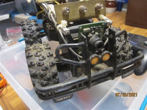

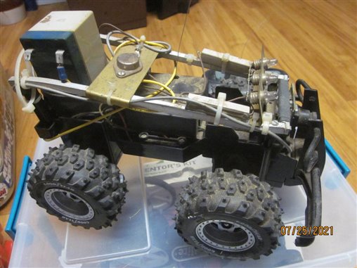

I rescued the RC car and checked out the previous hack. The RC car was used to inspect attics and crawl spaces.

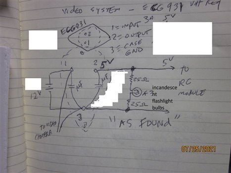

An analog video camera was mounted on car front, a  phono jack was soldered to the back for the banana plug connection.
3 flashlight bulbs with 20W dropping resistors all in series were the camera's light source. An aluminum frame was made for mounting components.
A  relatively heavy 12V 1200mA hr lead acid battery sat in the rear.
The TO3 transistor mounted on a brass plate on top, was a 5V voltage regulator. The 12V was for the camera, the 5V was hacked into the RC control for  power.
The original battery was a 4.8 v NiCad which was unused. The owner must have not had a NiCad charger. The car body is missing. This guy may have gotten this RC, as is,  at a yardsale as well.

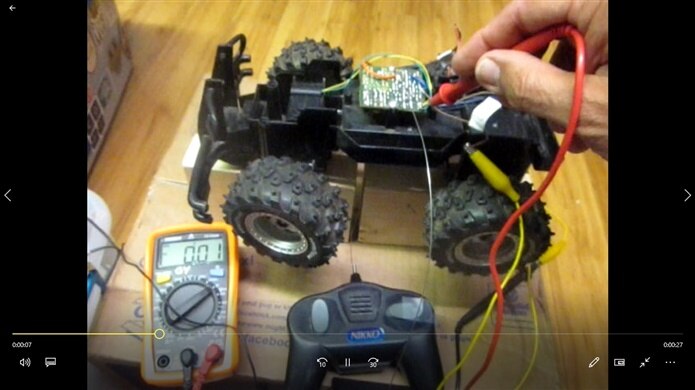

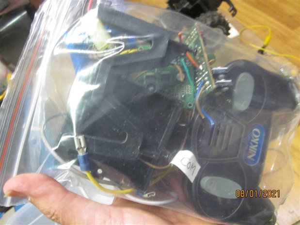

Stripping out the previous hack, a thorough cleanup, recharge the original NiCad battery and hooked up the power circuit.
The car actually works again with the original 49MHz RC controller. Here is a screen shot of the videos where the motor and steering voltages are checked.
There is no variable voltage control on the drive motors.

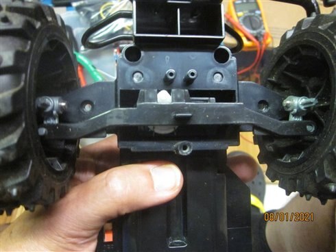

The steering control has 2 wires, 5V on the yellow wire and COM to the green steers full left, 5V on the green wire and COM to the yellow steers full right.

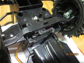

The steering mechanism has a circular motion, with a pin that loosely fits into the steering tie bar. The pin is spring loaded. Later in this project report is a link that shows the whole teardown and refit.
Recycle  - Keep disassembled parts gathered up together in case you need them later or to reuse the leftovers in another project.

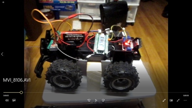

The car chassis was used for the base, keeping the rear drive motor, axle and wheels.
The rear DC motor leads were snipped from the old controller, and the car controller removed.

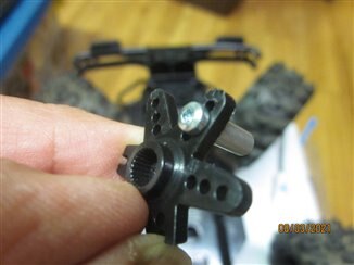

The steering mechanisms were kept with the exception of the steeringbox gearmotor. It was entirely replaced with a standard 180 degree metal gear servo.

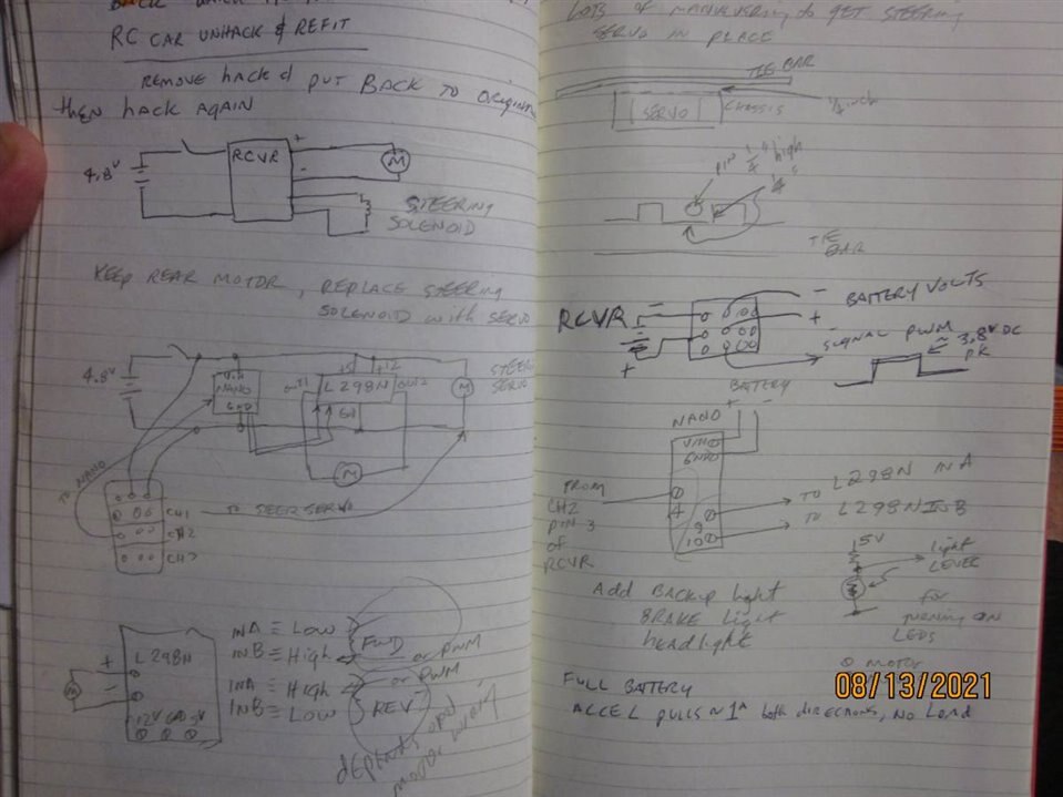

  1. Define your plan on what you want to accomplish or create
  2. measure - measure voltages under different running conditions, take photos and videos of how the toy works now, make sketches, reverse engineer everything you deem important
  3. analyze - plan how you can make your design come to life. try it out with mockups
  4. improve - the hack you did may not have worked right, time to improve - hopefully your hack is better than the original !
You may need to bounce back between steps 3 & 4 alot :-)   keep testing and retesting, fitting and refitting parts as you go
in this case the steering mechanical linkage was the most difficult & time consuming part. It took 4 iterations to find the right parts for the best robust solution tuse with the new steering servo.

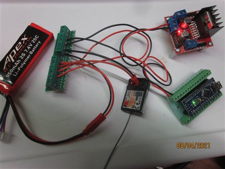

These are the new electrical parts. I always need at least one power distribution terminal board card in my projects., often several.
Electrical parts laid out                                                                            RC car refit with new RC controls and a new steering servo

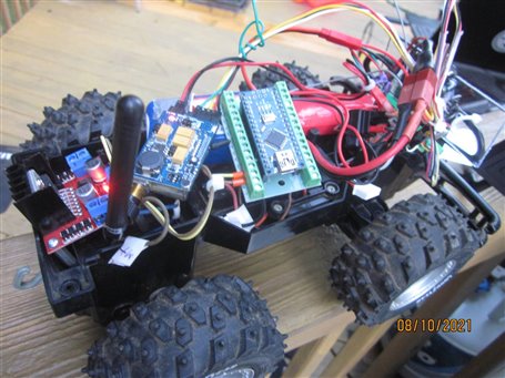

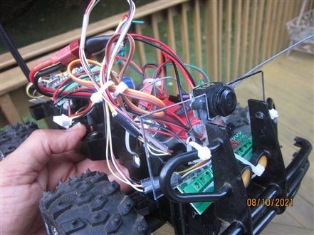

The RC car refit with new RC controls and a wireless FPV camera system installed as well.
RC car wiring schematics
THEN because the original hack had installed a video camera, an FPV (first person view) video camera was added and mounted with its 200 mW 5.8 GHz and wired back into a Windows PC to record videos from the RC cars point of view.

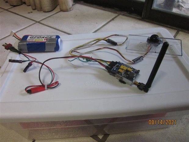

details on the wireless video system
I like to have a modular FPV camera and transmitter. At a moments notice the camera system can be popped off one robot vehicle or RC car, and effortlessly popped onto another.
The 5.8 GHz system shown here is getting on age, now integrated cameras and transmitters can be purchased.  The transmitter came with harnesses that matched up to the camera, and another for the battery, I just built an adapter to fit the different styles of battery connectors.

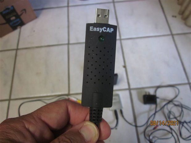

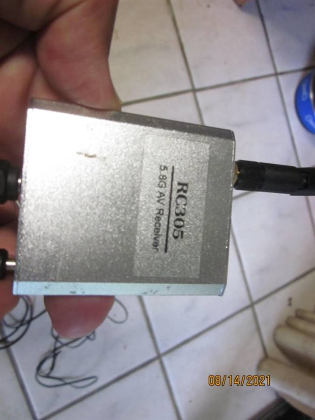

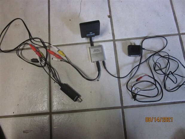

The receiver side into the PC consists of a video to USB converter, the 5.8 GHz receiver , a 5V power supply, and an antenna ( the antenna that comes with it is crappy)
This EASYCAP USB device converts the analog audio & video for bringing into the PC.
