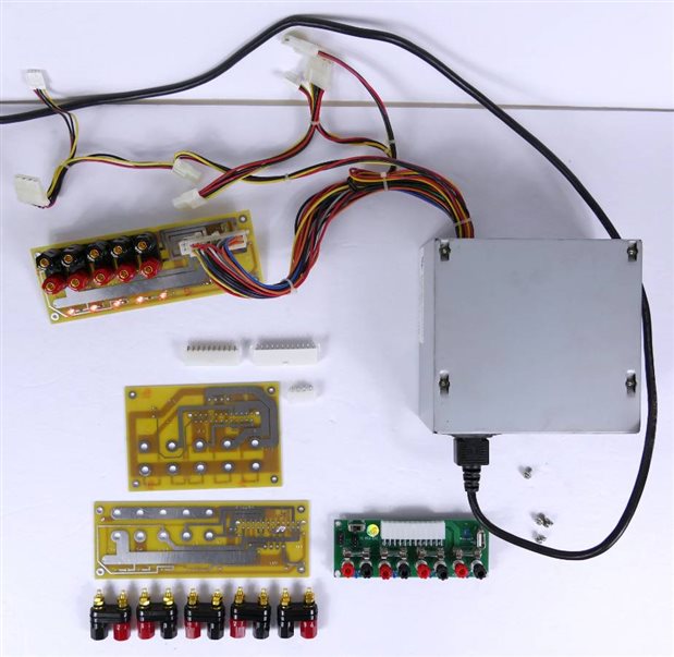

I have a collection of old PCs from various scavenging activities. Somehow I just couldn't seem to pass up opportunities to acquire "free" PCs. They are probably all working, but I don't actually have a use for them as computers. I have "intended" for a long time to scavenge whatever might be repurposed off some of these computers - disk drives, power supplies, heat sinks, etc. But even for those items, I don't have a pressing need. I did make several attempts to design a conversion to create a bench power supply from the PC power supplies, because in the past I always seemed to need more power supplies, and they can be pretty expensive to buy.
I bought connectors and binding posts and even designed a couple of versions of PCB to get started. However I always stalled when trying to come up with a reasonable (cheap) way to package the bench supply. This Projec14 Upcycling theme is a good excuse to finally put a complete supply together.

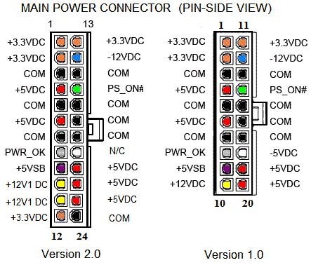

These old PC power supplies have a bunch of output power connectors and the main connector comes in a couple of variants.
Note that the V2 connectors have all the same pins in the same places as the V1 connector so they are backward compatible, except the V2 power supplies are less likely to have a -5 V output.
Additionally, some of these power supplies need a load before they will regulate properly. The supply in the picture below is like this so I have provision for a load resistor on my PCBs.
I bought both types of connector, just in case, but the bigger one will always work, if plugged in at the right end.
I also bought a cheap commercial version (also shown in the picture below - the green card), but its tiny binding posts are at a non-standard spacing and cannot accommodate banana plugs.
Note that this particular power supply uses a V1 connector and it has a -5V output. (The LEDs from left to right indicate +12, +5, + 3.3, -12, -5)
The larger card (that is powered up in the above picture) was the first one I designed - when I had a different idea about how to package it.
The smaller card takes no more room than the power supply front face, so this is what I used in the build.
The supply I used in the build (different from the one pictured above) has a V2 connector and it does not need load resistors to regulate properly, but it has no -5 output.
