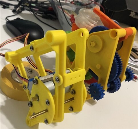

I have spent a fair amount of time and energy in building the new internal skeleton that will hold all of Mr. Machine's internals.  I have captured (to the best of my abilities) the measurements of the old internal gear cage, in order to design the new skeleton.  Here are some side by side images:
On one side of the cage/skeleton, there are three bosses that position the assembly into the plastic skin.  On the other side there is a single boss and and a small pin to align the cage/skeleton.  I have tried to match the color scheme and printed all of the components out of yellow PLA.  Here is a clearer picture of the new stepper motors installed into the cage/skeleton:
The new cage is built from two frame halves (pseudo mirror images, with different boss mounts), held together with three spaces (which will be used to mount the custom electronics).  There are a pair (mirror images) of motor mounts that bolt onto the each of the two frame halves.  A stationary shaft passes between the two motor mounts which will allow the drive gears to engage the transfer gears attached to the outer plastic skins.  I had a bit of an issue with the cage/skeleton distorting (racking of the two parallel frame halves) so I added a pair of hex standoffs which are joined with a short section of threaded rod (cut off screw) with some locking nuts.
Here are some of the new skeleton parts (Fusion360):
Here are some images of everything assembled and placed inside the skins.
Everything fits fairly well.  I am currently re-printing all of the gears (shown in clear/white).  And here is a short video of the wheel being driven!

    There was nothing electrical in the original Mr. Machine. It was a windup toy. Over the years the spring in these toys have gotten pretty weak. In addition, the internal gear cages warped and sprung out…

    There was nothing electrical in the original Mr. Machine.  It was a windup toy.  Over the years the spring in these toys have gotten pretty weak.  In addition, the internal gear cages warped and sprung out near the winder axle due to some compression springs.  The end result is that the gears get tweaked and freeze up.  The one toy that I have that still works is very weak and prone to stopping until it gets a little push.  (I will need to post a video at some point).  I could have designed a single board, but I wanted to illuminate the inside from multiple points (the reason for the 8 RGB LEDs distributed across the three boards).
    Two of the boards will be mounted on the skeleton/cage, with the third board (battery pack) mounted below the old winder key (micro switch will detect the cam lobes).
    The whole exercise is a bit of an excess, but I think that is why is is so fun.
