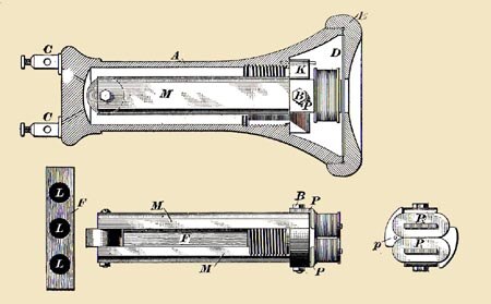

Convert early 1900's crank wall phone to a voice activated assistant.
The phone is called "the cathedral top and picture-frame type wall phone" because of the shape of the top and the rectangular groove in front of the box. The small black cylinder at the center of the top was a lightning arrestor. When the line was struck by lightning, this would divert the high voltage to a wire connected to the ground, protecting other wires and coils in the telephone from being burned by the excessive current.

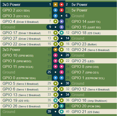

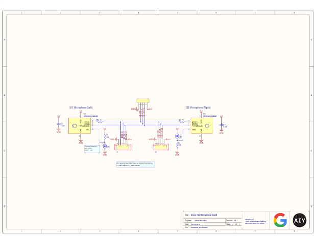

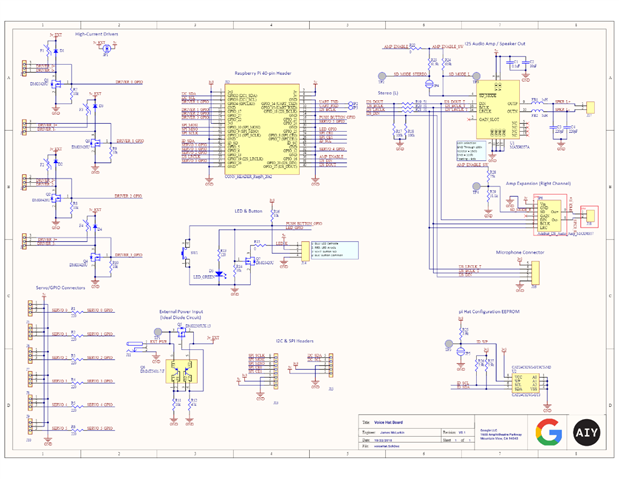

Google Voice AIY V1 Schematic
Microphone Board (due to size it will need to be modified to fit in the voice transmitter)
