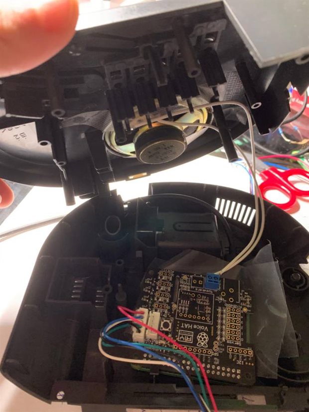

Ralph, you were right! Just finished the major portion for this.
3A+(sorry Tariq but space was limited)
This also has one of those AIY hats.
The AIY hat is basically just an audio amp, mic breakout, and servo drivers.
Suits me.

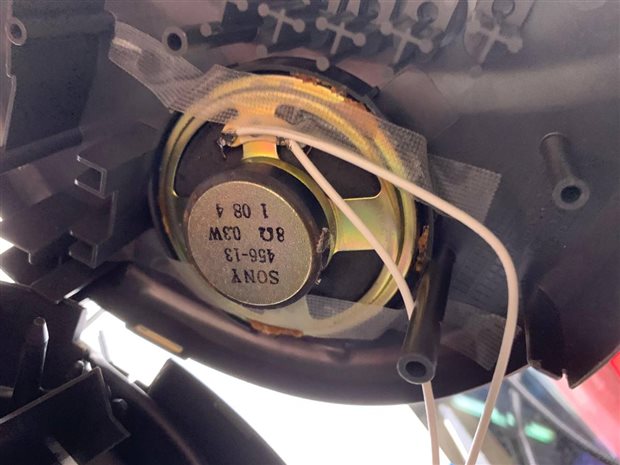

The original speaker's wires are too old and I decided to swap them for new ones. Hi-quality 22AWG, here we come!
Soldered on some new wire, and it's as good as new.
The sound quality isn't the best, but it IS over a decade old.
Trust me- it really is the original speaker.

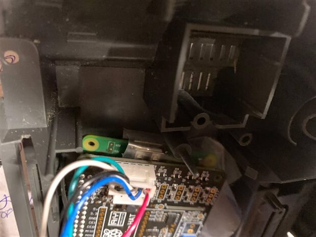

Look how much it fits to the original chassis. Had to tape it on since I couldn't find my glue gun.
And lastly a poorly shot image
That plastic, is to prevent the terminal block leads from touching the HDMI port which causes a short circuit which isn't fatal but make a buzzing noise.
