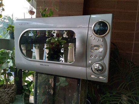

Virucidal means - having the capacity to or tending to destroy or inactivate viruses. In this project, I am using an out of order old microwave oven to make a very simple DIY ‘disinfector’ device to destroy or inactivate viruses, intended mostly for the CORONA virus. The main weapon is the UVC germicidal light which is used instead of the Magnetron of the Microwave Oven.

I used my old microwave oven which has a burned out magnetron. It was from a local brand ‘RANGS’. They are the official dealer of SONY in Bangladesh. The build quality of the microwave oven is superb. I just placed a germicidal UVC light from PHILIPS at the terminals of the magnetron.

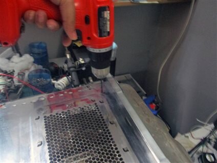

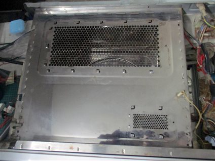

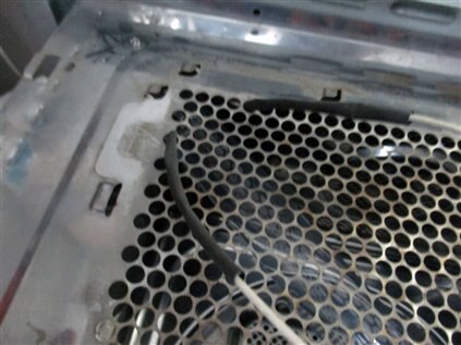

Step01- I removed the magnetron and other unnecessary parts from the chassis. I removed the top cover and drilled two holes to mount the T8 tube holders.

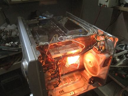

Step02- I placed the wires with heat shrink tubes. Because the insulation of the wires can be degraded due to UVC exposure for a long time. However, the tube holders are also made of plastic, but the intensity of the UVC light is almost nill at the edges. It is highest at the middle for the lamp tube.

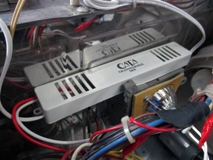

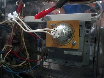

Step03- I connected a driver for the UVC lamp at the terminals of the magnetron. I had to drill some holes and placed connectors for a neat assembly of the cables. The general purpose bulb was missing!! I can’t remember where it had gone. So, I had to mount another bulb separately so that I can see the internal staffs while it’s operating.

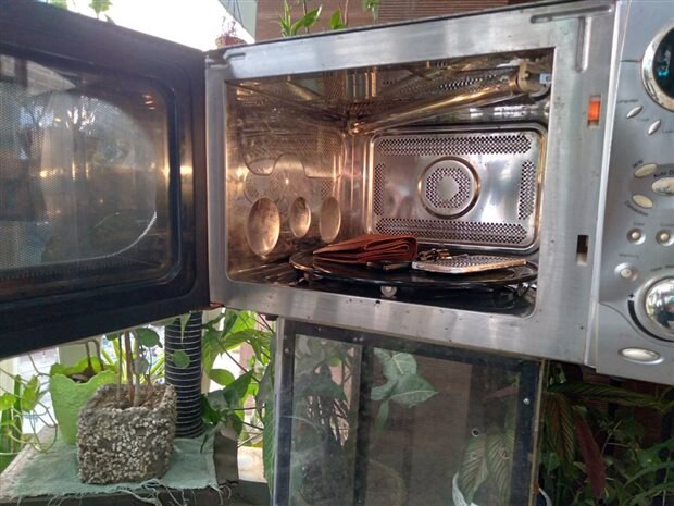

Interior:
{gallery} Interior setup

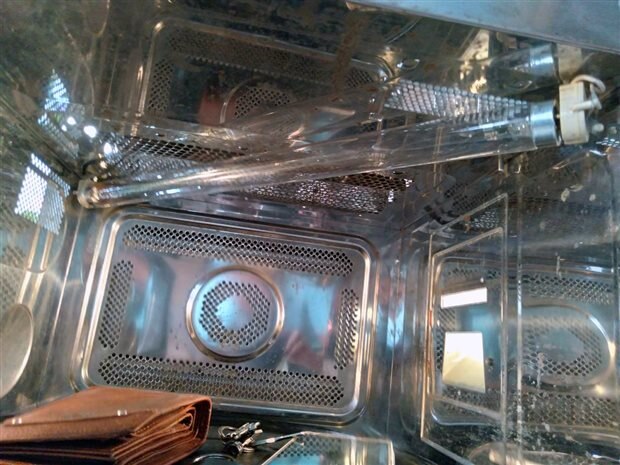

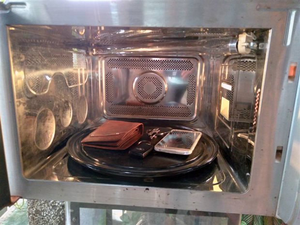

Internal SS body: UVC exposure degrades plastic and even paints. It was an advantage for me that the body of the oven is made of bare SS.

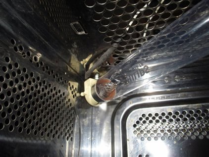

UVC lamp: Philips TUV 15W 258nm germicidal T8 tube provides the required UVC light for disinfection
Turntable: Turntable provides a better UVC light distribution

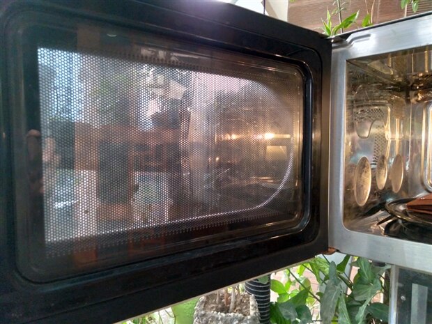

Front door: The glass of the front door gives visibility but blocks the UVC light to come out during operation. Safety lock turns off the UVC lamp automatically when the door is opened.

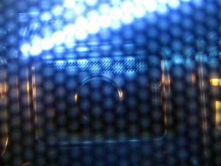

Just like a traditional microwave oven, the exposure time can be varied accordingly. However, other options are disabled and there is no control over the power or intensity of the exposure. Once the door is locked and time is fixed, the UVC lamp turns on with pressing the start button. A fading blue light is visible from outside through the glass front door.
There are two limitations of this simple design. The UVC is exposed only from the top. Several other lamps can be placed on the side walls too to overcome this limitation.
The turntable side does not get any exposure, as UVC does not reflects back from the metal body with much energy. So, the stuffs placed inside need to be flipped manually after the first session of exposure.

    Working with UVC light is not safe. That's why I used the microwave oven chassis which has a metal [SS] body and the glass front door has safety lock mechanism. Glass does not allow UVC to pass through. Only UVA can pass and the lamp produce mostly ~258nm [UVC] wavelength output. It produces very low energy at UVA band and that also gets blocked partially by the glass. Normal glass (as used in windows) is transparent [almost 70%] to UV radiation to a wavelength of about 330 nm (UV-A). Below 330 nm (UV-B and UV-C), almost 100% is blocked by normal glass."
    link: https://www.iuva.org/UV-FAQs
    Therefore, i thought that the glass will be safe enough. However, the blue light that we see from outside is within the visible rage and it is not harmful i believe.
