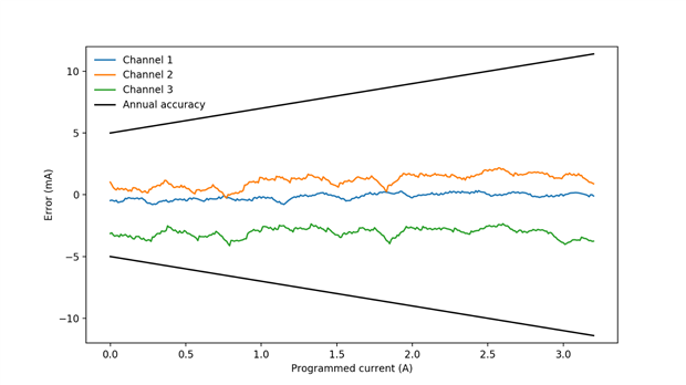

Accuracy was measured by performing full voltage and current sweeps at each channel with a 1 s delay at each sweep step and measurement. 0.1 V steps were used in the voltage sweep, and 0.01 A steps in the current sweep. The following table shows the obtained results:
Pre-cal      V-DAC      V-ADC       I-DAC      I-ADC
Channel 1:   ±12.8 mV    ±8.1 mV    ±0.8 mA    ±1.5 mA
Channel 2:   ±12.4 mV   ±10.4 mV    ±2.2 mA    ±2.0 mA
Channel 3:    ±4.6 mV    ±2.5 mV    ±4.1 mA    ±3.6 mA
The following 2 figures show the programmed and readback voltage and current errors:
Figure 4: Programmed voltage and readback voltage error plots.
Figure 5: Programmed voltage and readback current error plots.
Everything looked fine, with the exception of the channel 2 readback voltage, which at 0 V gets slightly out off spec. The reason that it gets out of spec is that when the PSU is programmed to output 0 V, it actually outputs ~-8 mV, which is then read back as a clamped 0 V. A similar situation occurs with channel 3 in the readback current plot, but it does not get out of spec there.

Post-calibration accuracy
After performing a full calibration its time to compare the pre-calibration with the post-calibration results:
Post-cal      V-DAC      V-ADC      I-DAC      I-ADC
Channel 1:    ±2.3 mV    ±0.5 mV    ±1.8 mA    ±1.0 mA
Channel 2:    ±4.2 mV    ±0.7 mV    ±1.4 mA    ±0.4 mA
Channel 3:    ±0.8 mV    ±0.4 mV    ±0.7 mA    ±0.4 mA

Figure 9: Pre- and post-calibration programmed current error plots.
Figure 10: Pre- and post-calibration readback current error plots.
The post-calibration accuracy increased in all cases except one: the programmed current for channel 1, which I suspect was caused by temperature variations. I found the programmmd current calibration/measurement to be quite tricky because heating of the PSU affects the current output. And since PSU temperature varies quite a bit during normal operation, how close the output is to the programmed values varies during the operation of the instrument. For example if all of a sudden a lot of current is sourced, it will take probably a few minutes for the PSU output to stabilize.
