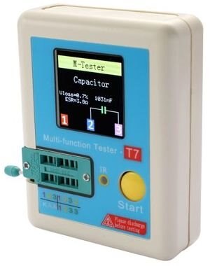

Hello, my name is Doug and I'm a gadgetaholic, and the gadget in the 2nd picture below really tickles my fancy.

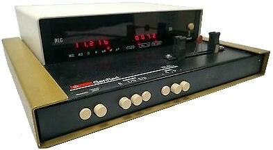

This blog is about a quest I have been on for several decades. It starts back when I was a student …. my best summer job was in an electronics lab where I had all sorts of miscellaneous tasks that taught me a lot that I didn't know, and a lot that I would never learn in my engineering courses. One of the things I did was simply sorting components, which seems pretty menial, but I actually learned a lot from doing it, and it is why I can read colour code values at a glance without thinking or calculating. That lab had a General Radio LCR meter that I found intriguing and extremely useful for several of the tasks I had.
Ever since then I have had a disproportionately high desire (relative to actual need) to own a nice RLC meter, but they always seemed too expensive for me to justify purchasing. I still don't have a dedicated one like the GenRad, although I have collected a bunch of meters that more or less cover the functionality of an RLC meter.
My latest instrument is a bit more of a novelty than a serious meter, but nonetheless it is very cool because it is deceptively smart and very versatile. I like having it more because it is cool than any high performance capability.
Here it is – the T7 Multitester. These instruments are quite fragile, both mechanically and electrically. This blog explains a few things I have done to improve the device and fix some of the issues.
Issues
  • The first issue is the USB charging port is recessed behind a thick plastic panel which barely allows the USB charging connector to make contact. It can make contact, but the connector falls out if you just look at it sideways. I designed a 3D printed replacement panel with a pocket around the USB port that allows the connector overmold to go into the panel far enough to properly seat the connector.
  • The second issue is that the device doesn't really turn off, it just goes into a sleep mode, so it continues to drain the battery when it is off.
  • A third issue that I've seen others have, is that the internal MCU can crash and there is no way to reset it.
Both of these issues can be solved by adding a power switch that disconnects the battery when the instrument is not in use. There is lots of room to add a switch to the top panel, so I designed a 2 part panel that locks the switch in place without any fasteners.
  • A fourth issue I discovered after taking the case apart is that the bosses for mounting the PCB do not extend all the way to the PCB, so if the screws are tightened, even minimally, the PCB will have to bend. I solved this by 3D printing some stand-off spacers and dowels.
In all, I used eleven 3D printed parts, a slide switch and some hookup wire to eliminate all the issues outlined above. However the parts are small so they print quickly.
It still isn't a robust, high-accuracy instrument, but like I mentioned, something about it really tickles my fancy and I like it even more now that I have made some improvements.

    dougw over 6 years ago in reply to genebren +5
    You are correct, the switch disconnects the battery, so it needs to be on to charge. I will attach the stl files in case anyone wants to try the same mods.

    I have several of these devices branded as M-Testers. I have purchased raw units for a few bucks from Banggood and put them in my own boxes. These were designed to run on a 9 volt battery but I wanted a longer use so for the two that I built my own cases I put AA batteries into the system. I have well over a year of use in both of the units and they still show 8.9V or more of battery voltage. On one unit I added wires and alligator clips as they are useful sometimes. I also moved the test socket off the board and onto the panel as I found that it was difficult to get the lock bard to work through the panel if it was mounted on the original board. The smaller one came with its own laser cut Plexiglas case and I had to stay with the original 9 volt battery. I have always found them accurate enough for my purposes and handy to help ID transistor leads and transistor types. The only problem I have had is that some of them were assembled with the socket lock bar closed. This causes the fingers to be held in a bad position by the solder. To fix this problem I had to open the lock bar and liquefy the solder long enough for the fingers to resume their proper position.
    Thanks for your interesting post and modifications. It seems that I am not the only one who likes to modify commercial products to better suit ones preferences.
