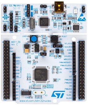

  • The carrier module in turn plugs onto an arduino compatible shield, which in turn plugs onto an STM32F411RE MCU.imageimage

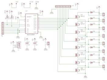

There are 8 aquarium pumps which each have a motor. I have designed a PCB with a port expander and 8 large FETs to drive these pumps.imageimage

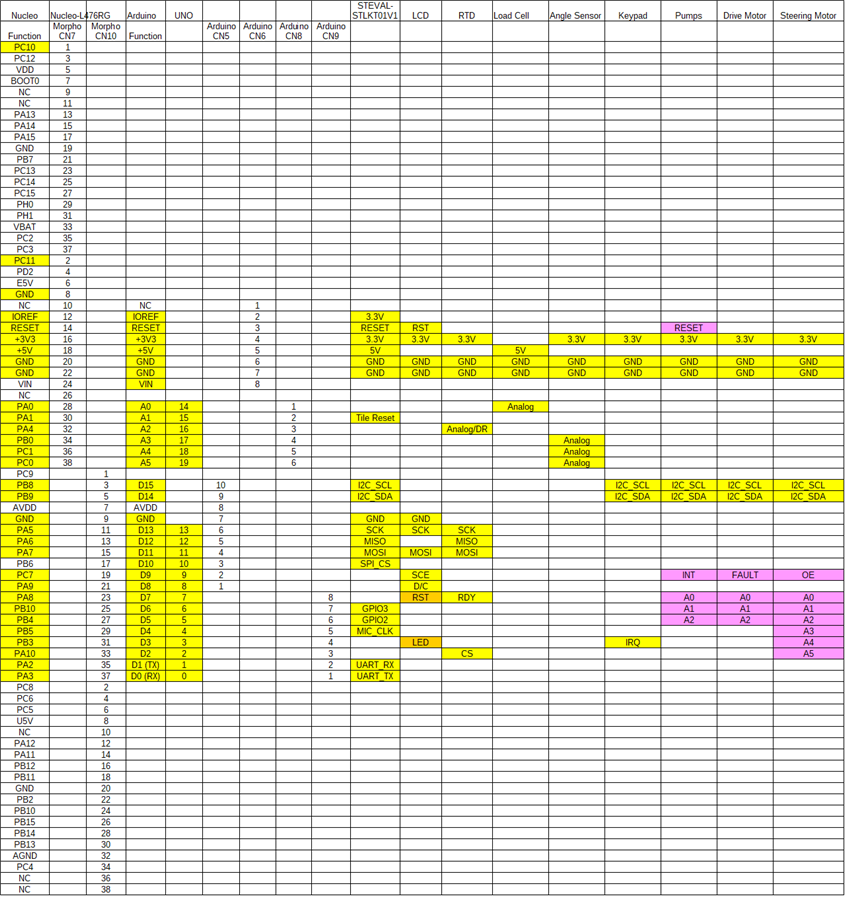

The MCU needs to talk to 41 devices which ends up to be a large number of interfaces for an MCU to handle. The sensor tile shield leaves just enough pins to connect the LCD and the analog sensors. There are not enough pins to control the motors or read the temperature sensor so I have had to try and control all the motors and read the RTD through the I2C interface. There aren't any pins left for control switches, so I had to add an I2C keypad.image
I have started design of a PCB to connect all of the sensors, motors and peripherals to the MCU but I'm still struggling to find pins. Although I'm using I2C for most of the interfaces, it often requires an extra pin to tell the MCU its status. It is going to take some time to dive into the detailed handshaking requirements of every peripheral and devise ways to implement adequate interfaces.
Here is where my pin mapping stands right now....the conflicts are tentatively resolved...
